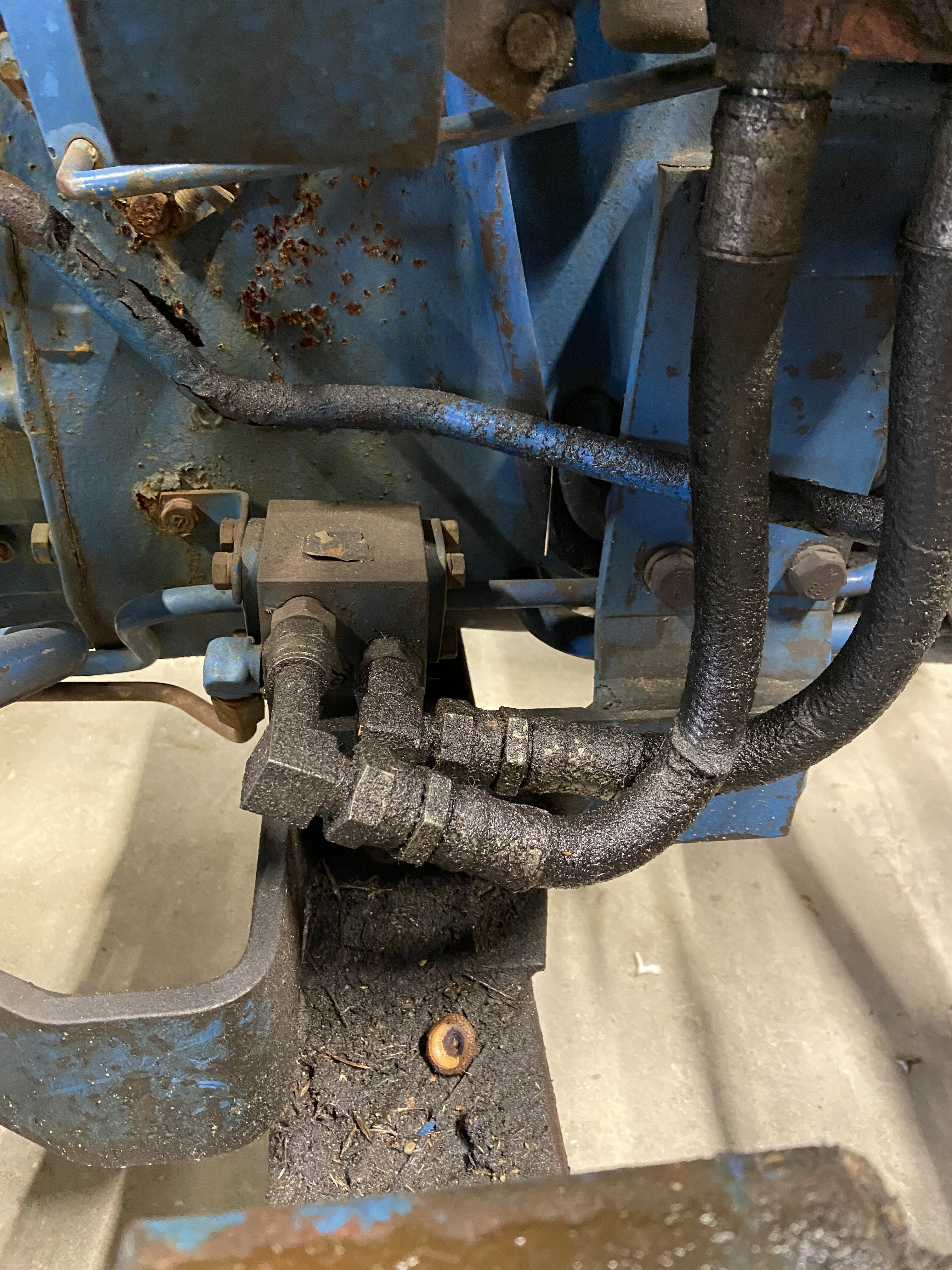

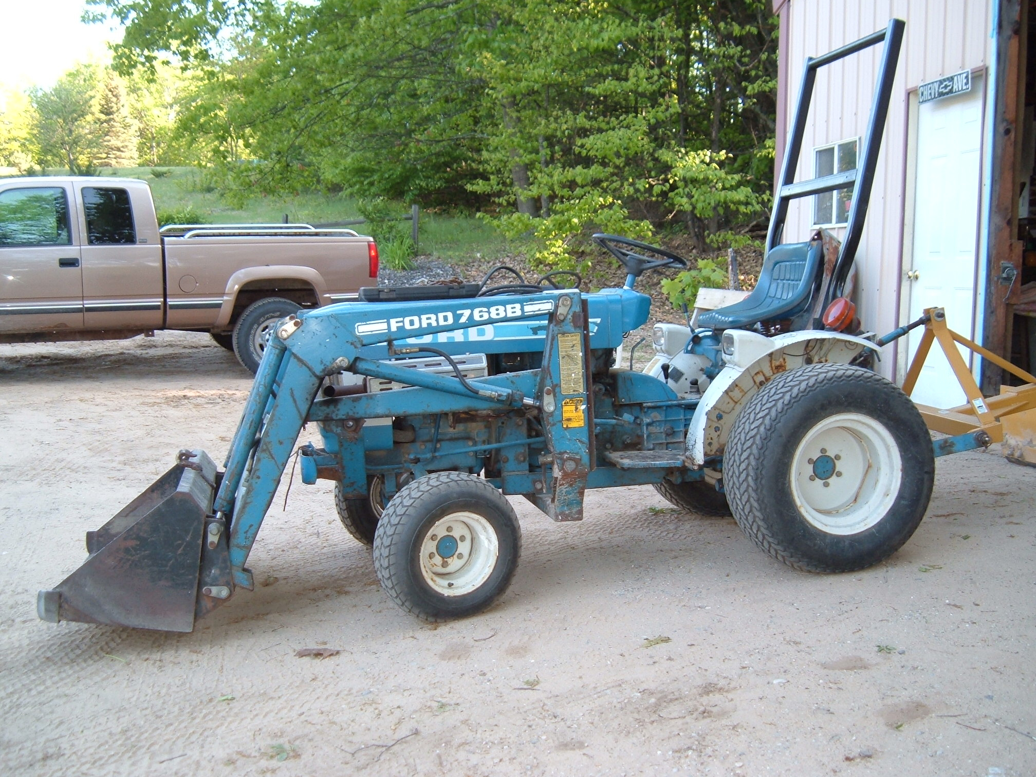

   / Ford 1210 diesel #6
Hi man I have a ford deiseal 1210 , I want to put a loader on mine , do you have any pictures of where the hoses are attached to ? I have the Manuel I can send you a copy of it . Where do I attaches the hoses , it is the hydraulic manifold block near the breaks ? Any picture would help thank you
   / Ford 1210 diesel #7
I don't know why the oil is black If you changed the oil it should be fine just change the filter , it should be fine
   / Ford 1210 diesel #9
hansan, I have a 1210 with a loader. I'll try to include pictures.
If you need more pictures, I can take any you might need.
