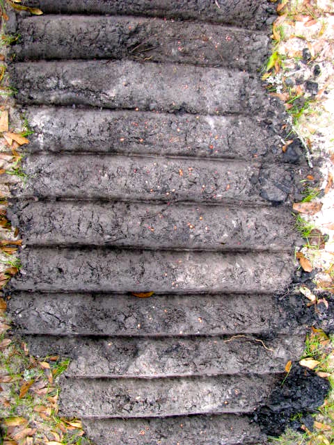

A cultipacker next will be best but not a have too.
If you have some high dollar clover or brassicas out there then I would lean towards cultipacker being a better bet than not using one. For cereal grains that are cheaper and higher seed rate just sow them a little thicker drag them under and be done with it.

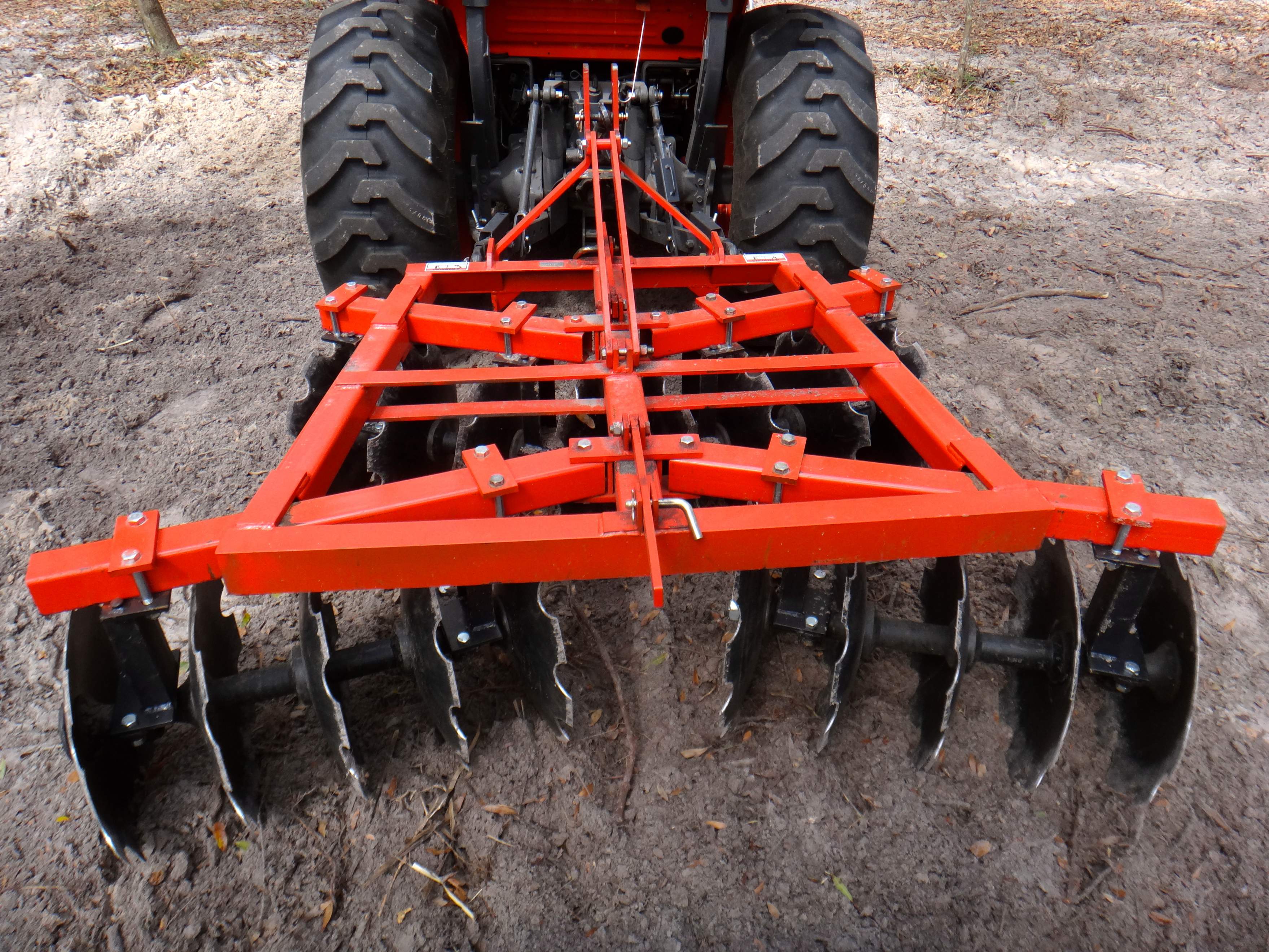

A conventional disk harrow would be better, it will ride up and over the stumps.

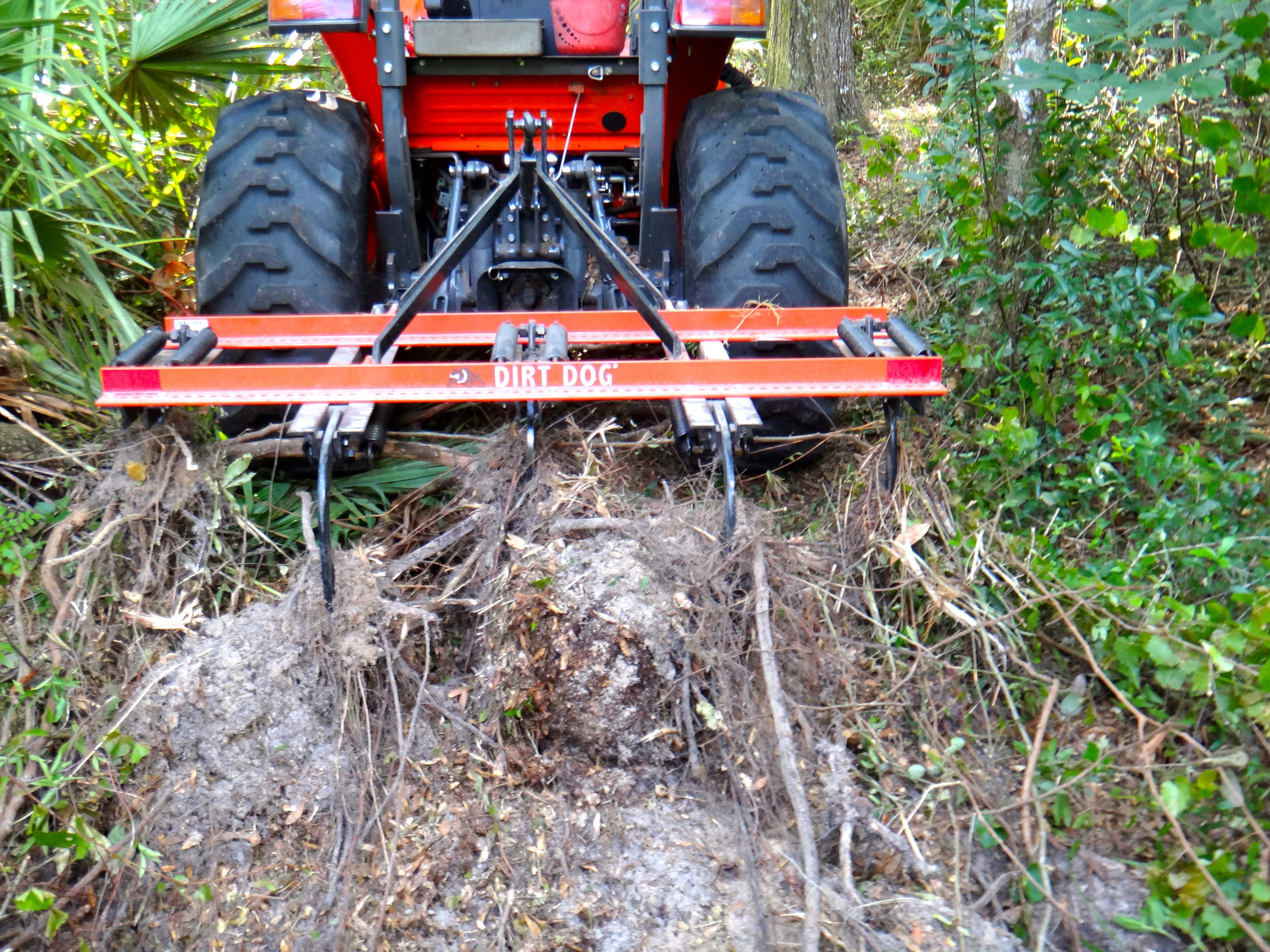

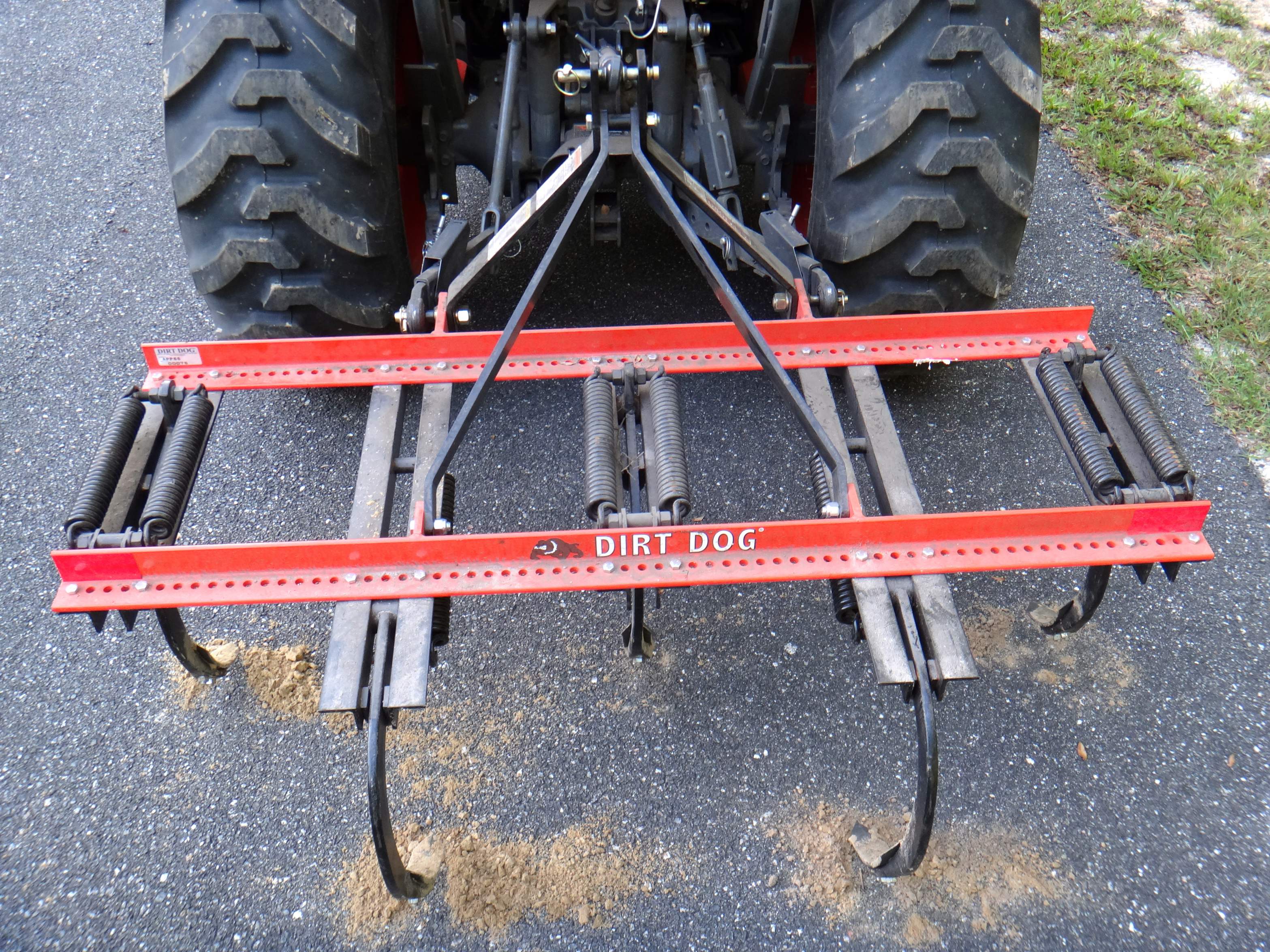

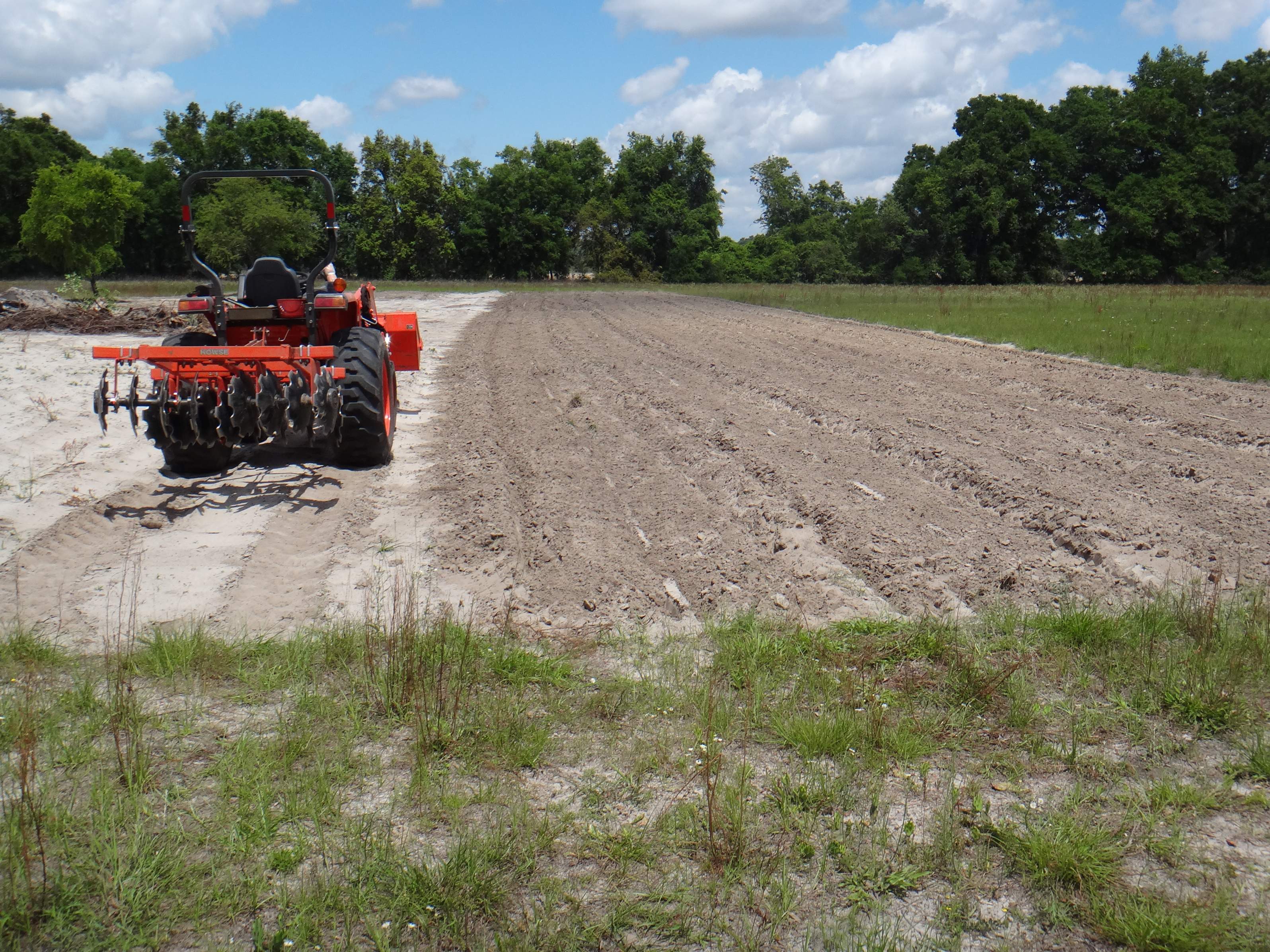

I have both a Dirt Dog All Purpose Plow/Field Cultivator and a heavy Monroe Tufline Disc Harrow. Behind a powerful tractor you are less likely to damage the Disc Harrow.

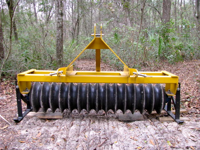

If I lived in North Carolina I would consider a Cultipacker and a Disc Harrow from everythingattachments.com
I have an ETA Cultipacker; there is nothing sophisticated about this implement from any supplier. ETA's Cultipacker is fine.
Food plot seeds are strong germinators. The ground does not require fine preparation. A soil test is advised for optimum germination rates.

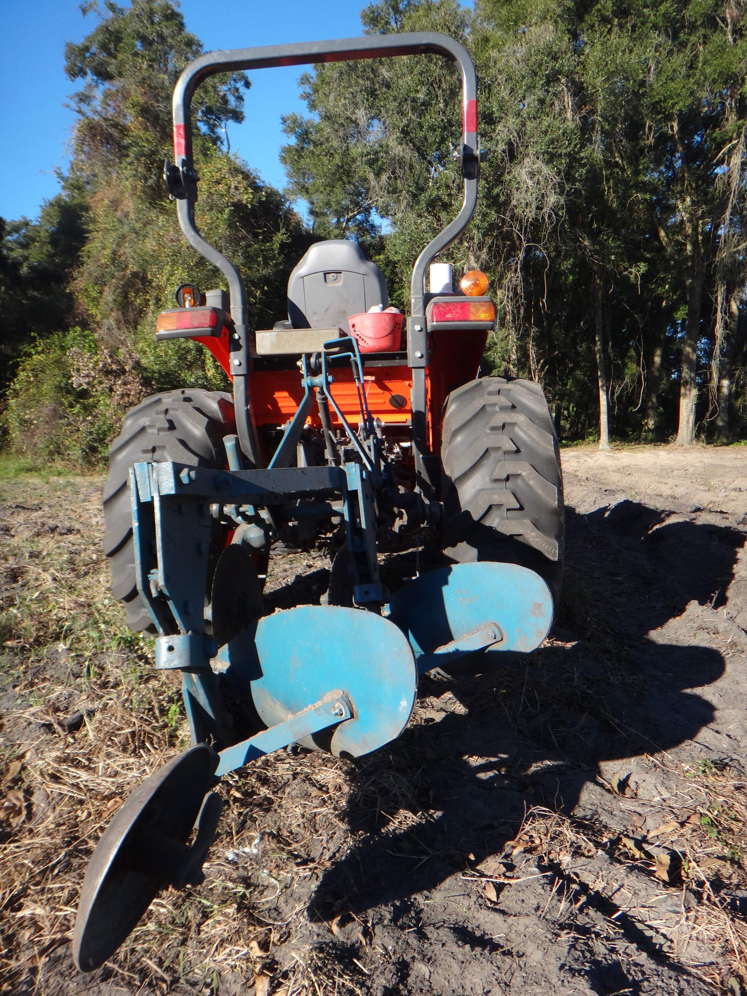

A Chisel Plow is a heavy duty Field Cultivator, more or less. It is a conservation plow. Not best for clay.
In most parts of North Carolina a moldboard (turning) plow would be used to "break" soil/sod mixture the first time, then a heavy Disc Harrow would be used for secondary tillage, with winter in between the two stages. Late winter/spring freeze thaw cycles help to break up clay. Disc Harrow reduces clods further. Disc Harrow with 9" pan spacing better for cutting. Disc Harrow with 7" spacing better for smoothing. For food plots, 9" spacing. This for commercial crops. Not required for food plots.
If field is tilled with a HEAVY Disc Harrow twice per year it may only require plowing once. In Florida, where two crops are normal and some get three crops of hay, Disc Harrows with 22" - 24" -26" pan diameter are the norm. Turning plows are around but seldom seen working. NOTE: Most of Florida has sandy-loam.
