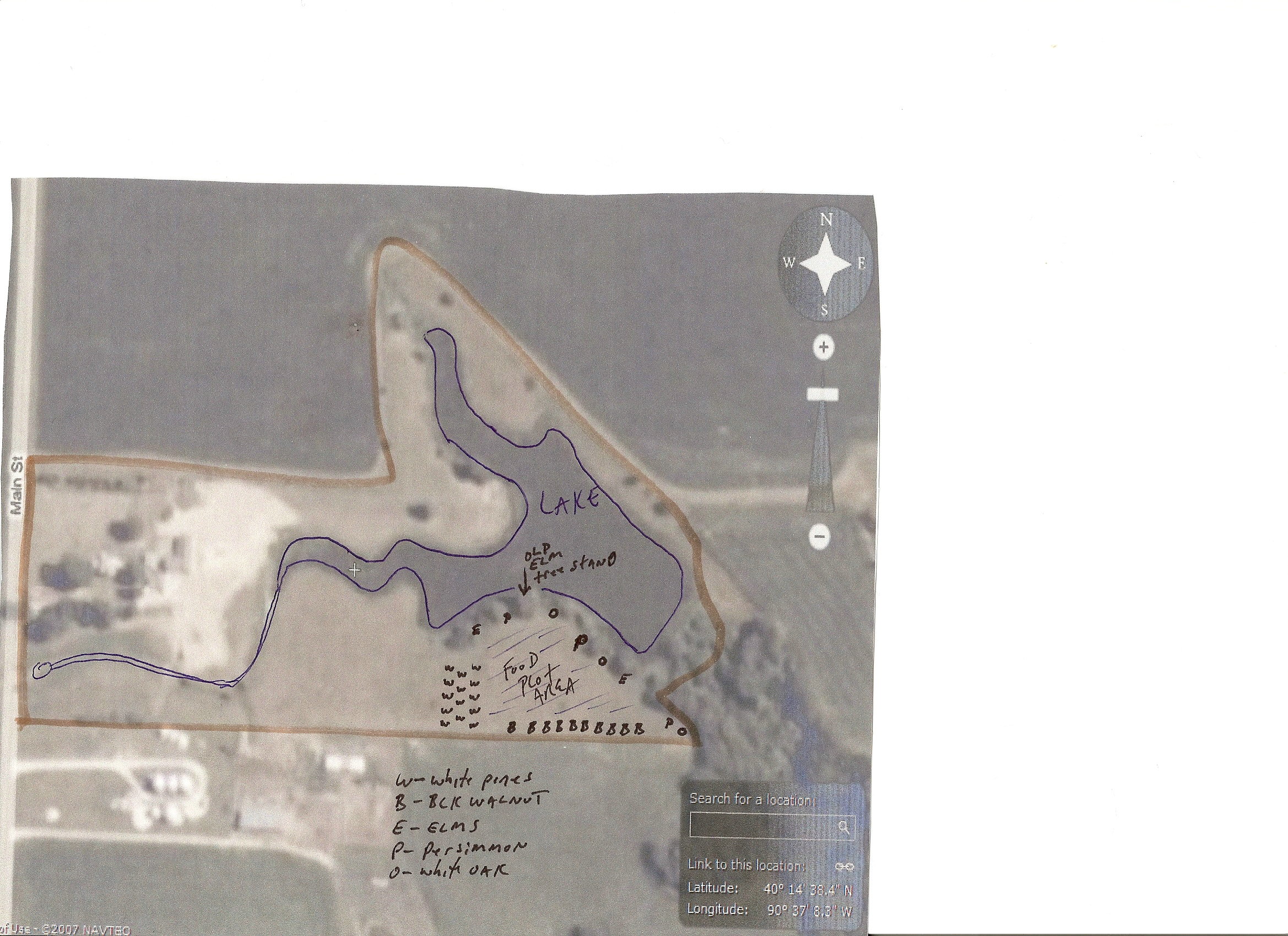

Howdy again... got some more questions. Have a YM2000 that i picked up last year to assist in planting of my plots as i wasnt having good luck getting the penetration into the ground with my atv. I made a 1 row cultivator using s tines to help break up the ground. I have been looking into 5ft discs and rotary tillers. I have come across a used but in near perfect condition John Deere 1 bottom 12 in. mold board plow at a good price.
Should i pick up the bottom plow, and if so would i still need a set of discs? Is there any reason to pick up the plow since i have the home made cultivator and plan to get a set of discs?? thanks dave
