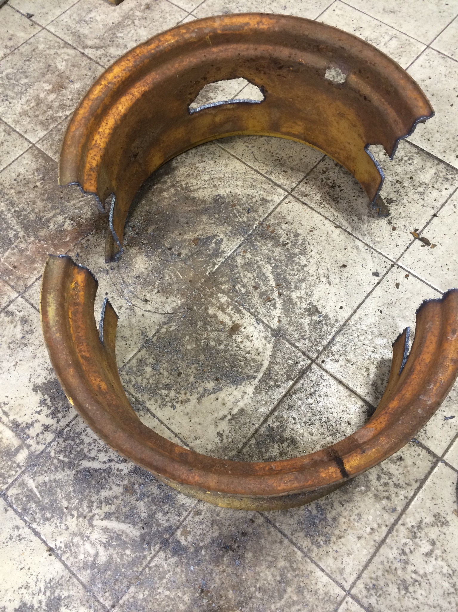

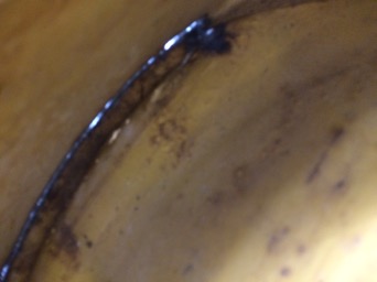

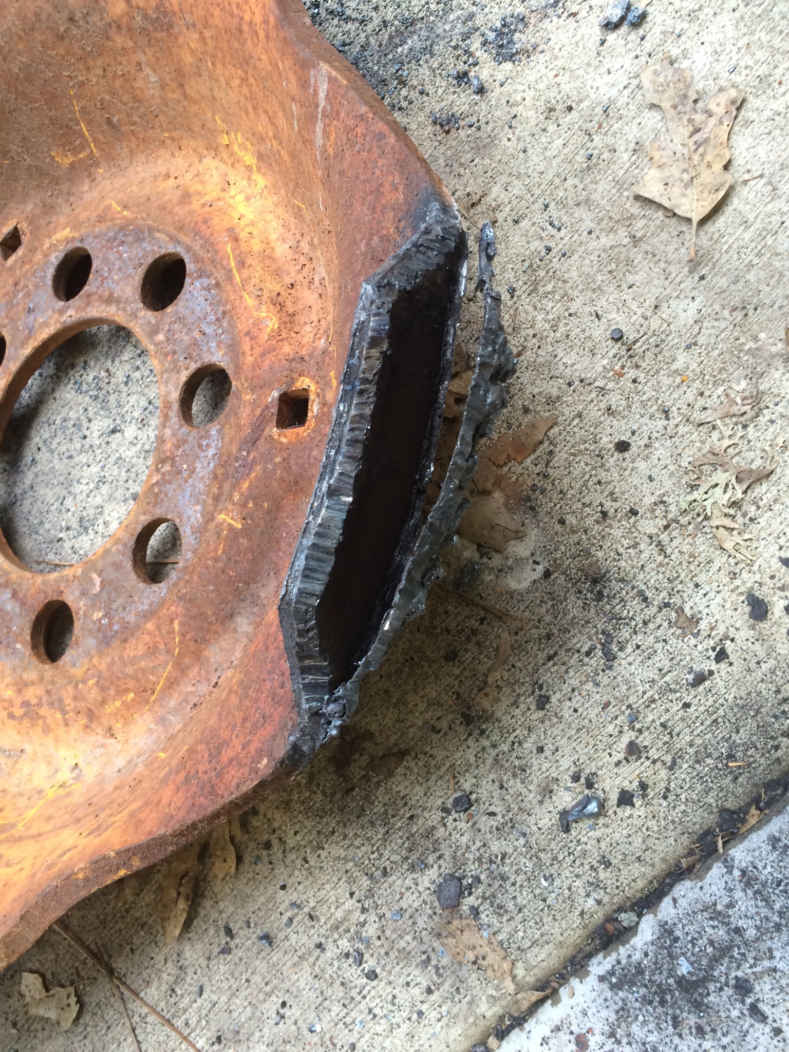

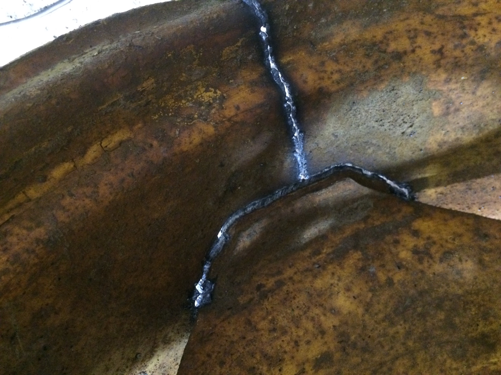

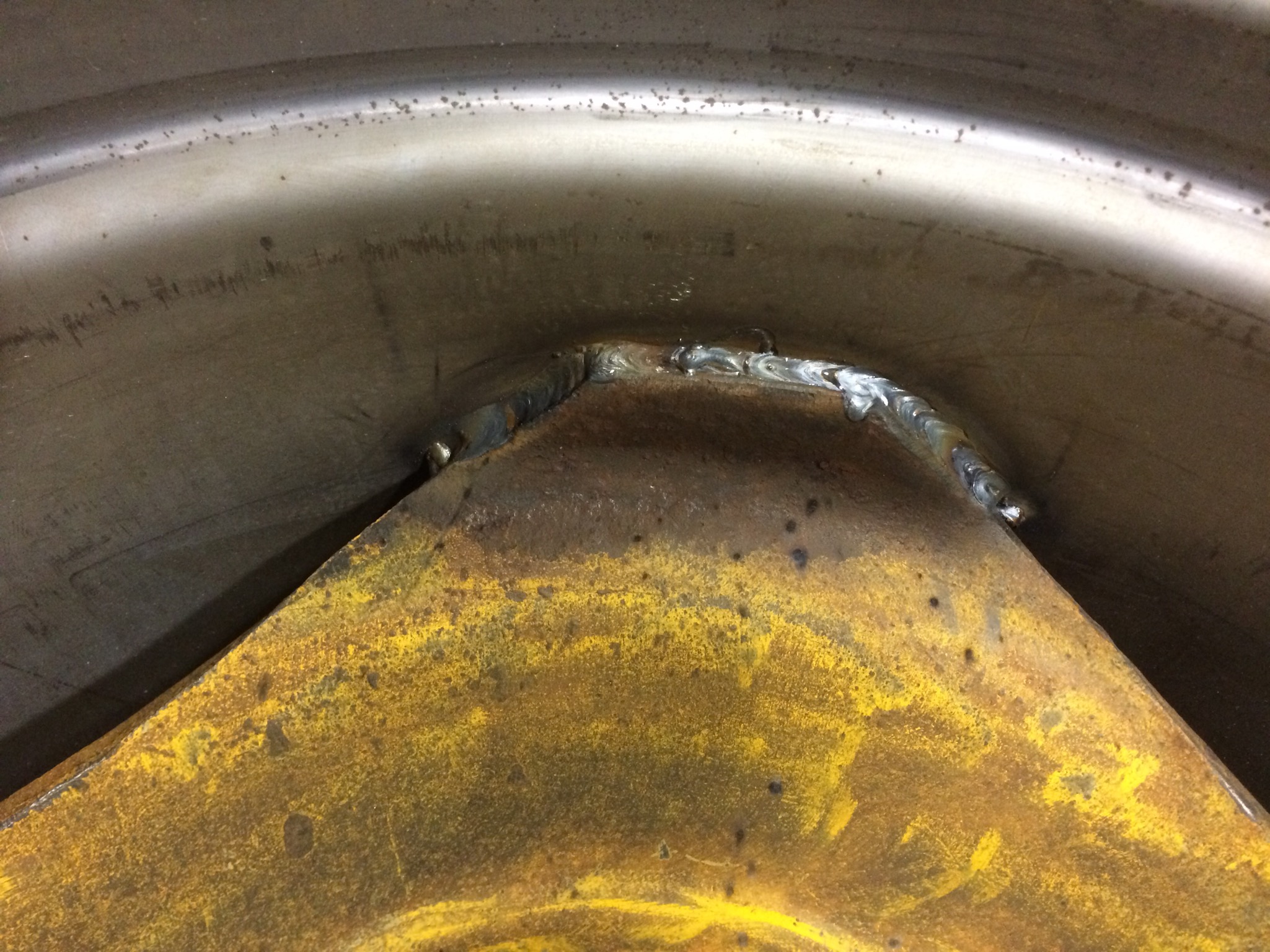

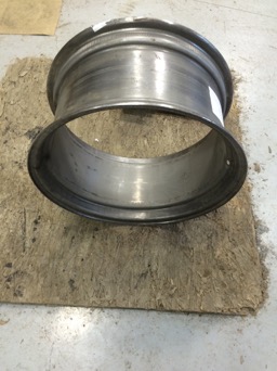

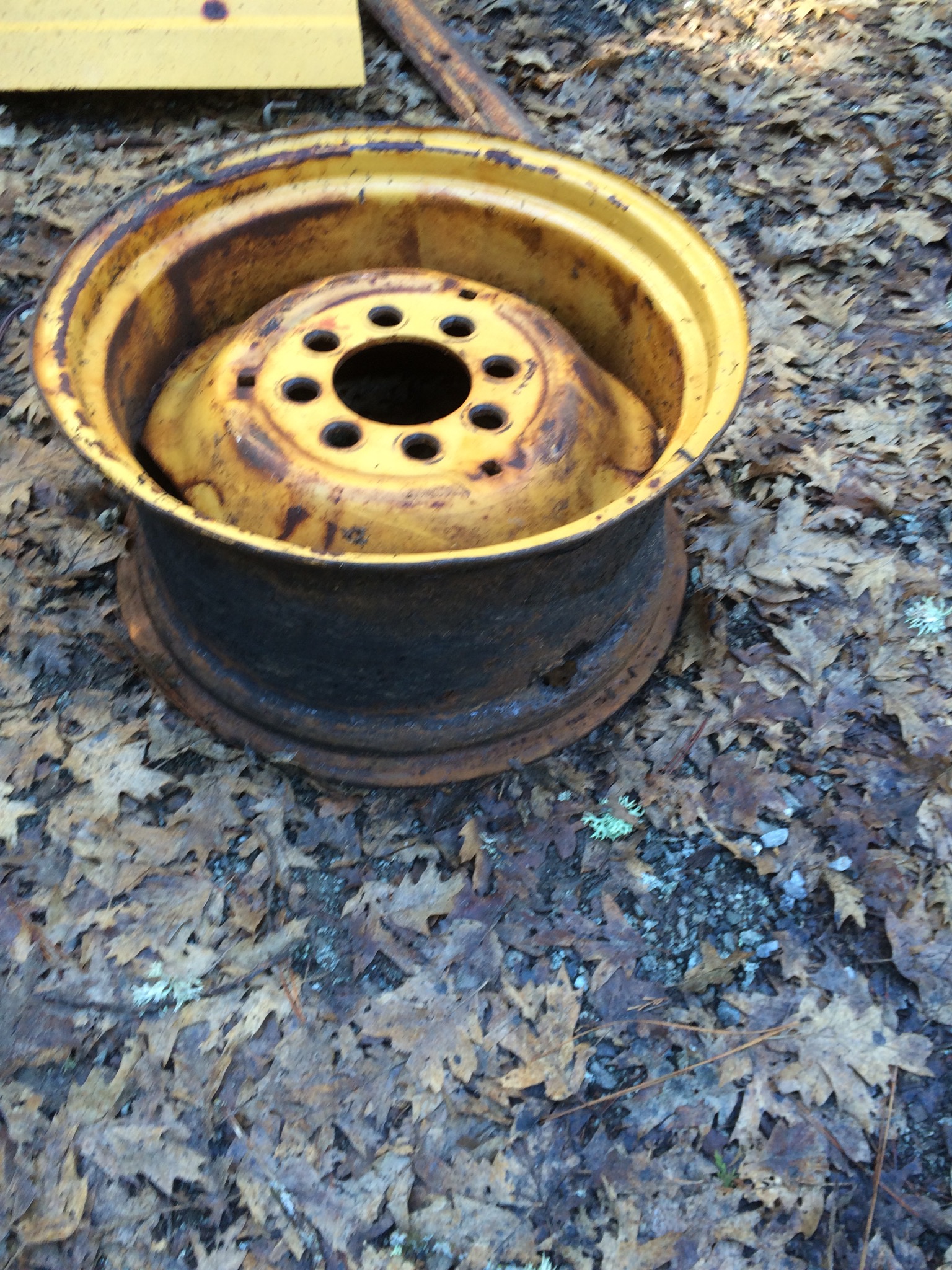

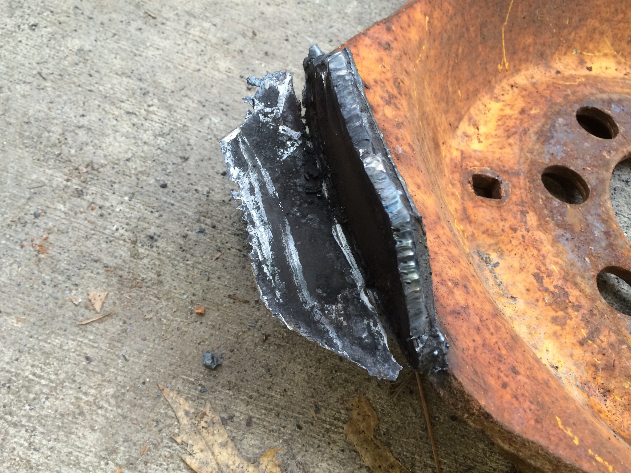

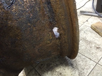

This tractor I bought had calcium chloride aka salt. Before I bought one of the stems had leaked and destroyed the wheel. I put on a new rim and filled them with windshied washer solution.

I have foam in my manlift tires and that is good because you won't tip because of a flat. But it does not add enough weight for pulling a scraper box, and if you own a skid steer it a can be very costly cutting the old ones off and foaming again. It has it's place but not for everything. That wheel came off of 32 year old tractor but it had tube in it when I got it, probably had many tires before.
