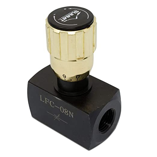

Hello All
The left/right swing on my new backhoe attachment is way to fast, everything else works fine.
I was considering getting this adjustable flow control valve and putting it in right where the hydraulic hose hooks up to the controls for my swing , and then attaching the hydraulic host to it.
I'm thinking this will let me control the speed of my swing speed. I don't know all that much about hydraulics so I thought Id make a post to see if there might be anything I'm missing here.
Thanks for your help in advance!
/ Flow Control #2
Yes, that will do exactly what you need.
You just need to check the specs on the flow control valve you choose. Some will adjust the flow in both directions, meaning you only need one, while others will adjust only on one direction and provide full flow on the opposite direction, meaning you need two valves but allows for flow settings this way.
Ideally, you want two flow control valves regardless. This will provide full flow control on the return side of both hoses and the momentum of the boom won't "run away" compared to have a single flow control valve.

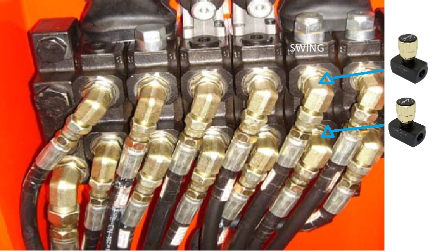

Thanks, that's some great information. So you are saying I should have 2 control valves placed like the picture below?
Also , here are the specs on the valve, I believe my backhoe is max 2000 psi and 5-6 GPM

Yes, one in each hose. That's a good spot, but it may get a bit tight really fast. You may have to put those on the T fitting near the cylinders instead, at the cost of being a bit harder to adjust.
22.5 GPM is an huge valve though. You can get something a lot smaller and cheaper.
Something like this: 3/8 NPT 8 GPM Prince WFC-600 In-Line Flow Control | Wolverine by Prince Mfg | Brands | www.surpluscenter.com
You'll have to figure out what size and type of fittings you have there. To me, looks like 3/8" BSPP but I won't confirm this 100%.

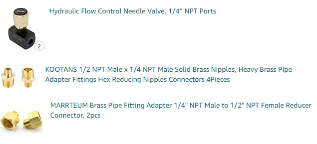

Thanks for the information. So these are the adapters I ordered for the control valve below.
/ Flow Control #18
Please cancel that order ASAP. Those fittings are not meant for hydraulic pressures at all!! Get proper hydraulic fittings that can handle thousands of PSI.
Ok they have been canceled. I'm going to visit our local tractor shop and see that they have.
