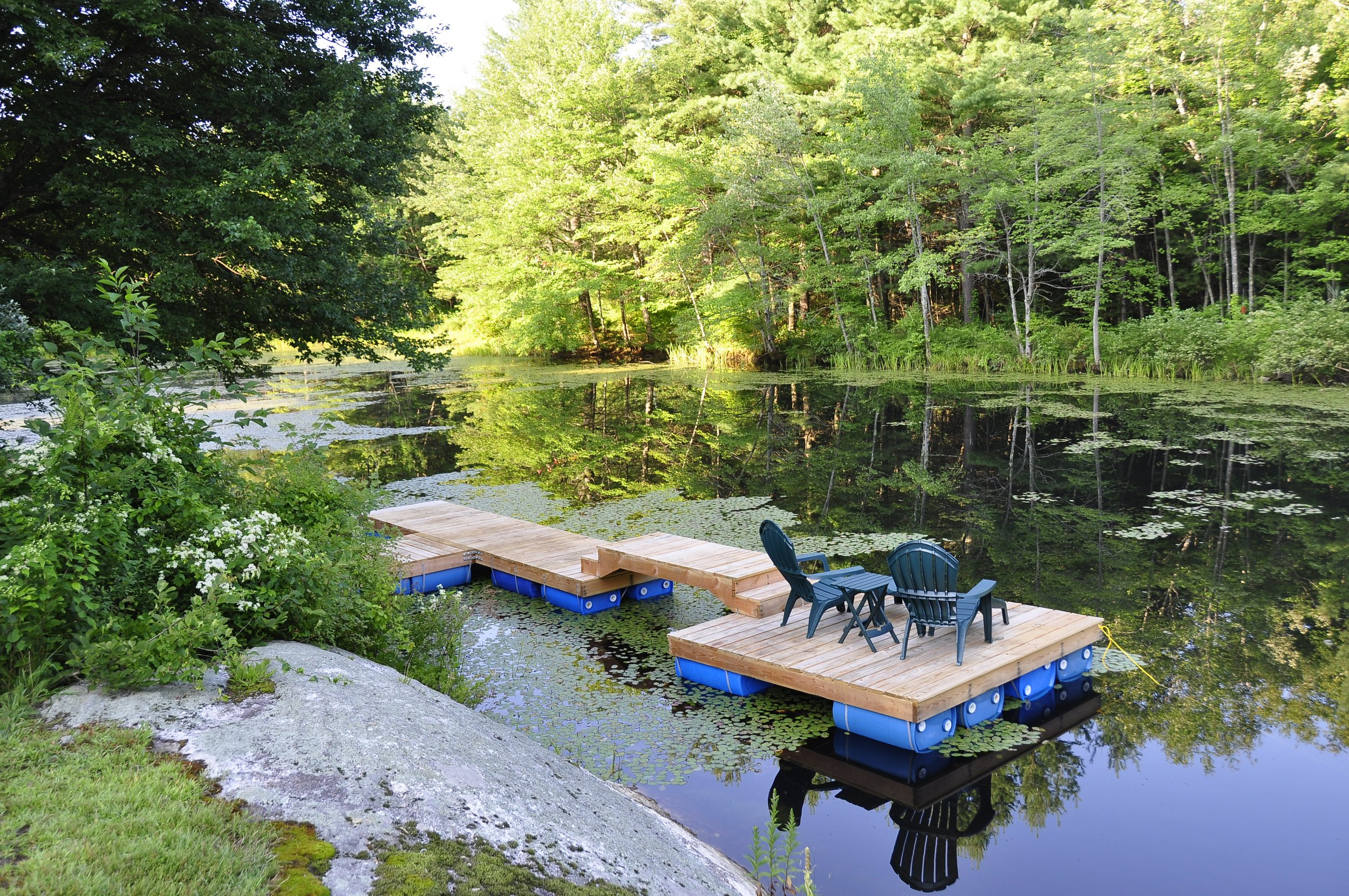

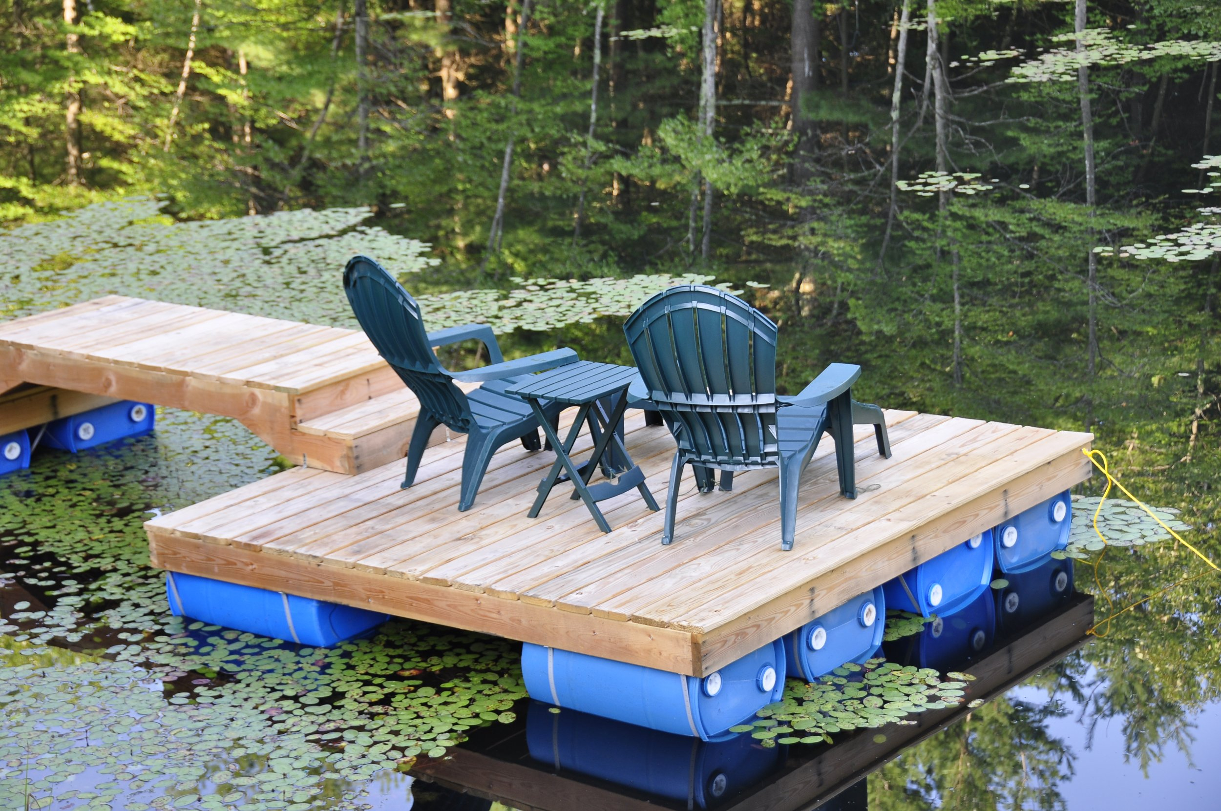

Here's our floating dock.

What ever you use don't use Styrofoam, critters go in and chew it away to nest in it. If you use plastic barrels seals the cap with a sealer like caulking if not the caps will leak. I would suggest if you can find a old pontoon boat they make great floating docks.
