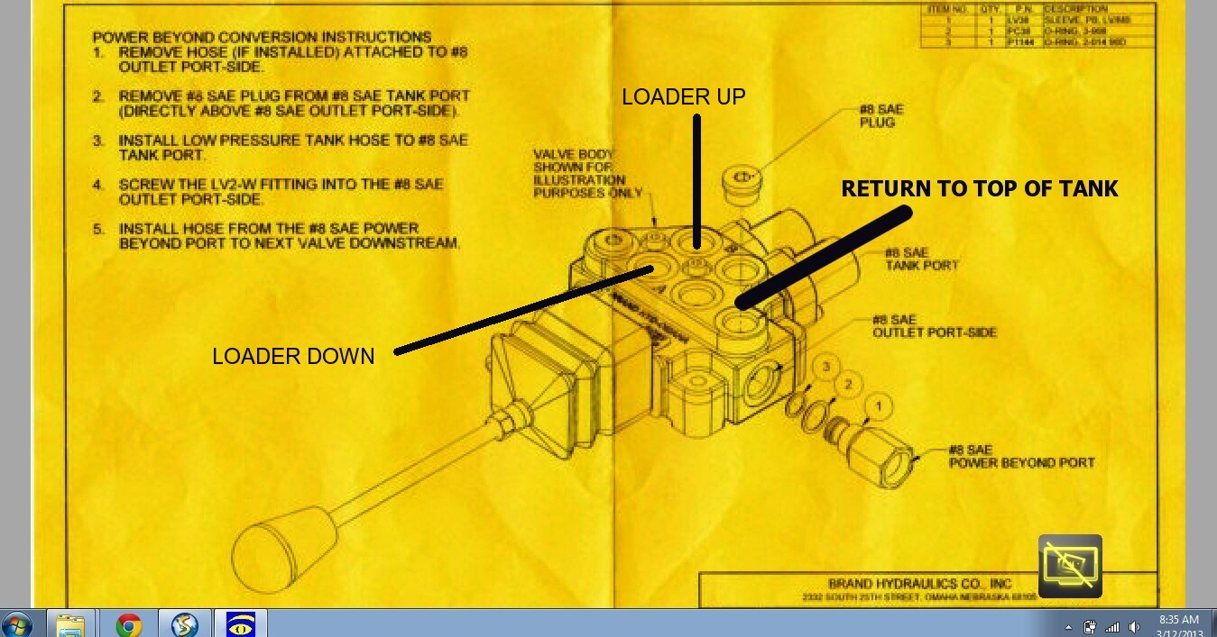

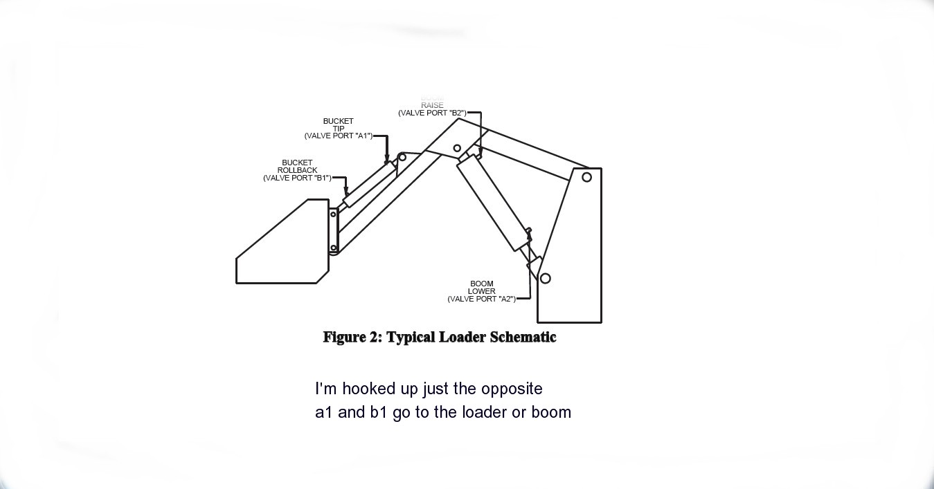

I routed the hoses the way they were on the original Kubota valve but just noticed they are different from a typical mounting.Could this be a problem? The schematic shows bucket hoses going from a1 and b1 , I have them just the opposite. a1 is loader down and b1 is loader up.

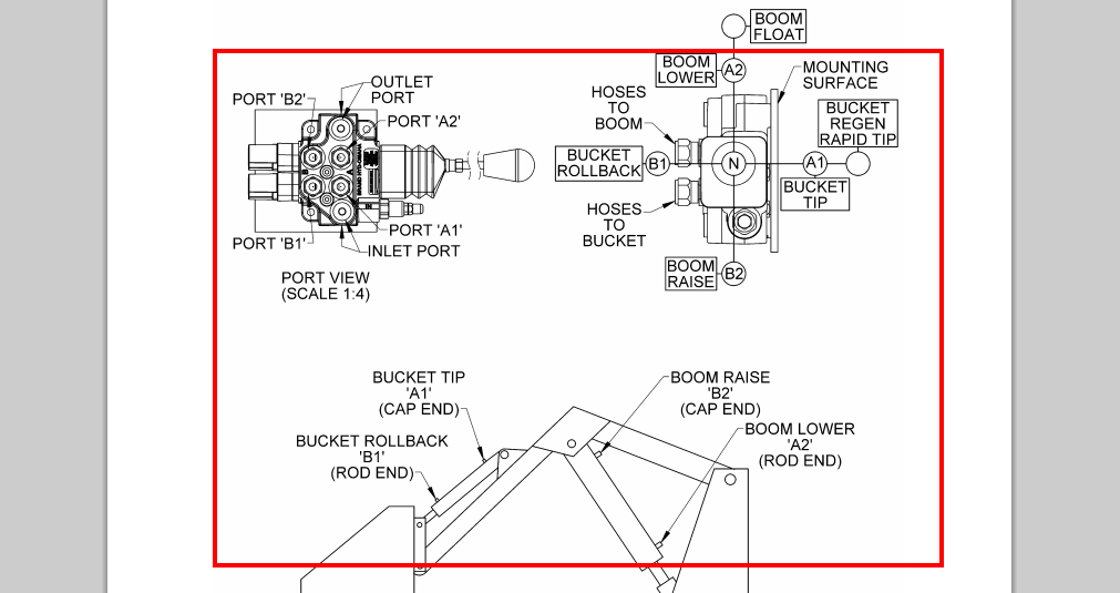

/ FLOAT CONTROL #13
Yes, make sure the hoses match the valve operation.
Is the loader valve working like it should .
Pull lever back the loader goes up.
Push lever fwd, loader goes down, push into detent, float is engaged and floats.
Lever left, bucket tips up.
Lever right bucket tips down, and lever to far right, regen take over and provides a fast dump.
http://www.brand-hyd.com/lv/catalog.pdf
A2 is boom float.

You can mount a 3000 psi liquid hyd in a tee at the IN port of the loader valve for permanent installation., or in a tee with a male QD.
Here are some hyd test sets made by some of our TBN friends.
You can do these for about $30.
Surplus Center - 3000 PSI 2.5" LF LM GAUGE
or pick one up at a TSC, or Northern tools.
It will help you monitor and trouble shoot the hyd system.

JJ and Farmer, Thanks again for the help. The loader works opposite of the way it is described. Pull the handle back and the loader goes down , keep pulling and I feel the detent and then the loader raises. If I switch the hoses won't the detent be in the wrong place?
Push forward and the loader goes up but I don't feel a detent in that position. Left and right roll the bucket.When the rain stops I'll hook it up according to the diagram. a1 to detent to roll the bucket. Just doesn't sit right but then I just don't know.
/ FLOAT CONTROL #18
DUH (to me).
That valve is designed to be mounted with the work ports on either the left or right side. Yours is mounted with the work ports up. That means the joystick is 90degrees off from where it was designed to be. That "A" and "A1" option business corrects the joystick for mountings where the hoses are on the left or right by rotating the stick functions 90 degrees. But it has no adjustment for a horizontal mounting.
So you must either rotate the mount so the valve has the work ports on the left or right, or leave it as is and learn to operate it in reverse or leave it as is and have regenerative on the boom and float on the bucket.
/ FLOAT CONTROL
#19
I just came in from changing the hoses and did it before I read your post. Now the up and down are controlled by turning the handle left and right but do have a fast dump when I use the detent. Guess the boys over at Orangetractor sent me to get the wrong valve. Really want the float position and should have spent the 1k for a valve at Kubota.
