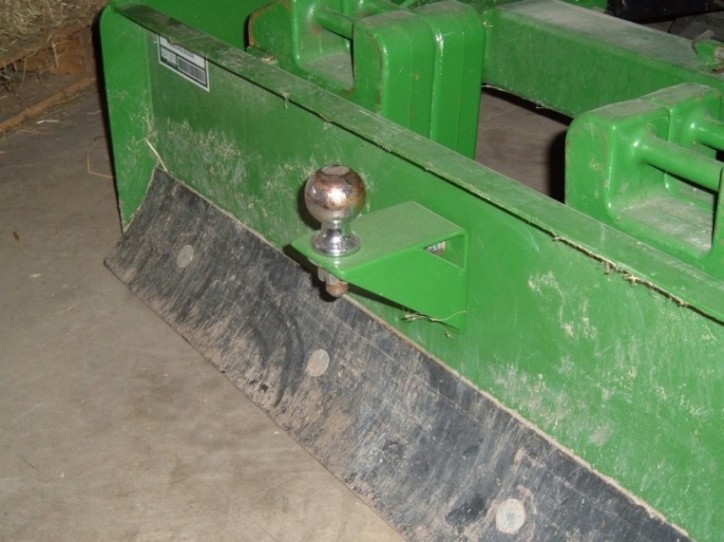

This was pretty easy to make and works fine for moving trailers around the property.

2305, yes I didn't read your post very well. I'm not actually sure if Ruegg has a website, but he does sell on Ebay. Do an advanced Ebay search by seller ID (rueggmfgllc). You should see his CAT0 drawbar come up. Give him a call (330-418-5617) to ask if he has a CAT1 version and what spacing it has. He also sells direct as well as EBAY.
Also don't forget the option of just putting a ball on your fixed drawbar. Remember that the 3PT has no down preasure so something like a dump trailer could cause the 3PT to raise. Good luck in your search.
