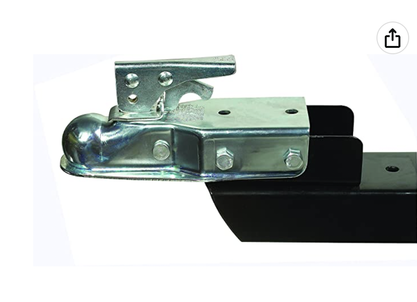

OK new plan. What if I made a trailer receiver like this that would stick into the 2" trailer hitch receiver on back of UTV and pick it up with a ball on the 3 point. So I would basically be picking up the back half with the trailer hitch and the front half would be riding on the front wheels. Again just spitballing here, any of you naysayers like that any better? Again, tractor speed on forrest trails.

Seems like an interesting idea. The front wheels are just freewheeling when you are in 4WD anyway. You might want to tie off the steering wheel somehow to keep the wheels pointed straight ahead

Yeah I thought about that for the sterring wheel but it is not like I am going to be going fast enough to get any wobbles so whats the point? The only thing I could see needing the front wheels locked for is going in reverse. Doesn't seem too hard to lock those front wheels in place somehow.
   / Flat Towing UTV to on property job site with tractor #50
If you don't lock it straight ahead, and the wheel turns, the ATV will not track behind your tractor. It will run off to one side. That can get inconvenient if you have narrow spots on our trail. You'd also have to be constantly looking back to check on it.
Depending on the steering geometry, it may be that the wheel will self-center. However, even if it does, I would not want to count on it. Rough terrain or an obstacle could knock it out of line, causing the ATV to swing to one side or the other.
