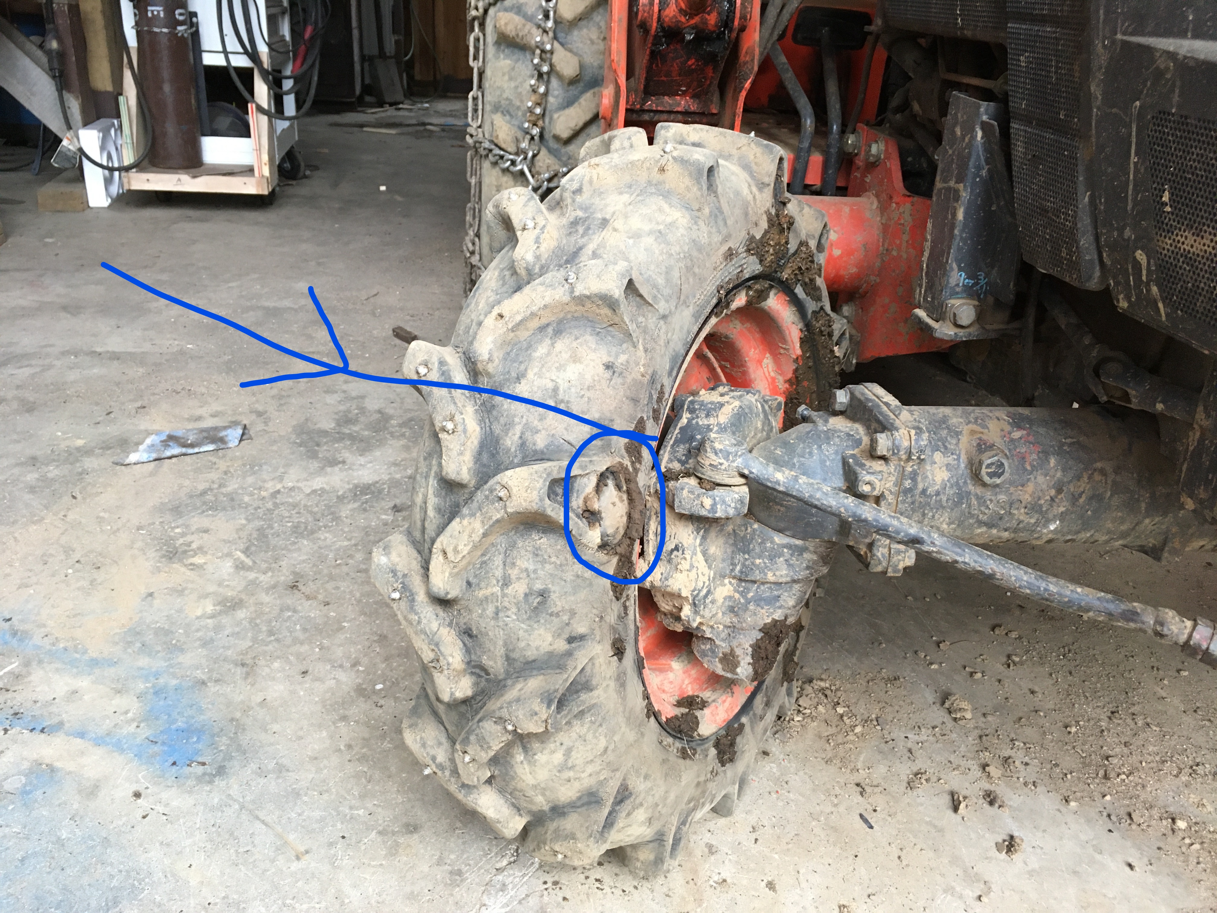

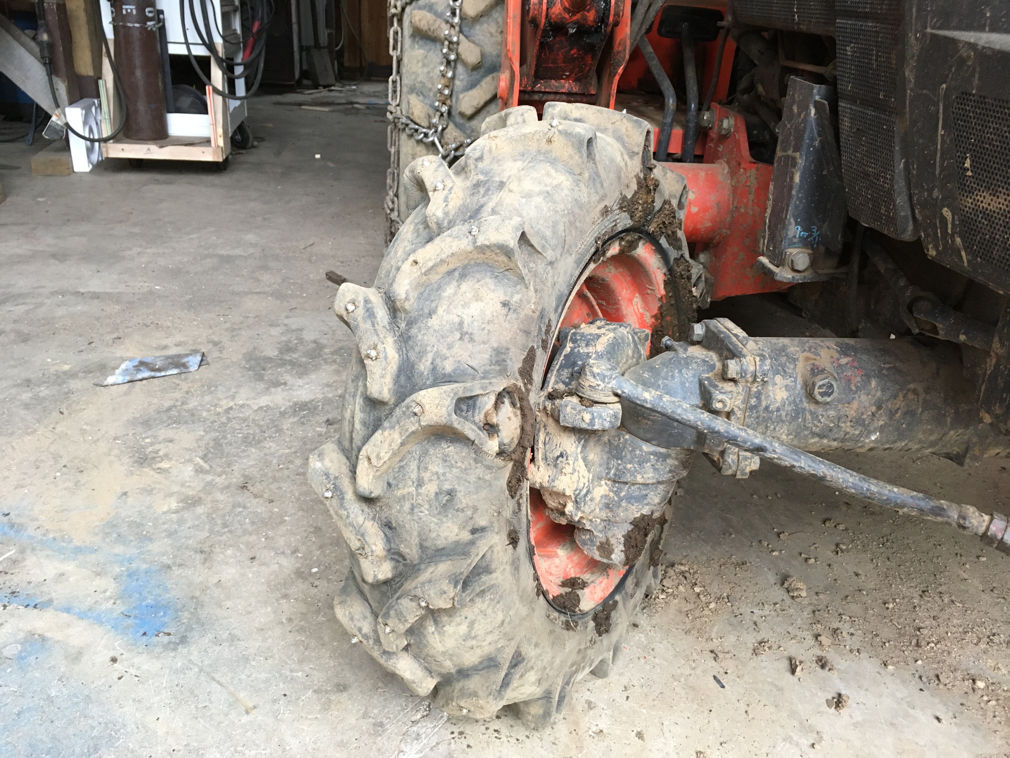

Well the patch looks like it's giving out and the cut is getting bigger and now I have a slow leak, yup time for new tires, again, this will make the 4th set in front in 12 years vs 2 sets on rear. What is needed is a way to sew the cut back together somehow then patch it.
View attachment 653127 View attachment 653129 View attachment 653126
That can be done I have seen cob jobs that worked as well as professional repairs that work very well.
The trouble is that the professional repairs cost more then a new tire of that size.
It was first fixed at a tractor place where I bought the tractor last Oct, I dont know if they are professionals or not but now the rip is getting bigger. The Galaxcy front tires I had before these ones all the tread wore off in two years, so do I want the tread to ware off first or the sidewall to rip out first.
My rear tires are holding up good so far but I thing keeping tire chains on all year helps tires last longer, I'm thinking of putting some old V-bar pickup chains I have on my new front tires maybe they will protect my sidewalls, the Main Maine problem is TO MANY FREAKEN ROCKS...............

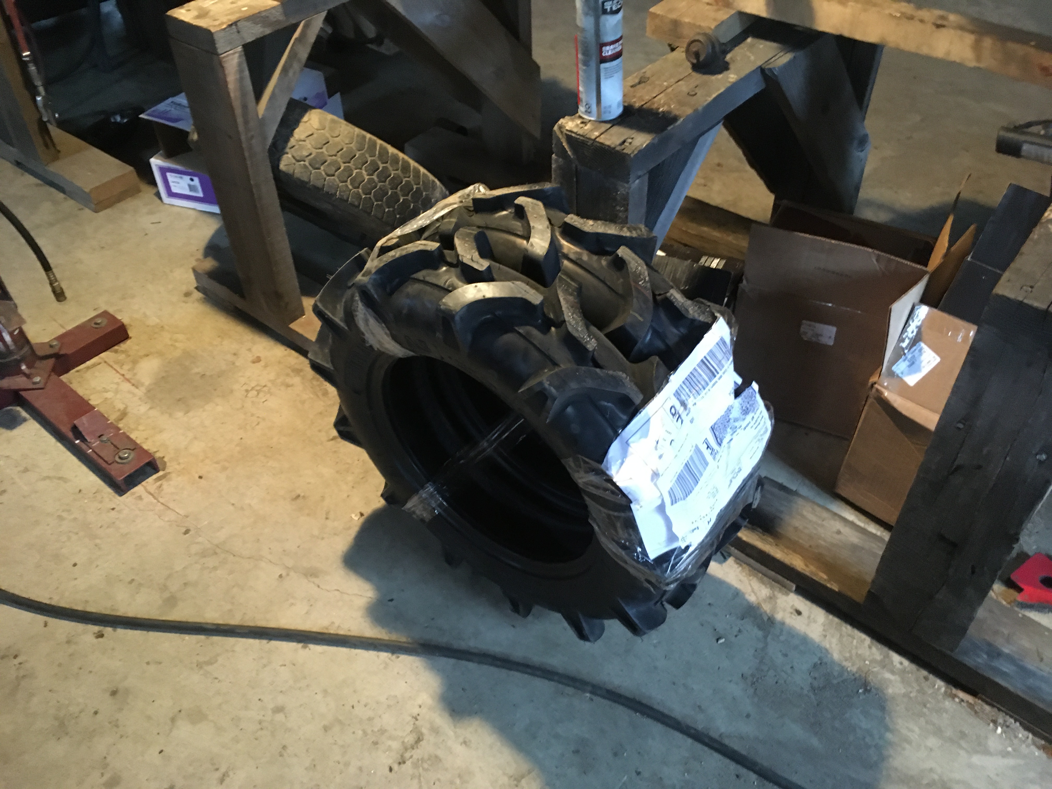

:thumbsup: Thanks for the link I couldn't find a place that sold them clip things, I'll order them sometime soon just to keep them on hand for the next time, oh I'm quite sure they'l be a next time.
My new $150.00 tires showed up today so I'll put them on this weekend. I ordered them Sunday night so they got here quick I thought.
