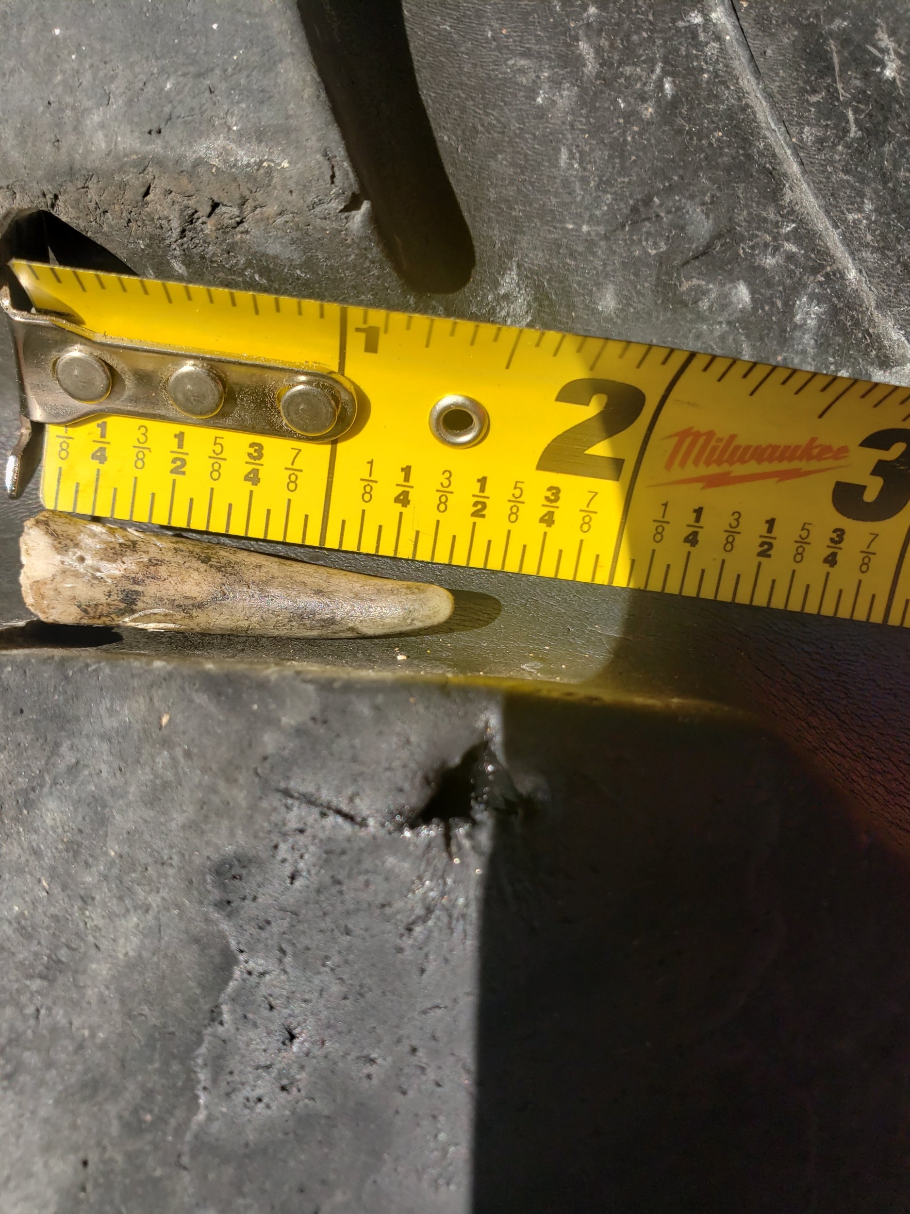

Man this here be TEXAS dats a itti bitti deer for that tiny antler........LOL:ROFLMAO:🤣🤣
I kid, I kid....
Yeah I've run over antlers and never seen one weak enough to break into that small of a size, unless that belonged to a very young buck. Gonna save it, my neighbor is big time hunter; I'll show it to him next time we meet at the fence to swap lies, er ah tales...

We have copper heads here, no rattle snakes.
Oh and we have been having hogs rooting around our pecan trees.
Certainly could be a tusk from a hog.

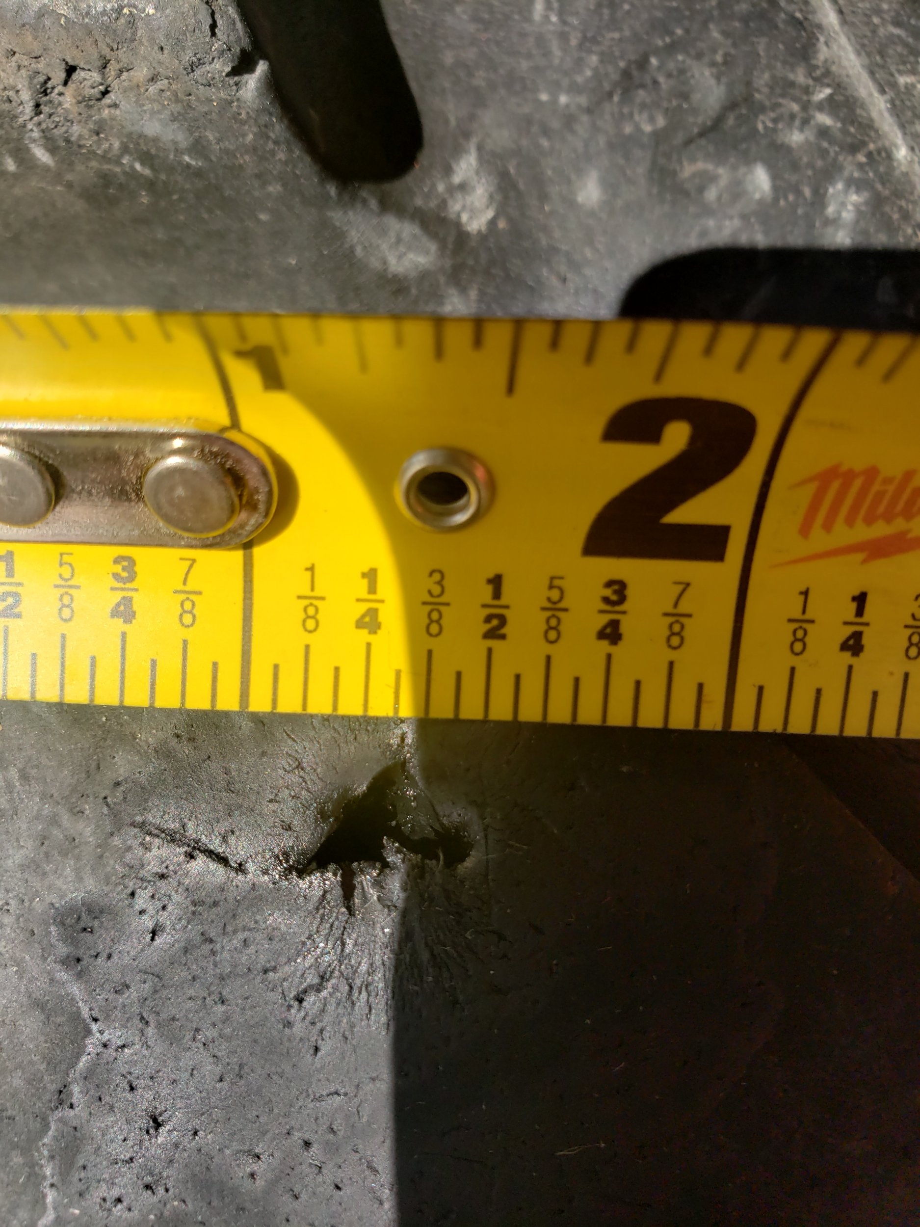

Once you plug any leaking and the area is dry, you can build back rubber with windshield urethane if a pit bothers you. The urethane comes in a caulking style canister. Once you open it, make use of it because you can store it after that. I've repaired lawn tractor tires with it (as well as installing auto glass). It turns to a pretty hard Rubber once cured.

Well it did take some time but got it plugged. Used half of one tire plug, a round dowel then a alignment pin to push it in. Lathered up real well with rubber cement first.
Trimmed it down, more cement and rolled it near even with tread. Now curing for a few days. So, another simple job well done with good tips from a handful of (retired) folks on how to make it stretch for half a day......heh....heh....

View attachment 842623View attachment 842622
I walk around and inspect machine and wow a white dot.
Hm, using two HF picks and removing it, it is a 1 1/4 long tooth, from right rear tire.
Again, wow, what are the odds? After repairing the left rear now the right rear tire.
Well the good news is that it was removed from the R4 elevated tread.
So this did not puncture or compromise tire.
But it now has a large void.
I'd like to find a material, method to fill this void.
All I find on line are flaky outside repairs for flats and one flaky tractor repair of an exterior patch.
So, I'm here.
Cause if anyone has done this and got experience to share, this is the place.
Thanks y'all.
PS if it looks wet, it's cause I used a gas leak detector fluid to see if it was leaking. No bubbles, whew!
You could use some Loolifl Tire Repair Glue to fill it in, but it doesn't appear to be damaged enough to compromise the tire.

It looks like the tip of a Deer Antler! Get some roofing caulk in a tube, shove it in an inch and pump it full. Done.
