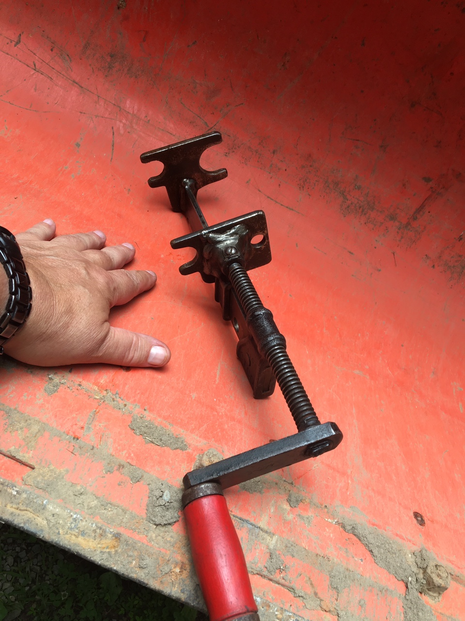

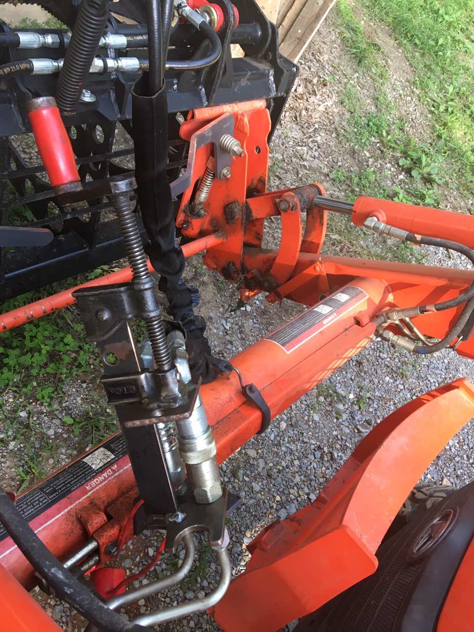

I made a bar clamp to couple the QDs. Don’t have to use it much but handy when I do. Doesn’t take much force, just more than I can do now. Works 100% of the time.
eBay has similar clamp idea.

Cycling the buttons with the key on but engine off on the tractor. Hot tractor you have to move fast or have a friend.
Might try disconnecting and trying to connect the hard one first.
