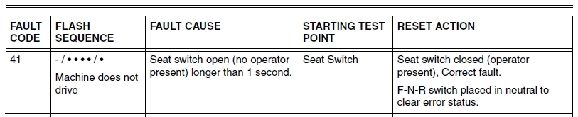

Hello guys.
While running the 4310 epower reverser today, I noticed a flashing code- 1 long- 4 shorts- 1 short.:confused: It has to do with leaving the seat while the reverser lever is in forward or reverse and the tranny is in neutral. Normally the engine shuts off for safety during this scenario.
Has anyone had this happen?
What does the code indicate? 1 long- 4 shorts- 1 short.
How do I fix it?
Everything else runs great!:)
Thanks guys, I know you you can help!:thumbsup:

Looks like just the seat switch.

/ Flashing code help needed.
Thanks JD.
The seat switch works properly when the tractor is left in gear so I'm wondering why it may be linked to the reverser issue.:confused2:
I'll check it again.
Thanks for the help.
