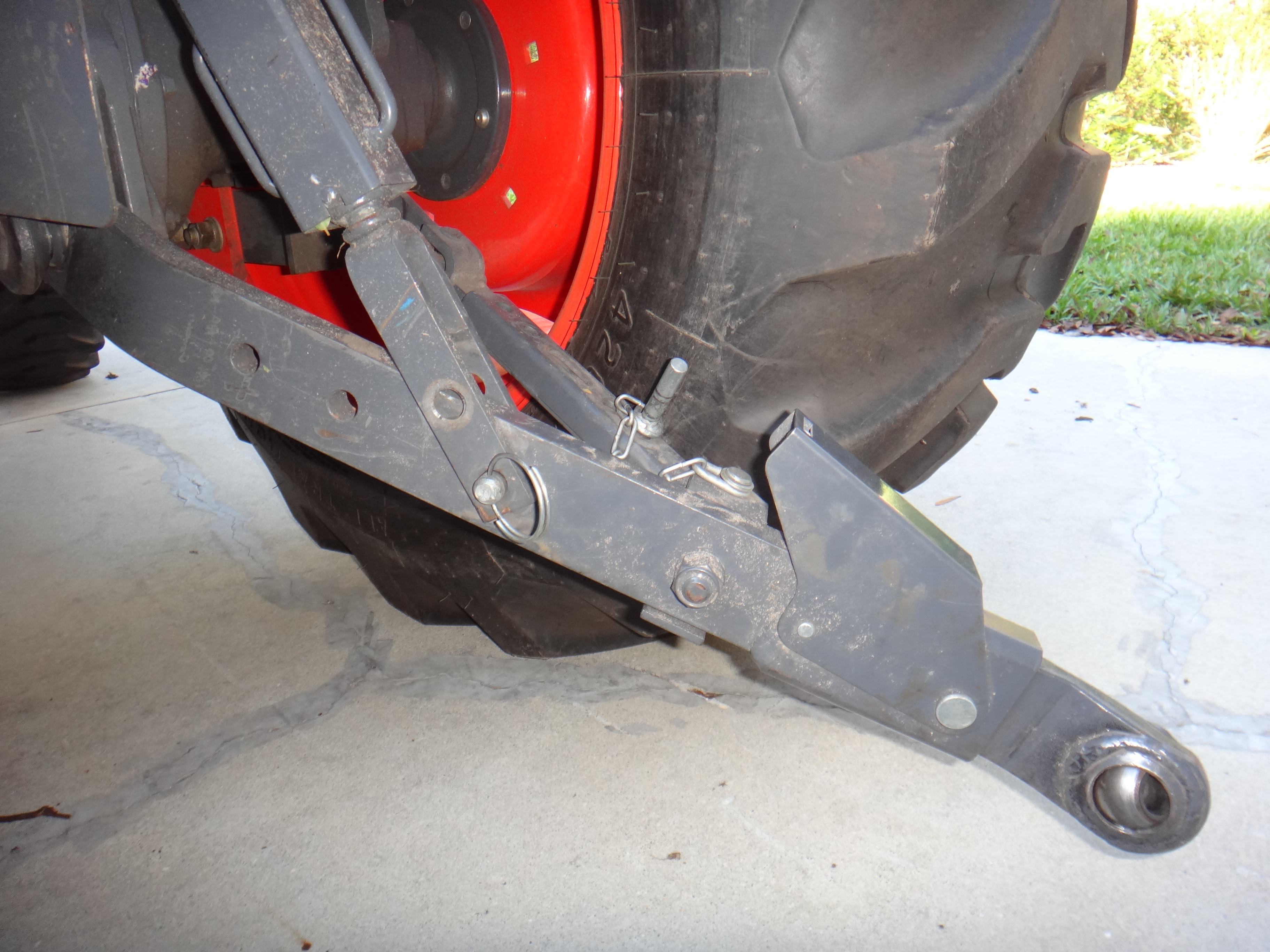

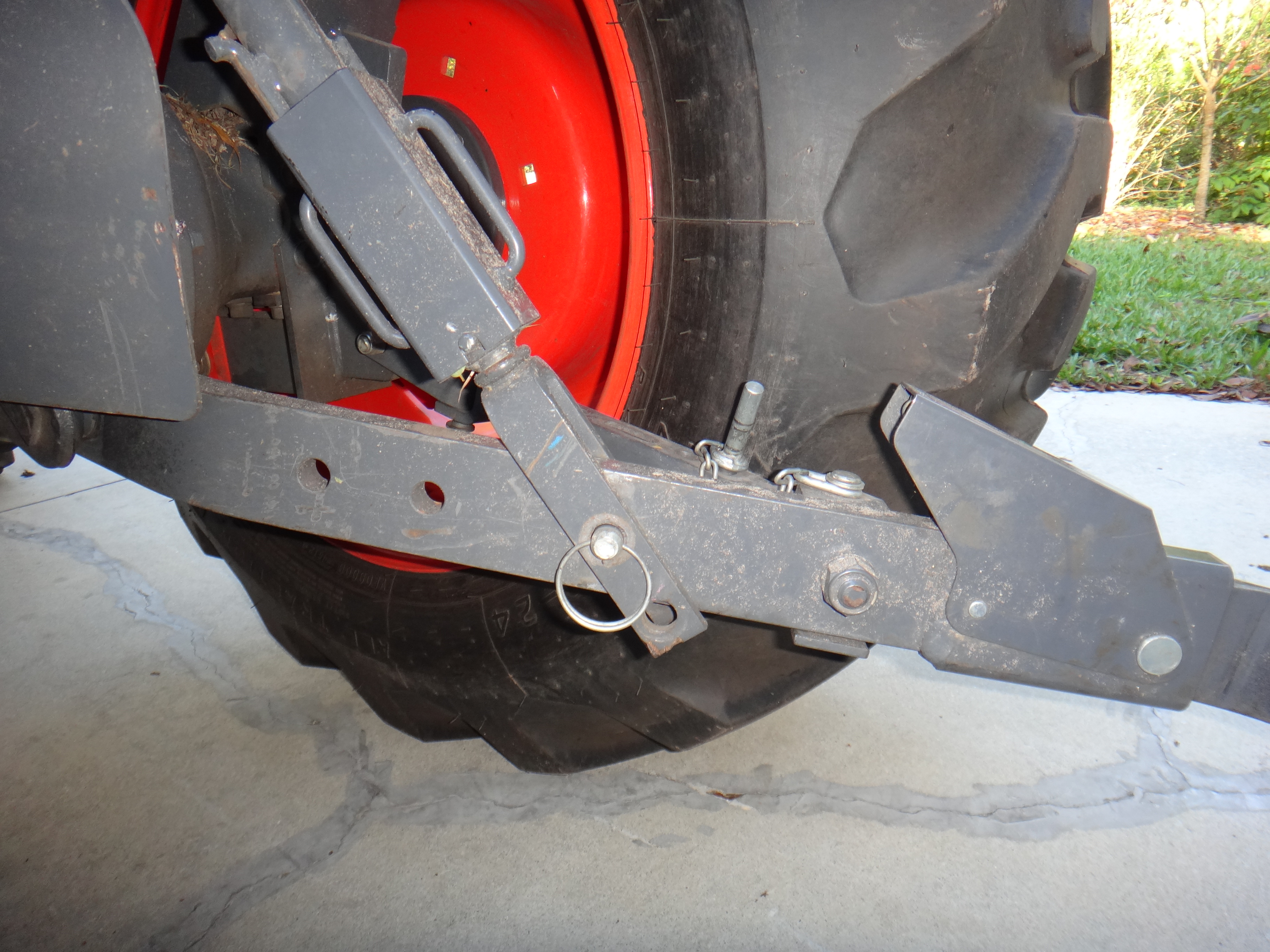

Make sure Three Point Hitch Lifting Rod stirrups are pinned to the Lower Links in the TOP pin holes, not the BOTTOM pin holes.
