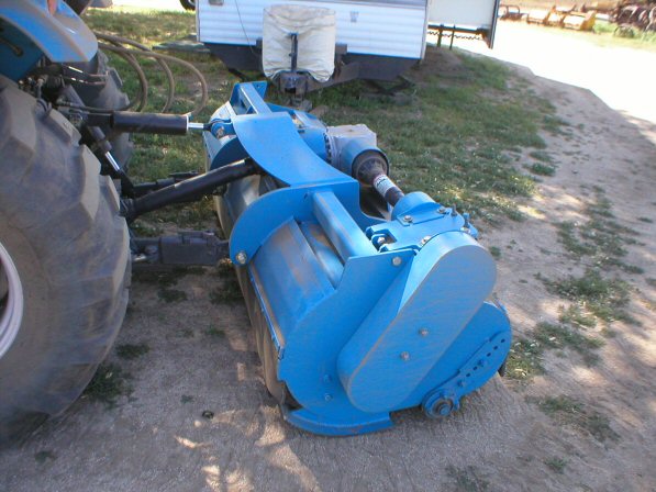

I went through the same thing you are just different reasons, I almost got a rotary then kept looking and thinking about what I wanted.
I wanted something that would cut a large area quick, I found a 390 Flail from John Deere, HP range is 30-75. We'll I did not think our 35 HP New Holland would handle it but our 60 HP was in the shop.
I hit stuff that was up to 3' tall and our 35 barley dropped rpm. They are out there, ours cuts about 7 1/2 foot. Here is a shot of ours, I've not done anything to the knifes yet but it's cutting pretty good as it is.

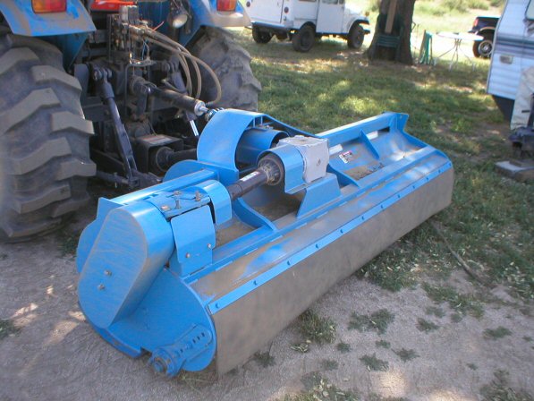

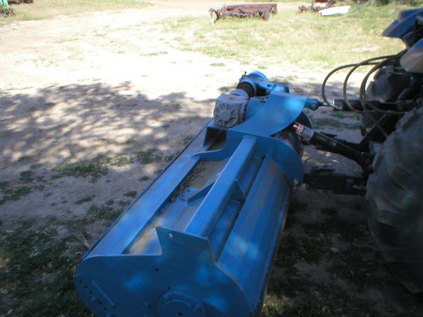

Builder, as you have found, there are deals on flails, just have to be looking all the time. I bought a heavy duty 102" flail that had been used a few times at the most for $1000 along with an 84" flail that needs bearings and drive belt for $400. I think that in reality the $1000 flails are the better deal, buy them and use them.

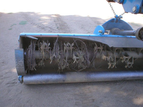

The rubber on mine is 1/2" thick, it does not flex much. I did rip off about 35% of the front rubber though when I mowed an old roll of barbed wire that someone had left out in the field.:mad: That was no fun to get it out of the mower, a lot of wire cutting to get it all out.
