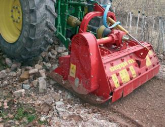

You might also look at flail mulchers for ideas, this one is from Construction Industry Product Information | Construction Equipment. They aren't intended for tilling but do quite a job of it if run to close to the ground.

Check this one out too. It's listed as a flail mower/tiller. http://www.ironsearch.com/Farm-Tractors/SmartSort-Equipment/BCS/Tiller-Walk(d)Behind/1474121.aspx
