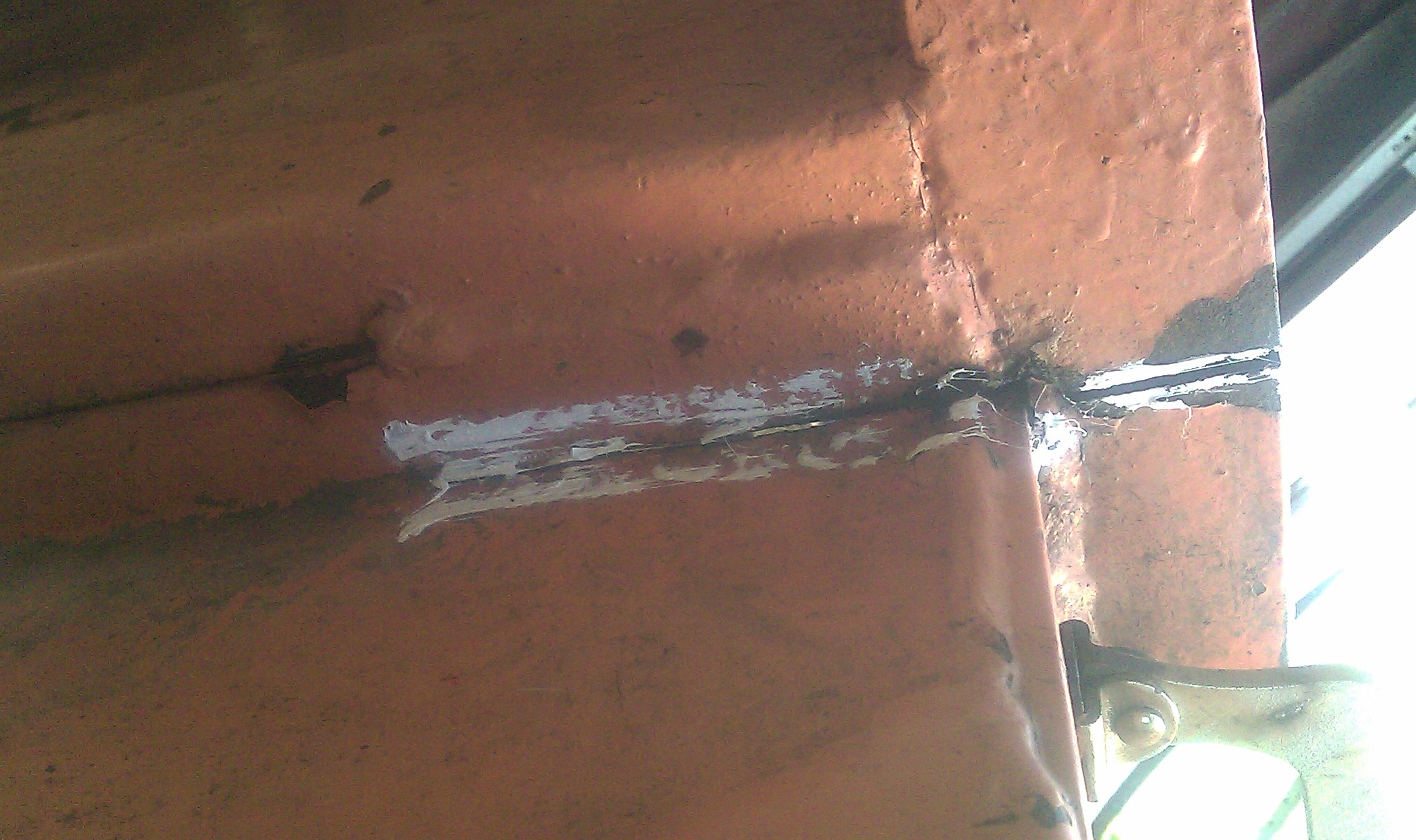

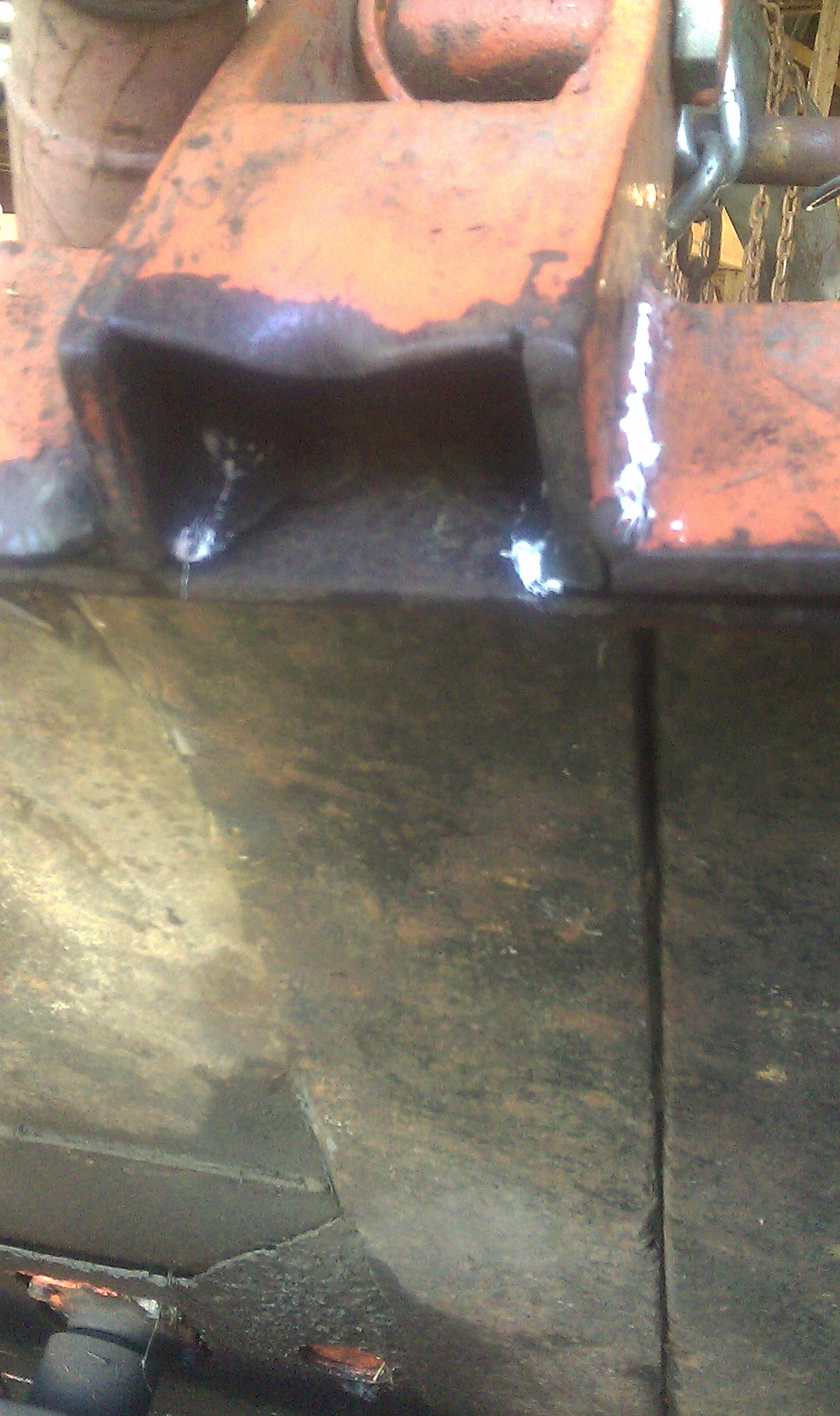

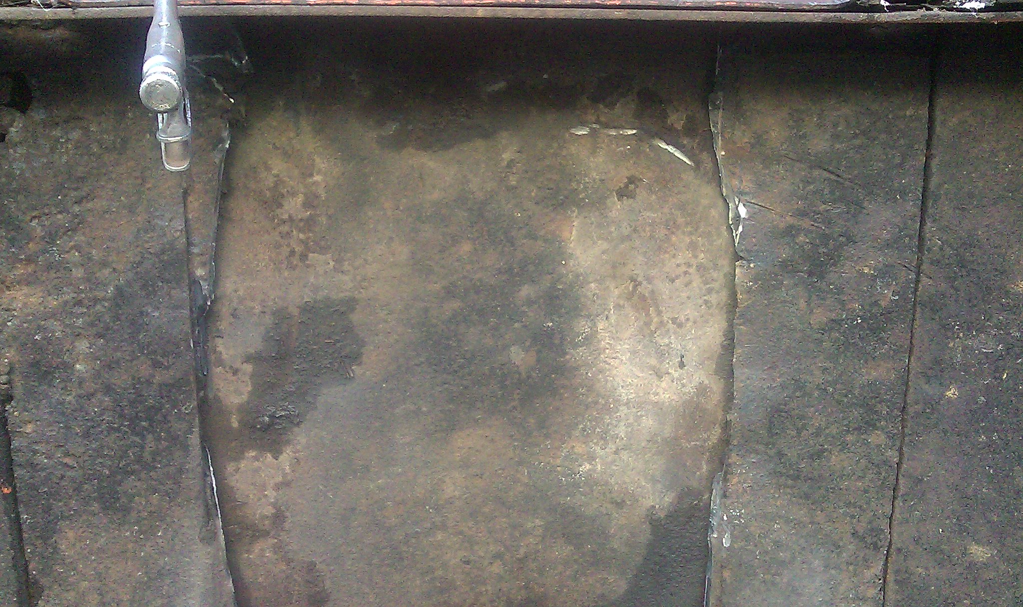

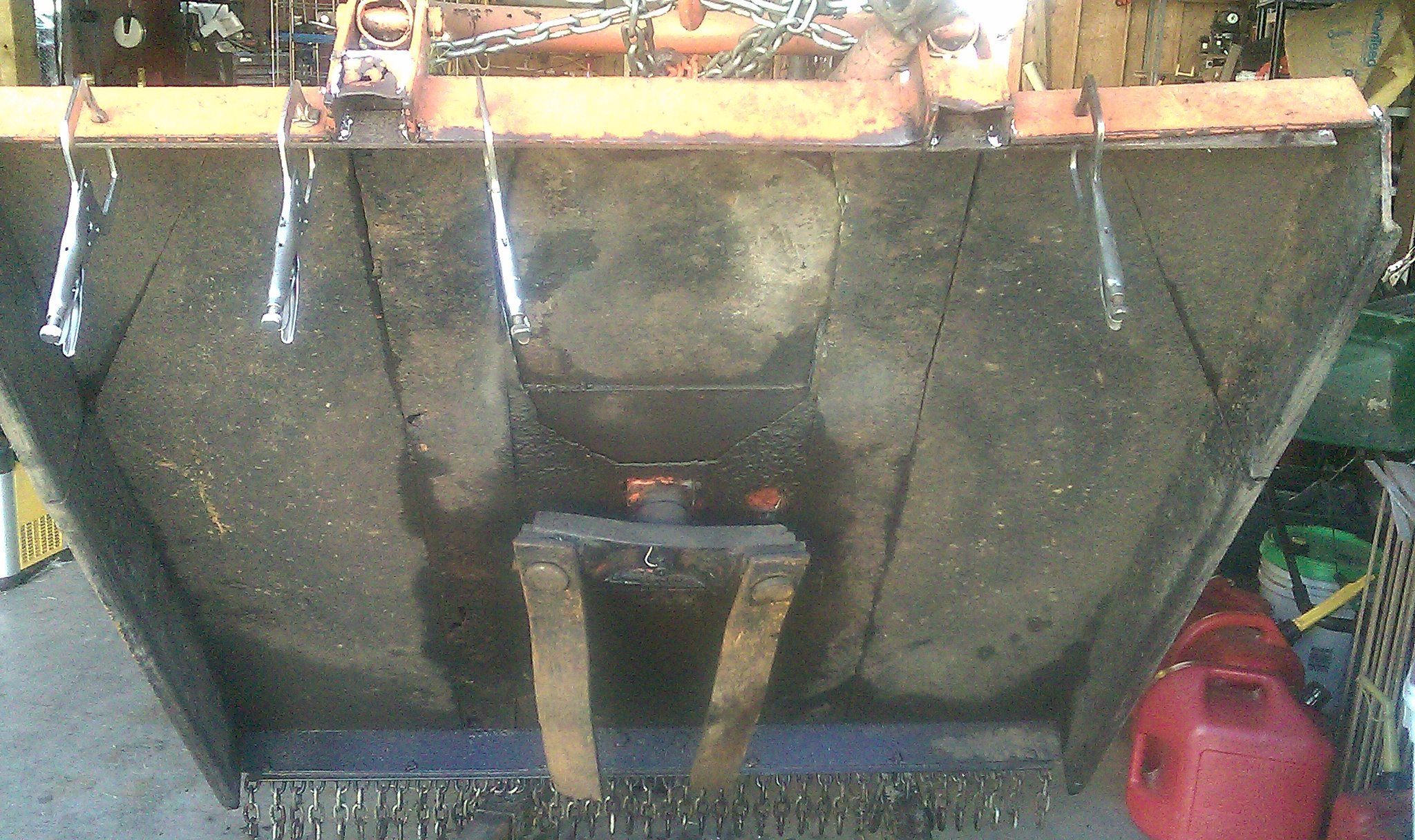

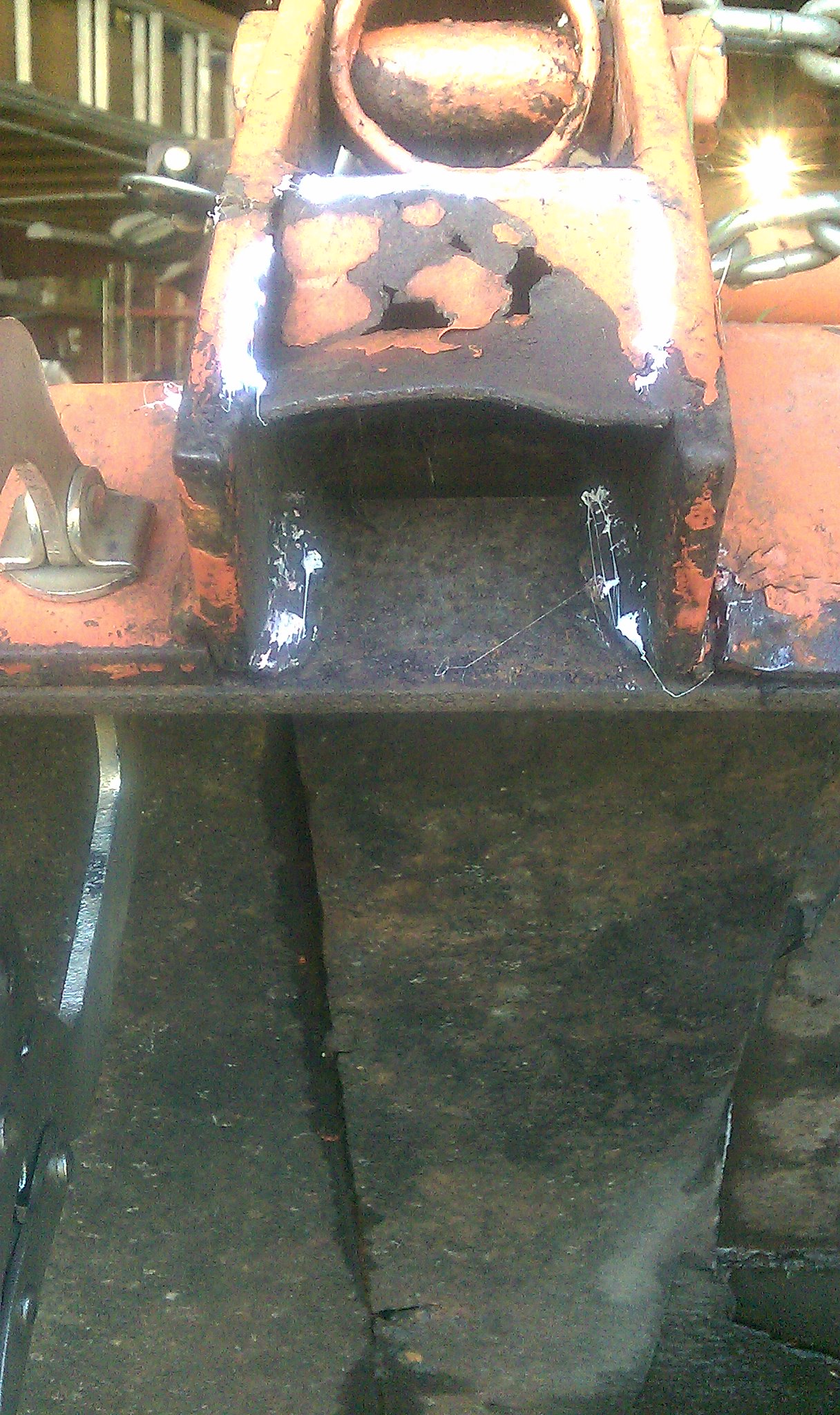

I went to hook up the bushhog the other day and I noticed that the deck was sagging in the middle. Took a closer look and the welds broke between two sections. I got it in the shop and picked it up to start cleaning it up and this is what I found:
White lines are where I am going to grind out the weld (or crack) and re-weld. I plan to re-weld the cracked/broken sections, then weld a backer all the way across the front to tie all three sections together like the chain holder does on the back. I have a piece of flat stock (~2.25" x 3/16 or 1/4") that I am looking at using as a backer (shown clamped in place). Should that be adequate, or should I get a piece of angle to go in there?
This will be welded with a 220V AC buzzbox and one of the rods that I have on hand (6011, 6013, 7014 or 7018 IIRC).

Looks like you will be putting on some patches on the rusted out holes in a short while so might be a good thing to do it now. 6011 is a good rod for the thin metal. I use a lot of 7018 but I have an AC/ DC machine. I got some 3/32 6013 a few weeks back to use for super thin stuff. I haven't used them much but they don't penetrate much and would be good for patching on the thin rust out areas.
/ Fixing a bushhog... #4
yep.. i'd use the 6013 for the thin metal patches too.. and the 6011 for the deep bite.
/ Fixing a bushhog... #5
I know lots of the pros aren't fond of 6013, but that and 6011 on an AC buzz box was all I used on the farm for 40 years. Repaired, built, and modified a seemingly endless number of projects. Didn't know any different. Wasn't even certain what DC was.... Just the dumb farm boy:)

Back from getting some cutting discs from HF ($6 for 10 thin metal discs, I got 4 packs).
I will be replacing the rusted piece on the right 3 point arch mount (left side of the picture). The one on the right isn't rusted (yet). The center section was patched from the top before I got it, so it should be good for a while. The outer sections were replaced just after I got it. IMO, they should have been heavier metal but they will do for now.
Looking at getting a larger one this fall (a 6' 3 point one perhaps or I found a 7' tow behind one that needs a coat of paint) and possibly selling this one.

I have to do some repairs on mine before spring. Thanks for posting pictures. It gave me a game plan on how to do it. Also, I noticed that your stump jumper is gone. Ever have any issues without it?
#20
This one came to me without one. I had to weld one of the spacers behind the blade back on, but otherwise it has done fine (we mostly use it for field mowing though, so YMMV)
I need to post the pictures I took of it post welding and get some now that I have it primed...
