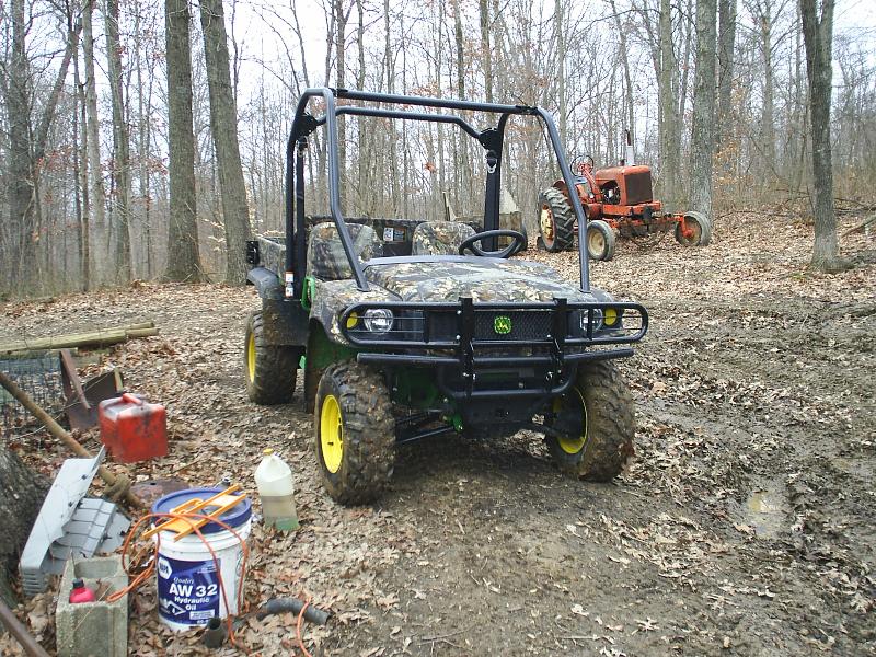

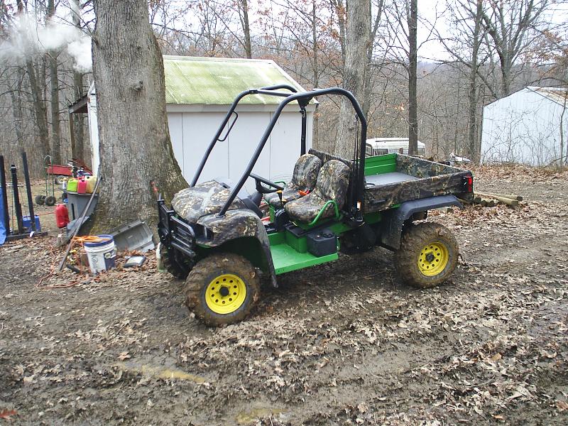

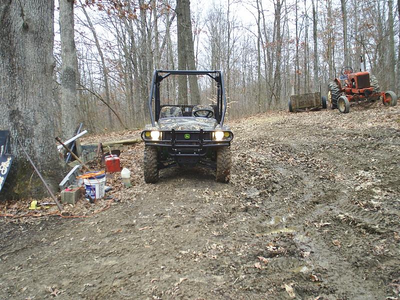

i put brake lights,backup lights,1" lift,brush guard and camo kit on the gator...goin' to order under body armor....already tore a CV boot....next will be a little bigger tires....should i go with 27's?

27" tires are nice; your Gator will have a tough time powering them if you have any real hills and want to go reasonably fast. I run different sized tires in the front and back and that did fine, and going diesel really helped. If you go oversized you might wish to consider a small lift kit; I went 1.5", which seems plenty. In short, going oversized looks good, but your machine will perform better with the gas engine if you leave the tires and wheels the stock size.

i put a 1" lift to the front raised it about 1 3/4"....so you think i should stay with 25's with some meaner tread?...i hope someday they come out with a higher HP chip for the gassers...

Everyone has a different opinion here, so I cannot speak for all, but I can say based on my experience. The larger, more aggressive tires on my XUV get more traction than do the stock tires, by a fair amount. I love them in mud and the winter snow. I like them less in the summer when I am doing a lot of riding on pavement and less work where traction is imperative. A larger circumference tire on your XUV will lug the engine when climbing steep hills or long grades. If you live where it is flat or where the grades are short, this fact might not matter much to you. It did to me. More aggressive tread will definitely help traction, but unless you are running in deep mud or snow or bad terrain often, I do not personally think it is worth changing from the factory tread. The traction might be better, but the ride most likely will not. Despite opinions to the contrary, the stock tires get pretty good traction and ride better than most aftermarket brands. If you find an aftermarket tread that rides and wears as well, it probably will not get enough better traction to merit a change. My dealer, who helped me customize my Gator, frequently puts aftermarket wheels on the machines when he builds them up. Unless someone wants aggressive and oversized, he replaces the wheels but mounts the stock tires as he says he has found no aftermarket tire that offers any better combination of ride and traction for most buyers.

i live in the hills of southern indiana and it's hilly!!!.....we had 12" of snow 2 week ago and it went like a tank!.......after the snow melted i had it back on the neighbors where it was logged in the summer and i was very happy with the way it went in mud it was like drivin' in grease...so i guess this tires aren't to bad....

I have been OOT and just saw your post with a question. The tires are ITP Mudlites. They ride a bit rough on pavement, but get great traction in mud or snow. I Run the 28's front and back but with more narrow on the front to maintain appropriate steering geometry. As for the speed, I cannot answer what my dealer did but he worked with the machine for two weeks to hop it up. I believe it had a new filter, throttle actuator, etc. In addition, the much larger tires will increase top speed by 3-5 mph on flat ground alone, so the engine mods only added about 5 mph themselves. This does not apply to hills, where the gas engine really struggled to maintain speed. My diesel will only go about 35 mph, largely due to the larger tires, but it maintains speed quite a lot better turning those bigger tires. There are also other factors at play, such as the poly top you see in the picture. Believe it or not, they will really slow one of these machines down at higher speeds as they act a bit like a sail. The half windshield does the same, so keep that in mind also.
