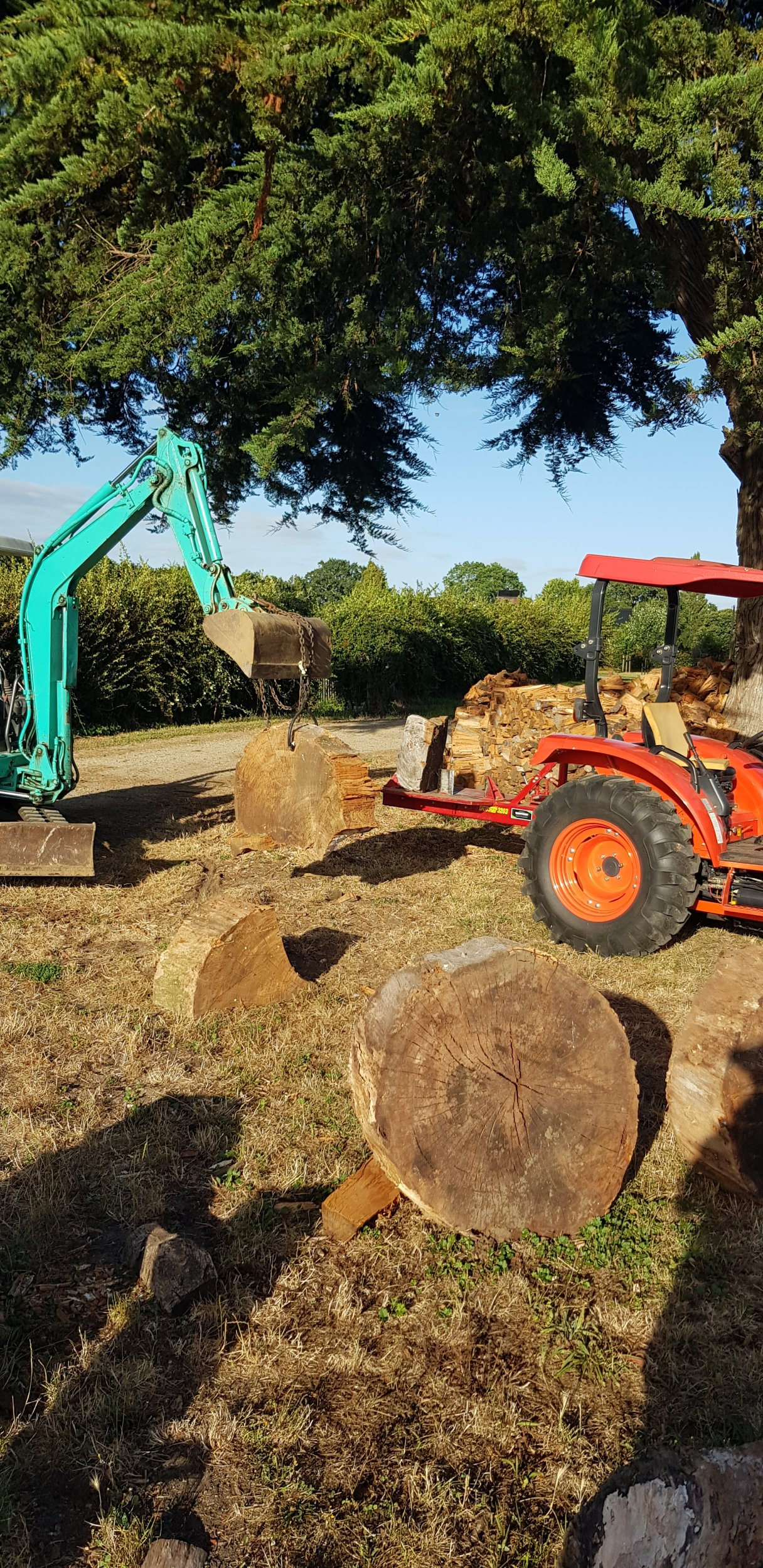

Like you I'm a new member to this forum and have learnt so much from this crew though I'm coming to you from my rural stronghold of 30 acres in New Zealand.
I agree with many that have answered your queries, in that your tractor will become a much loved an appreciated friend, as another contributor put it like your pet dog or chicken. My only advice is ....if you think a 25 hp machine would suit buy a 35 or 40 hp as once you get going nothing beats power. I purchased a new Kioti NX 6210 60 hp tractor for my wee property an it fits like a glove, I love it.
Welcome aboard an best of luck in your search. Cheers Martin
