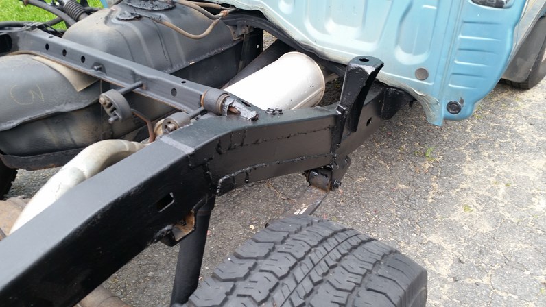

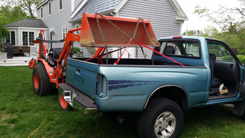

This past weekend my brother-in-law called and told me his truck frame was cracked. He wanted to know if I could look at it and see if it could be repaired. It's a second vehicle for him and he couldn't afford to buy another. Long story short...we repaired it for next to nothing. A flat fish plate capped with some angle...good as new. Oh yea...and the tractor was a big help getting the bed on and off!
