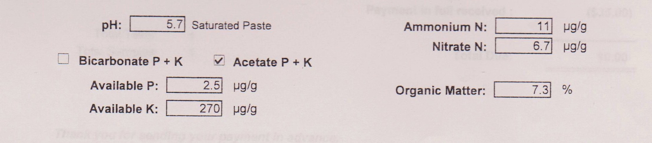

The #s from the soil test are in!!???? soil sample test results 001.jpg I'm guessing the soil is acidic, just as every one thought , will call the extension office as requested by the lab for explanation of findings and report their recommendations

The #s from the soil test are in!!????View attachment 312517 I'm guessing the soil is acidic, just as every one thought , will call the extension office as requested by the lab for explanation of findings and report their recommendations
Yep.. you've got acidic soils. pH of 7 is neutral. Lower values are acidic and higher numbers above 7 are alkaline. You're gonna need to lime it and/or use a fertilizer blend that is sulfate based and provides positive ions (+) to the soil that will neutralize the negative ions (-) that are present in excess with acidic soils.
Regarding overseeding: I have broadcast timothy seed with my fertilizer application in the late fall on my hay fields and have gotten good results with that - new growth and a thicker stand. The key is too allow the new grass enough time to grow and establish a root base that will 1.) provide energy reserves for regrowth after grazing and 2.) strong enough - large enough that horses won't pull the whole plant outta the ground!
That's hard to accomplish with standing fields... you want/need to use the acreage; but, the new plants need time.
The easiest method is to rent/borrow a no-till drill or an overseeder drill. Landscapers and garden supply businesses will sometimes rent overseeders. NRSC offices in Alaska provide no-till drills for rent to landowner's for pasture and hay field improvements.

Got to meet with the Extension Educator, and was very helpful in working out the quantities of the chemicals , to be applied
they punch the size of the field in length x width= just under an acre, then the amount of lime to bring the field back to a ph of 7.0 worked out to just about a ton. The local Co-Op sells the re-usable poly bags of 1000 lbs. of lime so will be picking up 2 of those , the purity has to be near 100% to use those #s or recalculated by %age,
organic matter at 7.3% was ok ,the Ammonium, was ok and also the Nitrate
The K -potassium was also plenty ,actually high, and finally the Phosphorous was low at 2.5 ppm need to apply 30lbs. once a year to this field...to the 3rd year and i guess ( if memory serves -this one lasts for a few years once it's up)
Ok the costs that I have checked - lime 1000lbs. poly bag $143.82 x 2 =287.64+tax=$304.90
