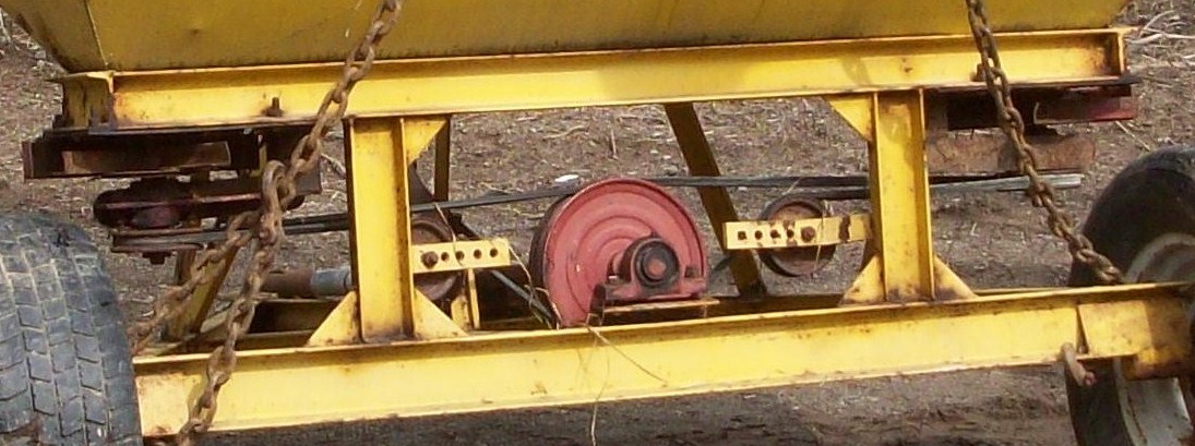

Figured out the problem, with the belt running off the idler pulley on the spreader. See anything wrong with the belt on the right? fertilizer 001.JPG
At some point someone reversed the belt direction on the right side. looking at this picture PTO turns clockwise the lime would be hitting the back side of L during rotation, the left side lime would fall on the inside of the L (as it should) a few other problems solved and its ready to go.

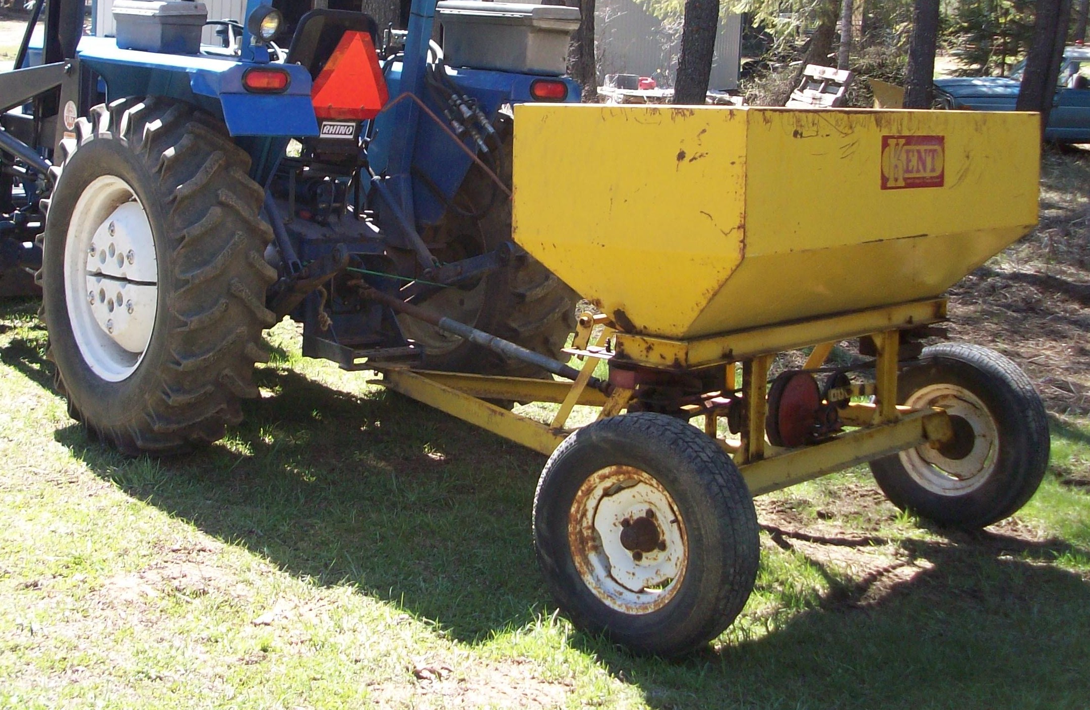

Looked around locally and couldn't find the $3.99 for 40#bags . Gave up and picked up the 2 1000# bags, glad I did to, because they only had 3 and one was reserved for someone else. Still don't enjoy paying retail plus 38%? So got them homefertilizer 010.JPG and got the spreader hooked up and tested fertilizer 012.JPG...so tomorrow going to go for it , and then get it disced in (4-5 inches..)
Still have to figure out the lbs. per acre at mph @ 540 pto (now if I can find the chinese Tractors gear KPH, to MPH conversion):D

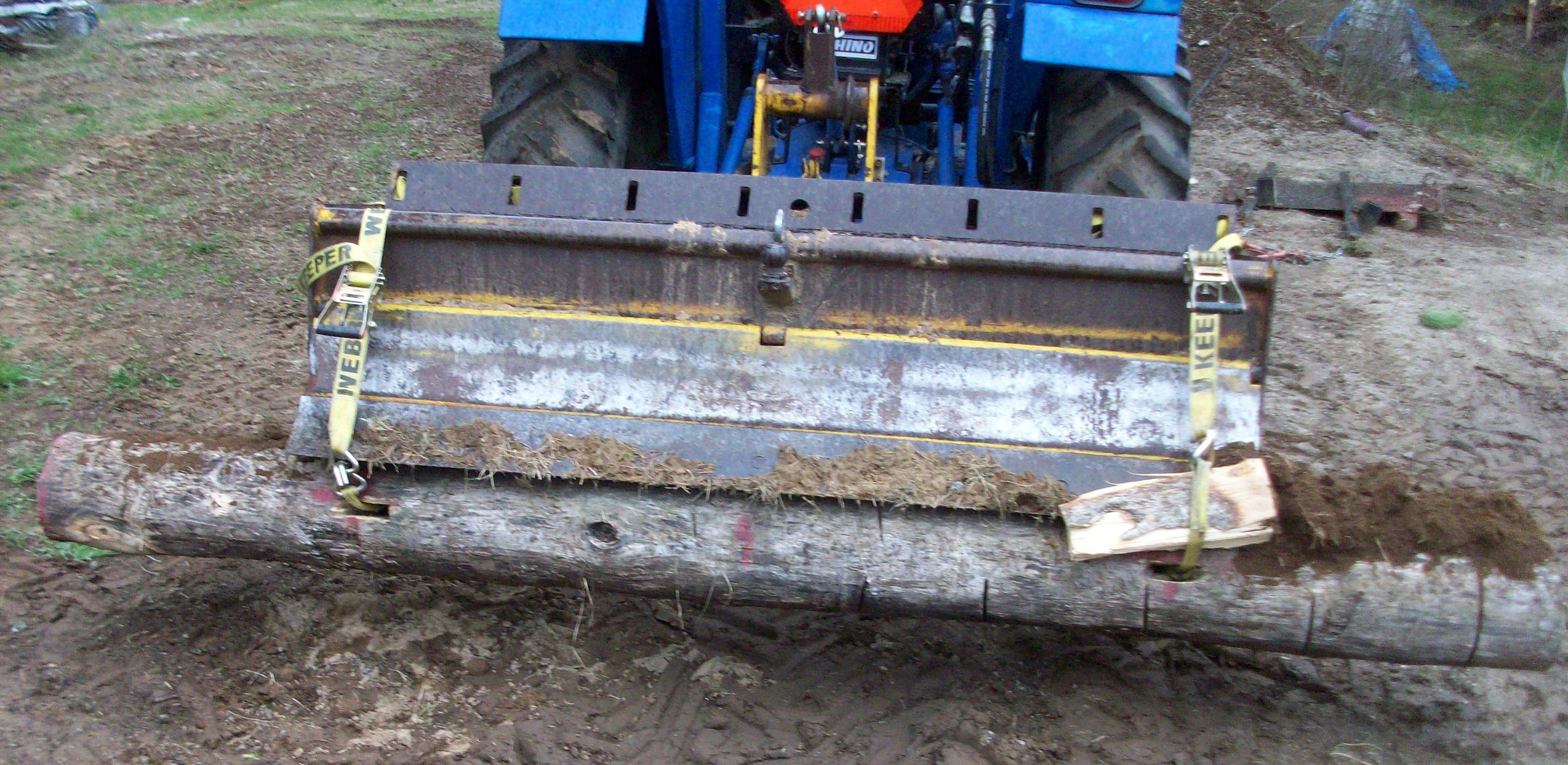

Well my flinstone roller idea got exchanged for a box blade weighted log instead,lime -drag 003.jpgstarted to think the logs weight would not be enough so took this old log ,cut two blade widths on top of each other and then repeated them on the other end. It's kind of (backwoods) with the tie downs and scrap wood as insulators but it works so far
The first lap I just put a little weight on the log (old Gannon -weighs 1000#) and by the 4th lap could load it pretty heavy-the tractor started to hop a bit in 4x4, so just raised the 3 point a little bit getting dark and raining now, but would like to try the draft control and see if it can modulate the pressure... most places I walked on are at about 1/2 inch imprint so still a little ways to go but getting there. going to buy some seed tommorrow :thumbsup:

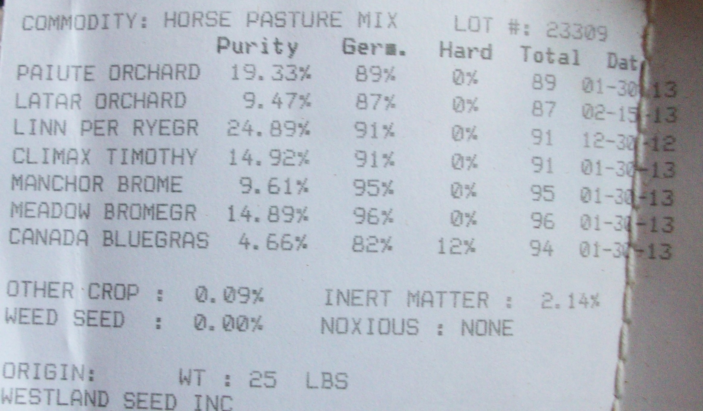

The seed has been picked paid for and now needs to be mixed, We ended up buying a 25 lb. bag of thishorse pasture mix (2).JPG
28lbs. of OrchardGrass Paiute
25lbs. of Climax Timothy.
The plan is to mix the three bags of seed together and use the pto driven seeder. Seeding the main field and then switching to the wifes horse field and then if some seed is left doing the small tilled area also.. the spreader lbs. per acre varies quite a bit depending on which seed is being broadcast.. so it will be an approximation for sure...but by the application lbs. per acre should be plenty.
We decided on the majority seed being the Timothy and Paiute after talking to the farmer we get our round bales from ( he grows his hay about a mile from our place) and the horses love his hay mix and according to him this is what grows best in this particular area..
