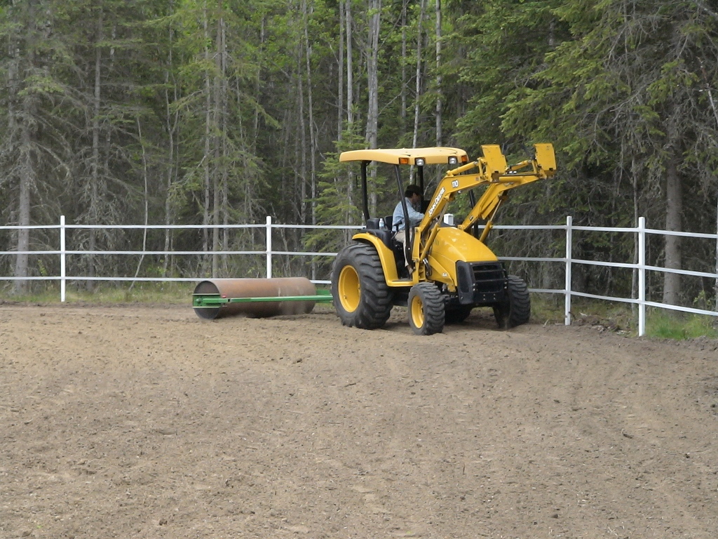

I've gotten lazy in the past about packing/not packing and have even used my 3-wheeler to pack the field. One year, I used my JD110TLB with the hoe off and the loader bucket off and packed a small field that I had rototilled and planted.
The 110 has R4 tires so, they're flatter and not so aggressive and I figured the tractor wouldn't compact things too awful bad... Well, long story - short; got a great stand, good germination - darn horses pocked it up, pulled up the grass, etc. etc. when I turned them into it late in the fall!
So, the next Spring I hand filled in the holes and raked and replanted and rolled the crap outta it with that HEAVY roller. That fall; after the first killing frost - the grass did just fine with the horses on it.

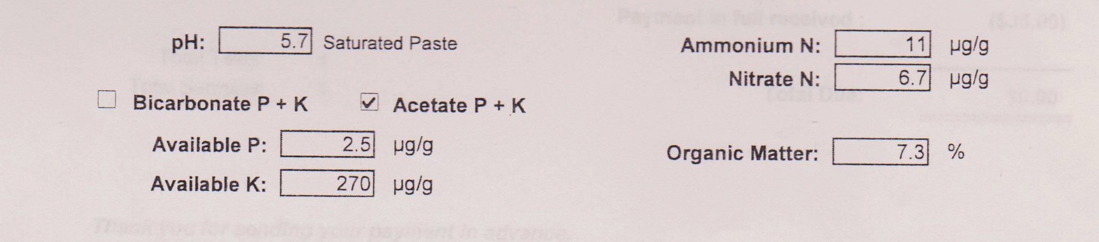

The #s from the soil test are in!!???? soil sample test results 001.jpg I'm guessing the soil is acidic, just as every one thought , will call the extension office as requested by the lab for explanation of findings and report their recommendations

The #s from the soil test are in!!????View attachment 312517 I'm guessing the soil is acidic, just as every one thought , will call the extension office as requested by the lab for explanation of findings and report their recommendations
Yep.. you've got acidic soils. pH of 7 is neutral. Lower values are acidic and higher numbers above 7 are alkaline. You're gonna need to lime it and/or use a fertilizer blend that is sulfate based and provides positive ions (+) to the soil that will neutralize the negative ions (-) that are present in excess with acidic soils.

Got to meet with the Extension Educator, and was very helpful in working out the quantities of the chemicals , to be applied
they punch the size of the field in length x width= just under an acre, then the amount of lime to bring the field back to a ph of 7.0 worked out to just about a ton. The local Co-Op sells the re-usable poly bags of 1000 lbs. of lime so will be picking up 2 of those , the purity has to be near 100% to use those #s or recalculated by %age,
organic matter at 7.3% was ok ,the Ammonium, was ok and also the Nitrate
The K -potassium was also plenty ,actually high, and finally the Phosphorous was low at 2.5 ppm need to apply 30lbs. once a year to this field...to the 3rd year and i guess ( if memory serves -this one lasts for a few years once it's up)

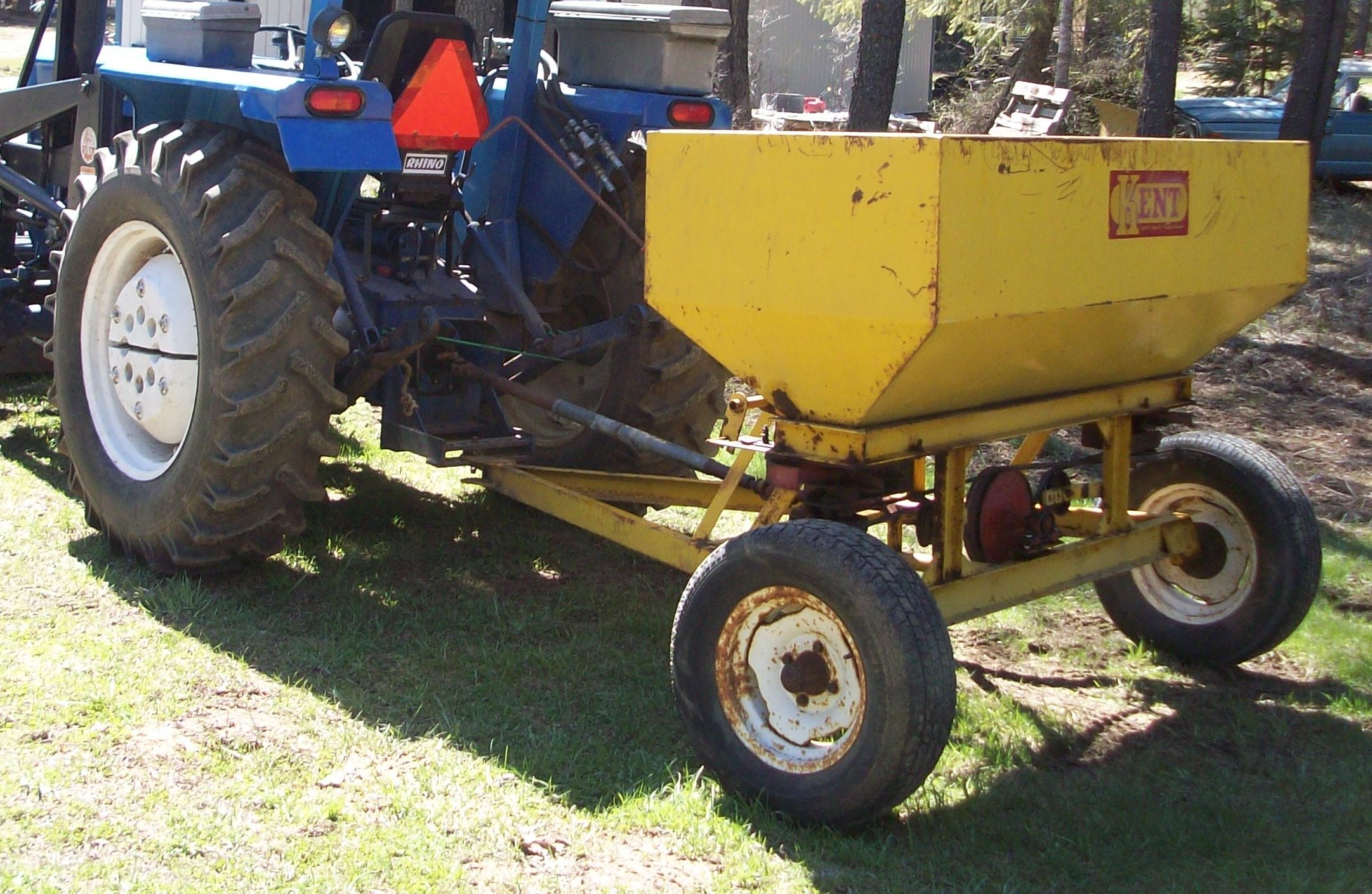

Also picked up the fertilizer spreader from sister (going to need work- flat tire , the pto driven belt drive is heavily corroded and frozen) ,it was getting dark ,need to unload and pressure wash and check it out I believe its a King??

The fertilizer spreader pto was froze solid got it broken loose but when I rotated the shaft in the direction the PTO runs it immediately ran one of the belts off of the idler pulley- will pull it apart , no one knows exactly how long ago it was used :confused: and the drop rate control needs work (bent up and frozen) anyway thanks for the heads up on the pricing - hoping this is not related to geographical location...

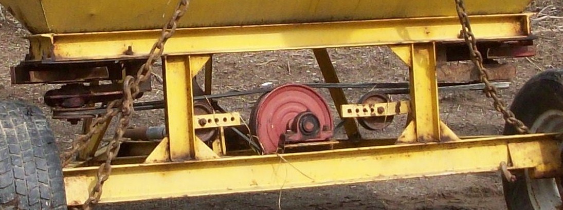

Figured out the problem, with the belt running off the idler pulley on the spreader. See anything wrong with the belt on the right? fertilizer 001.JPG
At some point someone reversed the belt direction on the right side. looking at this picture PTO turns clockwise the lime would be hitting the back side of L during rotation, the left side lime would fall on the inside of the L (as it should) a few other problems solved and its ready to go.

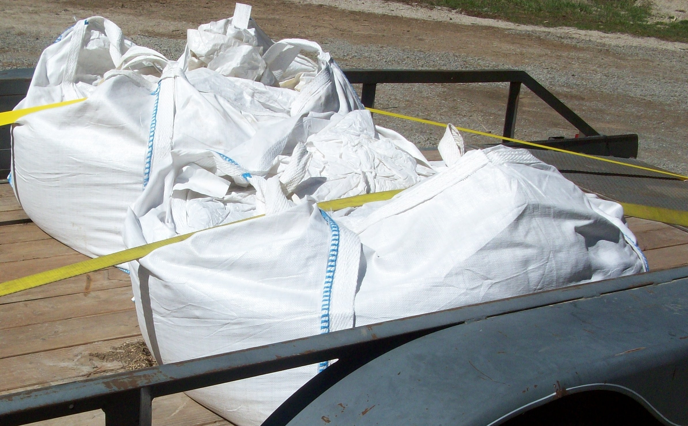

Looked around locally and couldn't find the $3.99 for 40#bags . Gave up and picked up the 2 1000# bags, glad I did to, because they only had 3 and one was reserved for someone else. Still don't enjoy paying retail plus 38%? So got them homefertilizer 010.JPG and got the spreader hooked up and tested fertilizer 012.JPG...so tomorrow going to go for it , and then get it disced in (4-5 inches..)
