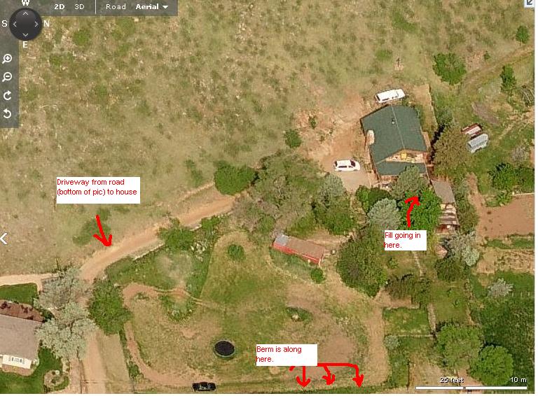

Howdy all,
I've been reading this website for a few months, and lots of great info. Thanks for such a great resource.
I have about 1.2 acres of farm-y land, coupled with 14 acres of mountain-y land that we just bought this spring. I'm thinking I'll need a tractor, but am slow to make such a big purchase... So, this weekend will be the first time we have a tractor on the property to do some long-delayed chores. Renting a JD 3320 (I believe; if not, it's close to that model) with FEL and BB. I'd like to 1) move rocks (20-150 lbs each) 2) neaten up the 300 ft driveway (it is rutted from rainstorms last spring), 3) cut a swale for better drainage across our field, and 4) move dirt from a long berm uphill to backfill an area near the house. (I've attached a pic of the land to this post.)
The last task is most critical (backfill); Then the driveway, then the others. I've read plenty of safety and "how to" info on here, but anything else you think is key (for a person getting on and operating a tractor for first time), feel free to chime in. I have the tractor for one full day.
Here's a couple specific questions:
1) The land slopes from the road where the berm is up to the house. It's probably 150 feet distance and 10 to 15 foot rise. How do you best get a feel for turning around on slope and knowing you're not going to tip over? I don't even want to come close! :ashamed:
2) The destination area needing backfill is tight; I don't think the tractor will fit/maneuver with the BB on. The BB is my rear counterweight. My thought is to move all the dirt as close as possible to backfill area (it's going to take a bunch of 150ft trips) with the BB on... Then only remove the BB for the final last bit of pushing all the backfill into place in the tight quarters. Your thoughts?
3) The driveway is dirt and rock... lots of varied broken rock (sandstone) from the slope I live on. It is solid rock on one side and there is a short wall on the other which serves as a retaining wall to hold the driveway in (mortar and big rock wall... very solid). I'm thinking to make a pass with the BB and see if I can even out the ruts. I'll likely grab some rock mixed with dirt from other parts of property to fill in as well. I know this is not permanent, but it'll serve our needs for now. One option is to buy some half-to-inch sharp gravel/roadbase to lay in, but I don't want to create too many jobs, and I'm under no illusion that this'll be the only time I'll grade the driveway.
OK, thanks for your time and input, and if you need more detail, just ask. This'll be my first time on a tractor, so I figure it's a "learning day", but I don't want to learn any "bad" lessons.

Thanks for the feedback so far fellas. I'll attach here another photo at eye level... it may give a better "person's eye view" of the slope I'm talking about. Not drastic, but not to be ignored. You can see the the garden (lower left corner of picture) has a little 14-18 inch wall on the end closer to us, and is level with the ground farther up, where there is another little wall buttressing up the yard. The tractor will come across the field and garden from the left, and then have to turn up the stone path in the pic, and follow that up to the house. I think it's a good idea to back down from the house, as there is not really room up there to turn around anyway, and then proceed left across the garden and into the field towards the berm.
I'm going to walk it a bunch of times just to really check my route.... slope, rocks and dips, etc. Also, the first time on the tractor I'll just drive it up and back empty, then perhaps do a partially filled bucket a few times to keep getting the feel of things. My focus is to be safe and like I said, enjoy learning how to work a tractor... if there is a hitch in getting the work done, so be it.

Welcome to TBN, PatasColo. Looking at your picture, my first impression is that your tractor will have little difficulty on this hill. It can be difficult to get adequate perspective from pictures, however, so definitely consider your moves carefully while you familiarize yourself with the tractor.

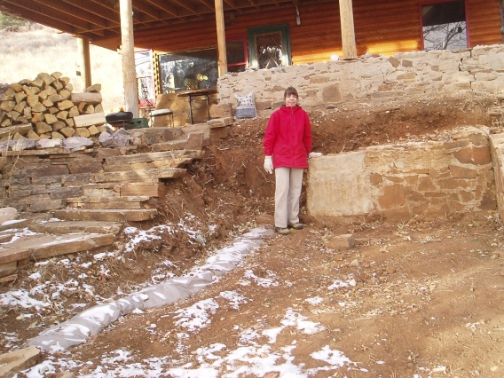

Here's the"Before" pics... the berm (source of our dirt with filled with rocks), the place where the dirt is going, and the mossrock we will put on top (rock garden). We only have to fill the left side and a little on the right, and want to leave the old root cellar wall exposed. That pile of mossrock you see is one of about 6 piles of that size... plenty mossrock to move.

Here's a few "in progress" pics.
First, used the BB with teeth to break down the berm to start... made all the difference. Then, delivering dirt to the site... half buckets had me very happy early in the day (learning to scoop with the FEL). Third, nothing beats having your brother over for some mossrock loading. And lastly, you can see that by evening, I was getting fuller scoops in the FEL bucket.
