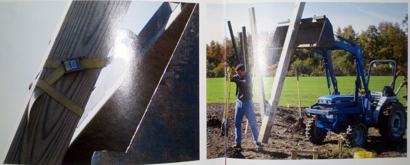

This was how I did it with mine. Sorry for the picture quality, I snapped a picture out of our photo book.
These were 6x6 PT 16' posts. I know it was everything two of us could do to lift, so I'm guessing in the 300# range. I was able to run a tie strap loosely around the beam at about 6" past the balance point, and hook it to the hook on my bucket. I could then curl the bucket and transport the post horizontal till I got close to the hole. Once near the hole, I would uncurl and since the strap was slightly offset, one end would drop down. Then raise the bucket until the post was vertical, re curl the bucket to tighten the strap, and drive it over the hole. I got pretty good on lining it up after a few tries.
The best part about this was if the hole was slightly off, or I needed to make adjustments, I'd just pick it back up, back up a bit, make the adjustments (as seen in the second picture), and reset it. Did this several times.
Obviously, be careful and don't drive any farther than you need to with the post upright.
Good luck with it.

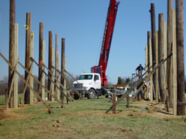

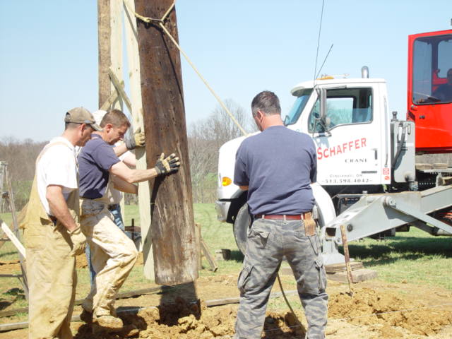

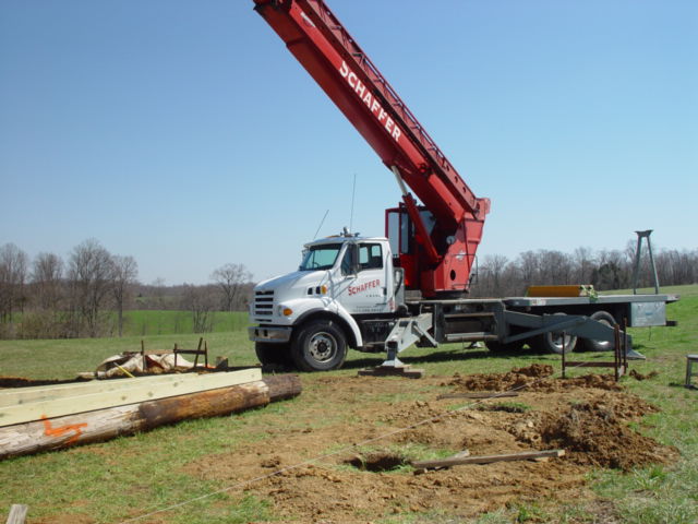

Be very careful. Crane would be best. Pics of mine going in. I need to go back and re-read your post again.
