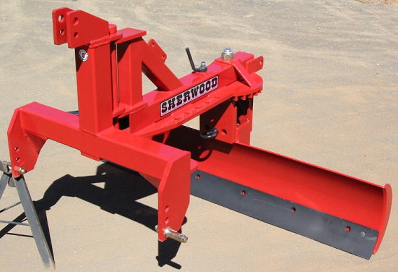

The sherwood grader i posted a picture of before can be moved to the side past the width of the tractor.
