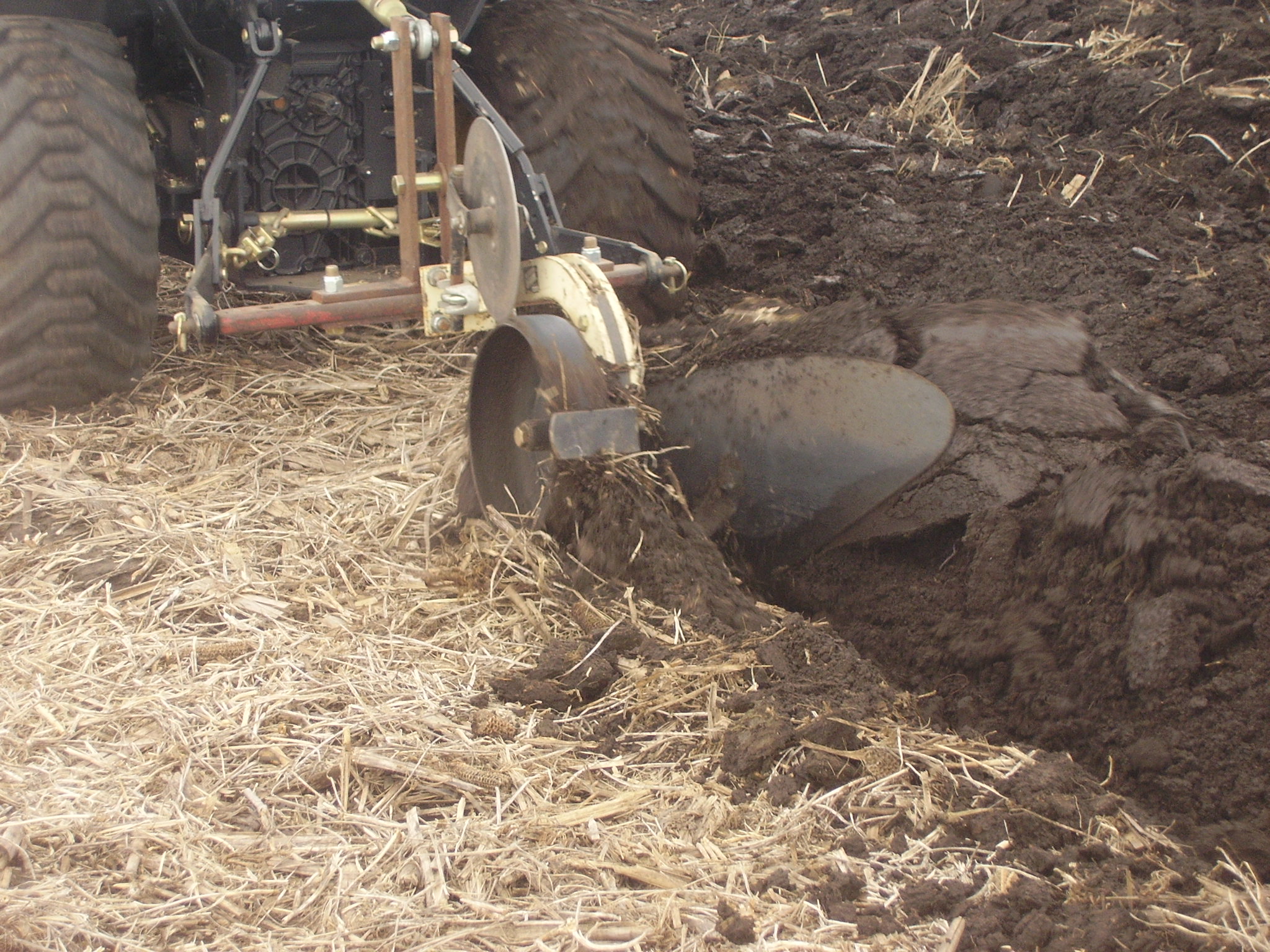

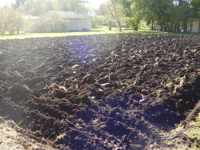

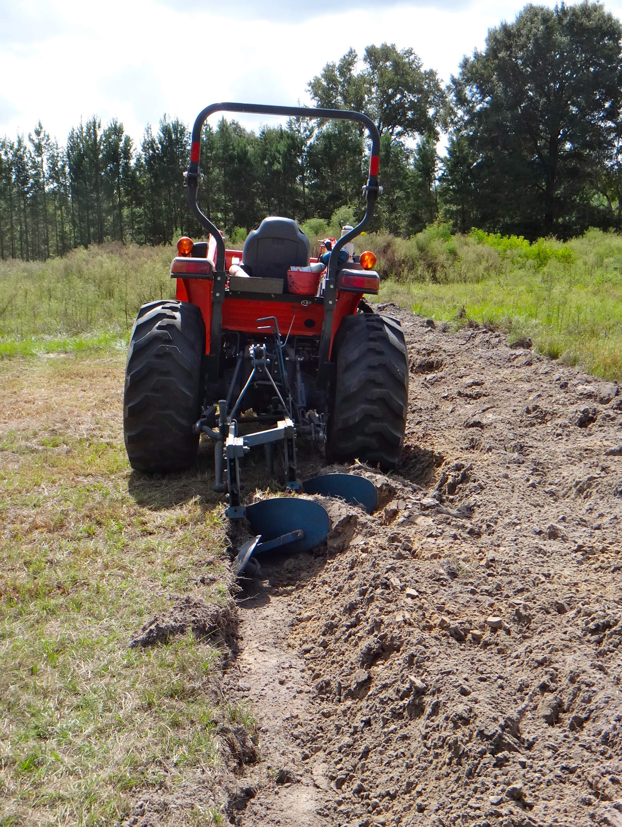

A 12" moldboard plow and garden tractor your size produces mixed results. If everything is perfect, results like the pic below are possible. This was done with a JD 2305 and Brinly 12" moldboard plow.
