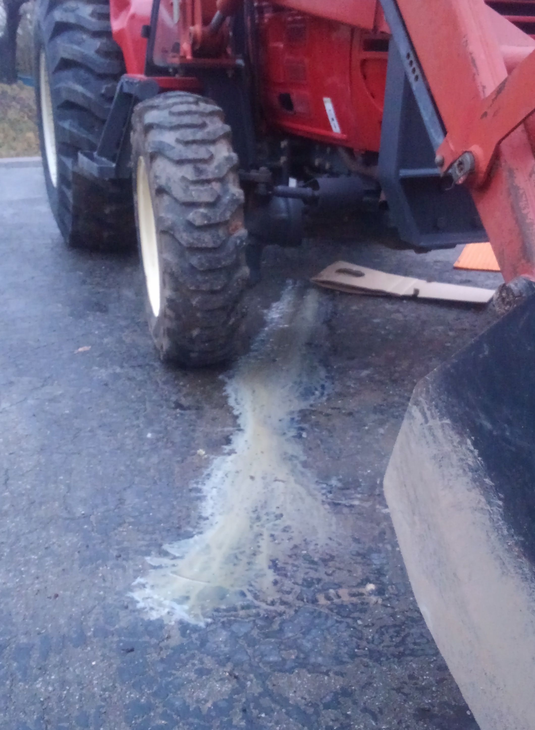

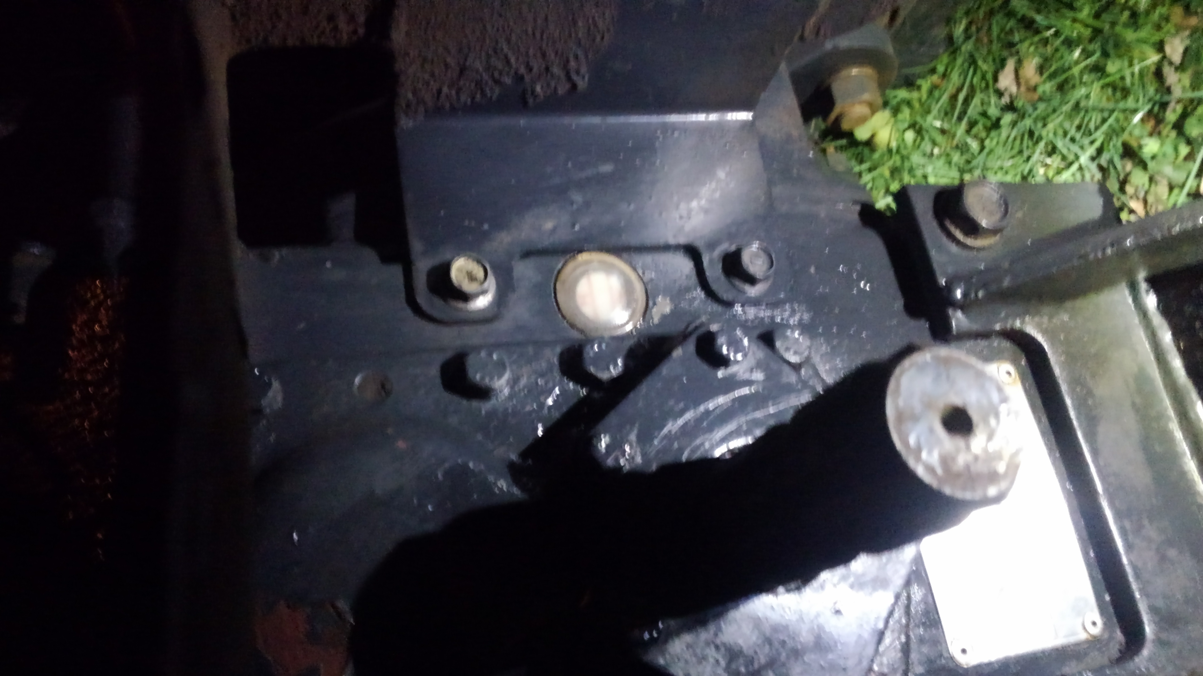

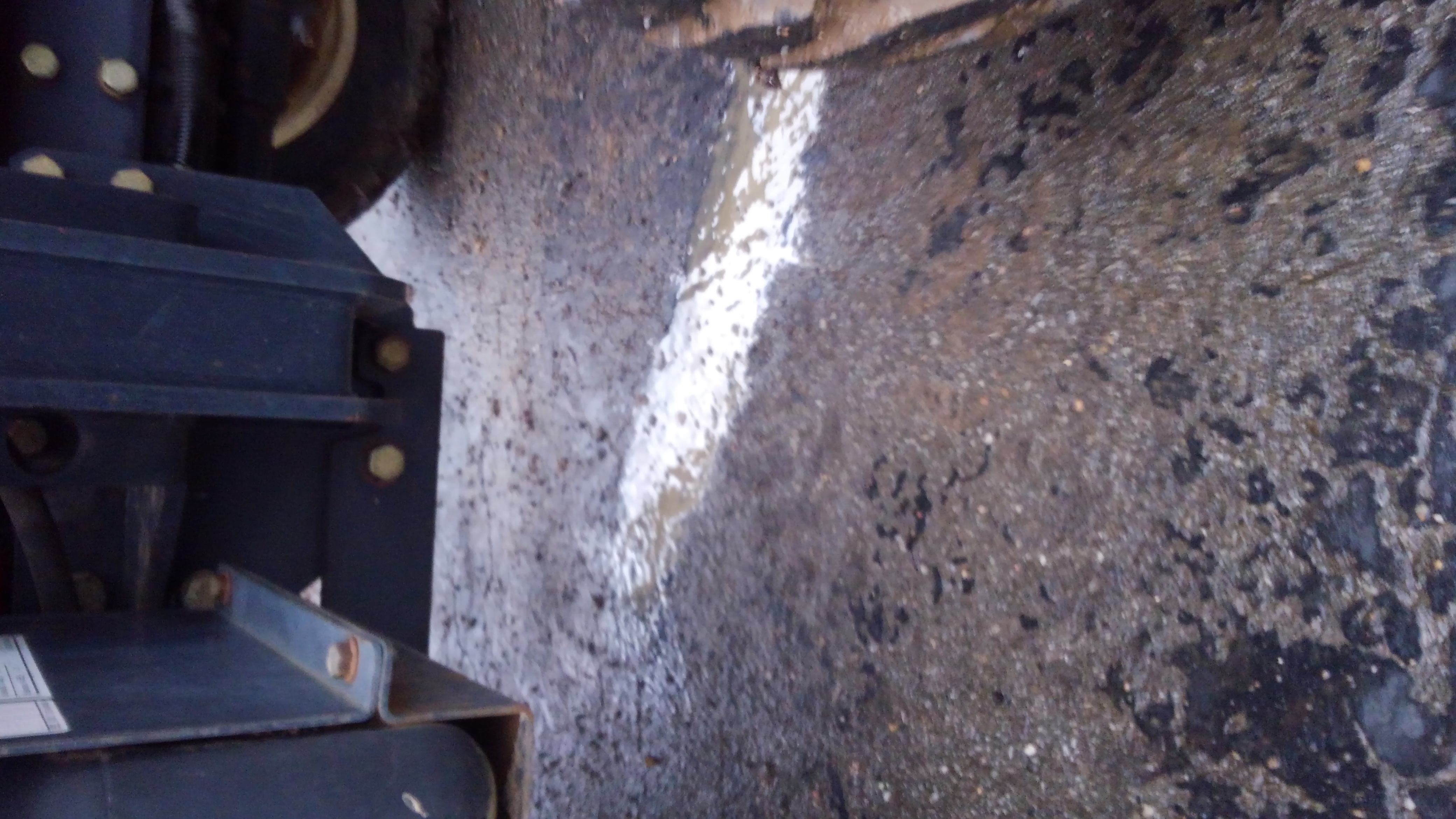

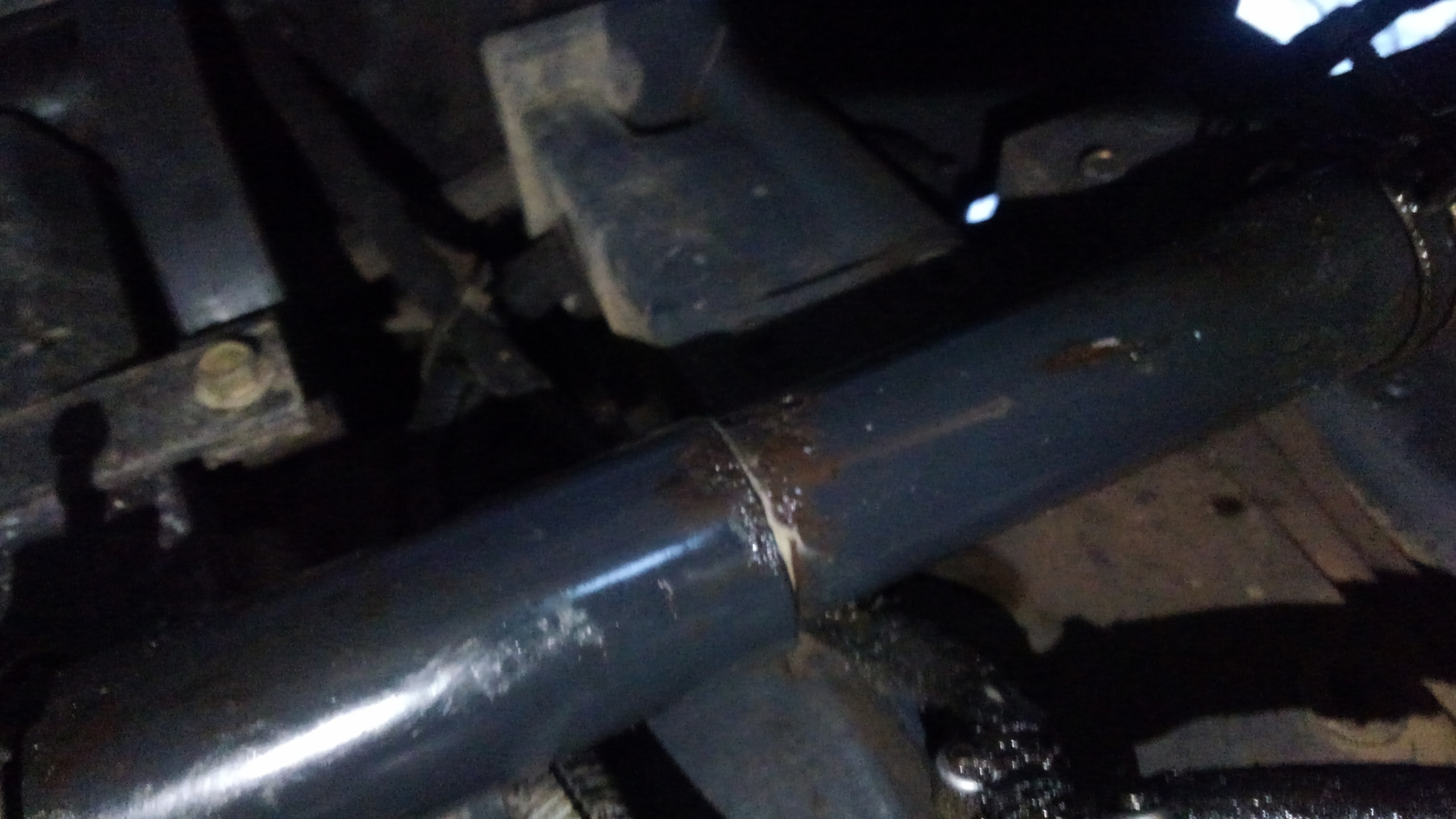

MY QUESTIONS FOR YOU TRACTOR GURUS ARE: See pictures attached pictures
1. Why would this oil pouring out of the drive shaft have that color appearance and could it do longterm damage to the tractor?
2. Is there supposed to be oil in the driveshaft of a tractor? At first I thought the shaft was broken and some goof put a rubber sleeve over it as a bandaid. After further inspection that is not the case. There is supposed to be a joint there and the rubber gasket was wore out letting the oil spill out. But is there supposed to be oil there in the first place?

Looks to be full of water....oil water mix..milky, I would exercise your warranty....Id return the tractor if I could.....

I agree with grm, looks like water and oil mixed. That’s never a good combination for any kind of machinery. If you can return the tractor I would seriously consider it. If they won’t let you return it for a full refund then I’d make sure that the dealer changed ALL oils and filters on the tractor.

There’s water in the oil. I’d guess there’s supposed to be a seal to keep oil out of the driveshaft tube and the rubber boot is a dust seal. A flood sale might be jumping to conclusions but I do agree getting out might be a better plan. Just getting the water out will be expensive. Adding in the seal change which will vary significantly in price depending on how it’s designed and you’re getting pretty expensive. What transmission is the tractor? If it’s a straight shift the shifter boot is a likely source for rain to get in the oil.

1. As others have said, that's what an oil and water mix looks like. Sort of milky. You've described it well.
2. No, there's no oil in there, just a 2" or so steel tube that shields a driveshaft that takes power from the the front output flange of the transmission and connects to the input flange on the center of the front axle differential. The shield can be one or two pieces generally connected together with a rubber boot.
Although there isn't normally any oil in the driveshaft shield, there is oil in the transmission and front axle. And there is an oil seal where the flange enters the transmission and the same thing at the front differential. It sounds like one or both of those oil seals are bad. That happens when 4wd is used a lot. It's common on used tractors and doesn't mean anything most of the time. If the seals can be replaced without opening the tranny or front axle then replacing them is maybe a 3 or 4 hour job at worst. If there is a U-joint on that driveshaft inspect it at this time, too.
2 1/2. What really matters is where the water came from. With a torn boot it could be that there is no problem at all and the water came from the DPO (Dread Previous Owner) doing FEL work in a creek or being maybe the tractor/trailer was towed through a heavy rainstorm. Or it could be just that the dealer gave it too aggressive of a power washing when he got it. He might have even caused the leak in the boot and not known it. It does look kinda soapy. Most water in oil looks more like chocolate milk and not so soapy. BTW, crappy oil & water won't hurt anything in the front driveshaft itself. After all, most driveshafts are open on cars. The only thing to lube in the shield tube is a U-joint if it has one and maybe some sliding splines. Degraded oil won't hurt either one.
But, there is a chance the water in the oil is in the transmission or front axle. Either one could lead to a bunch of problems that can take a year or more to surface. So If the dealer hasn't picked it up yet, be SURE to check the transmission oil and front axle oil for water. Maybe pull out a few ounces of each and label them. And take some good photos of the boot.
You be sure to check those oils too.
3. Mad?? Depends, read the paragraph right above. THere's a decent chance he didn't know about it, even though it is real common for tractors to leak a little bit there. Some do and some don't. I once bought a 30 hp used tractor that didn't show a sign of a leak there until a month had past and by then there was enough oil in the tube to start flowing out. My guess that time was that the DPO probably knew about the leak, but he had swabbed it out guessing that I wouldn't notice until it was too late to tell who to blame. But maybe he really didn't know.
As to how mad to get, it depends on how the rest of the tractor is working. If it's a nice tractor with a bad boot and decent driveshaft seals I'd let it pass. It really depends more on if the oily water is in the front axle (common in creek work) & might be OK or not depends on how long it has had water in it. Or if there is water in the oil in the transmission - which is very, very rare and would also mean that the hydraulic system has water in it - in which case you probably don't want the tractor.
Either way, get a warranty extension. Used warrantys typically start over at zero time if work has to be done. And time at the dealer doesn't count.

Your dealer will check the oil levels on your tractor trying to find what is losing fluid. Could be a seal somewhere or another.
When I look at the 3rd picture you posted things don't look right with the small hoses; maybe one of them is rubbing against the driveshaft and has worn through which should be an easy fix.

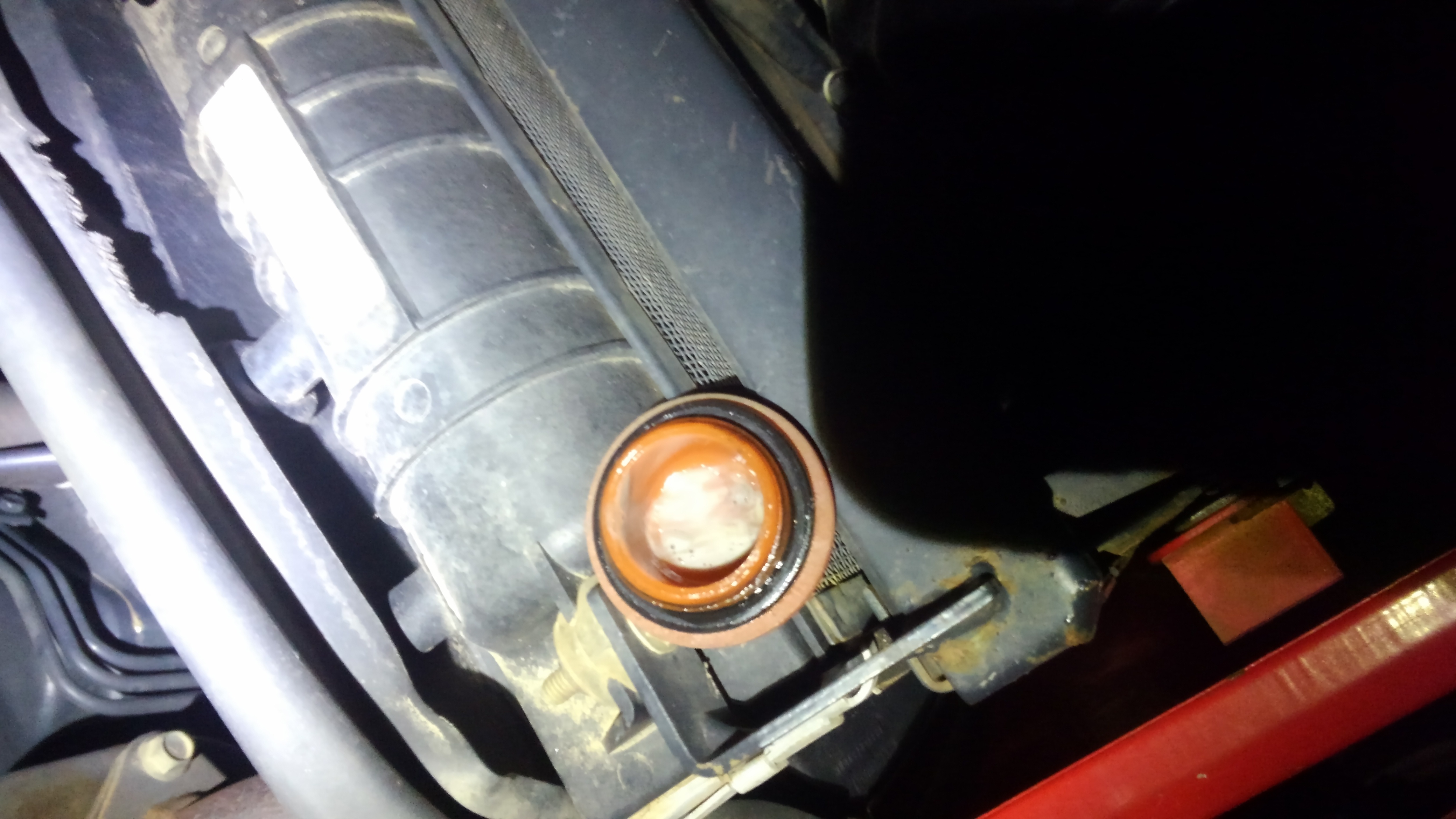

Doesn't look good. Checked the rear oil sight glass, it is milky white. Front oil filler cap has milky residue in it (couldn't find sight glass at 7 this morning). Let's see what this dealer is made of. I hope and pray he is a man of his word.
