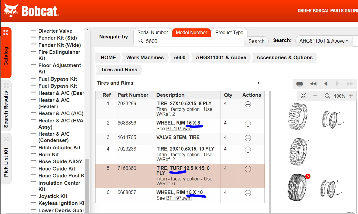

Ruffdog, thanks for the response. Are you saying the 29x12.5-15 tires likely won't fit on my current rims?
/ First Post - 2015 5600 Toolcat #22
The 27" and 29" industrial tires use a 15x8 wheel while the bigger turfs use a 15x10 wheel. As stiff as these turfs are, I think you need the wider wheel.
/ First Post - 2015 5600 Toolcat #23
For this type question you can also check the parts list:
Bobcat Genuine Parts Catalog – Official Bobcat Company site

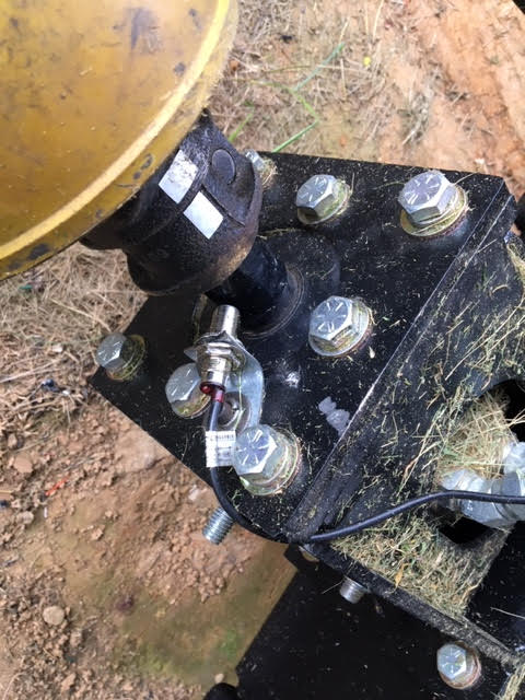

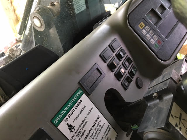

#27
Added an RPM sensor to the hydraulic PTO to ensure I was running the implements at the correct speed. A few pictures of the sensor installation, and the digital display. This particular setup requires I run the engine speed at 2300 RPM to get a 540 RPM output with high flowing on. I was previously running it at around 2100 RPM which was good for an unloaded PTO based on my hand held RPM meter, Pretty happy with it so far.
/ First Post - 2015 5600 Toolcat #28
View attachment 615916View attachment 615917

/ First Post - 2015 5600 Toolcat #29
Is this PTO on the rear or front? Is it set up to run 3pt equipment? The rpm's on my rear pto on the 5610 will show up on the dash. Your rpm figures are close to what I have found too. Get a picture of what you are running...good job!
#30
This is on the front, I've got a 5600 and I'm using an Eterra 3pt PTO adapter out front. I really wanted to mow with my 94" finish mower out front, and the same with the snow blower. It's a good bit of weight out front, but the toolcat handles it well. Switch to all terrain truck tire gave me the traction I really need. I'm running GM rims with the tires only inflated to 20lbs or so. Gives a very good contact patch, and doesn't hurt the grass. We'll see how it does in the snow this winter.
