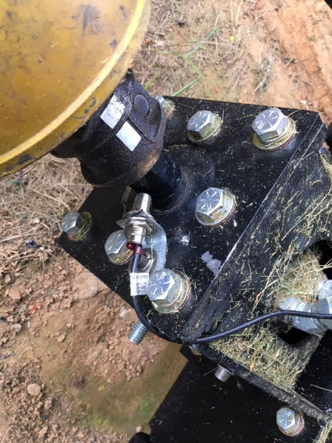

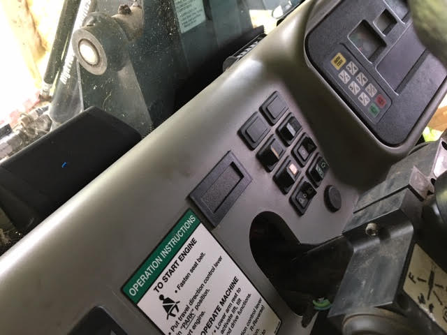

#27
Added an RPM sensor to the hydraulic PTO to ensure I was running the implements at the correct speed. A few pictures of the sensor installation, and the digital display. This particular setup requires I run the engine speed at 2300 RPM to get a 540 RPM output with high flowing on. I was previously running it at around 2100 RPM which was good for an unloaded PTO based on my hand held RPM meter, Pretty happy with it so far.
/ First Post - 2015 5600 Toolcat #28
View attachment 615916View attachment 615917
Nicely Done.
DEWFPO
/ First Post - 2015 5600 Toolcat #29
Is this PTO on the rear or front? Is it set up to run 3pt equipment? The rpm's on my rear pto on the 5610 will show up on the dash. Your rpm figures are close to what I have found too. Get a picture of what you are running...good job!

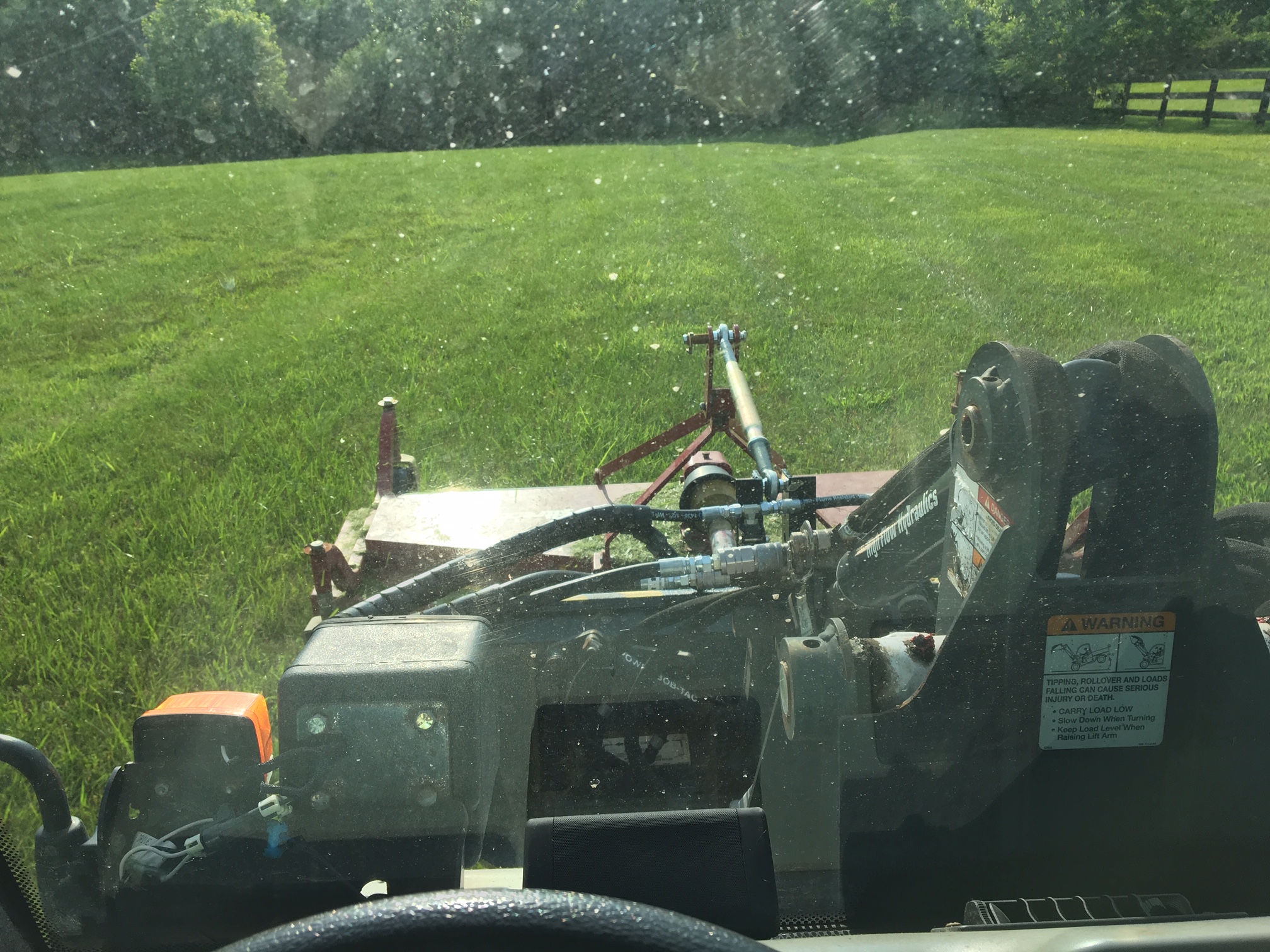

This is on the front, I've got a 5600 and I'm using an Eterra 3pt PTO adapter out front. I really wanted to mow with my 94" finish mower out front, and the same with the snow blower. It's a good bit of weight out front, but the toolcat handles it well. Switch to all terrain truck tire gave me the traction I really need. I'm running GM rims with the tires only inflated to 20lbs or so. Gives a very good contact patch, and doesn't hurt the grass. We'll see how it does in the snow this winter.

Well, not too much to say on the wheels and tires. They are stock GM wheels off of a 2500, with AT type tread. They have much better off road performance, and I'm guessing on road compared to the R4s that were on it. They float much better in muddy conditions to be sure, as the contact patch is quite a bit larger. I'm guessing snow performance will be better too, but we'll see. I'll get some chains for them and I'm guessing it will be almost unstoppable after that. I had to use spacers on the wheels to evenly mount them due to the center ring on the toolcat's hub.
Otherwise she is working very well, mowing 11 acres or so nearly every week right now, pushing a 94" wide sitrex finish mower. It's a rear discharge deck however, which is fine when the grass is normal length,but pushing it into 12" tall overgrowth is no go, driving backwards into it however, which puts the mower in the correct orientation works just fine like it did behind the tractor. I'm thinking of opening up the sides of the deck for side discharge as well, but we'll see.
