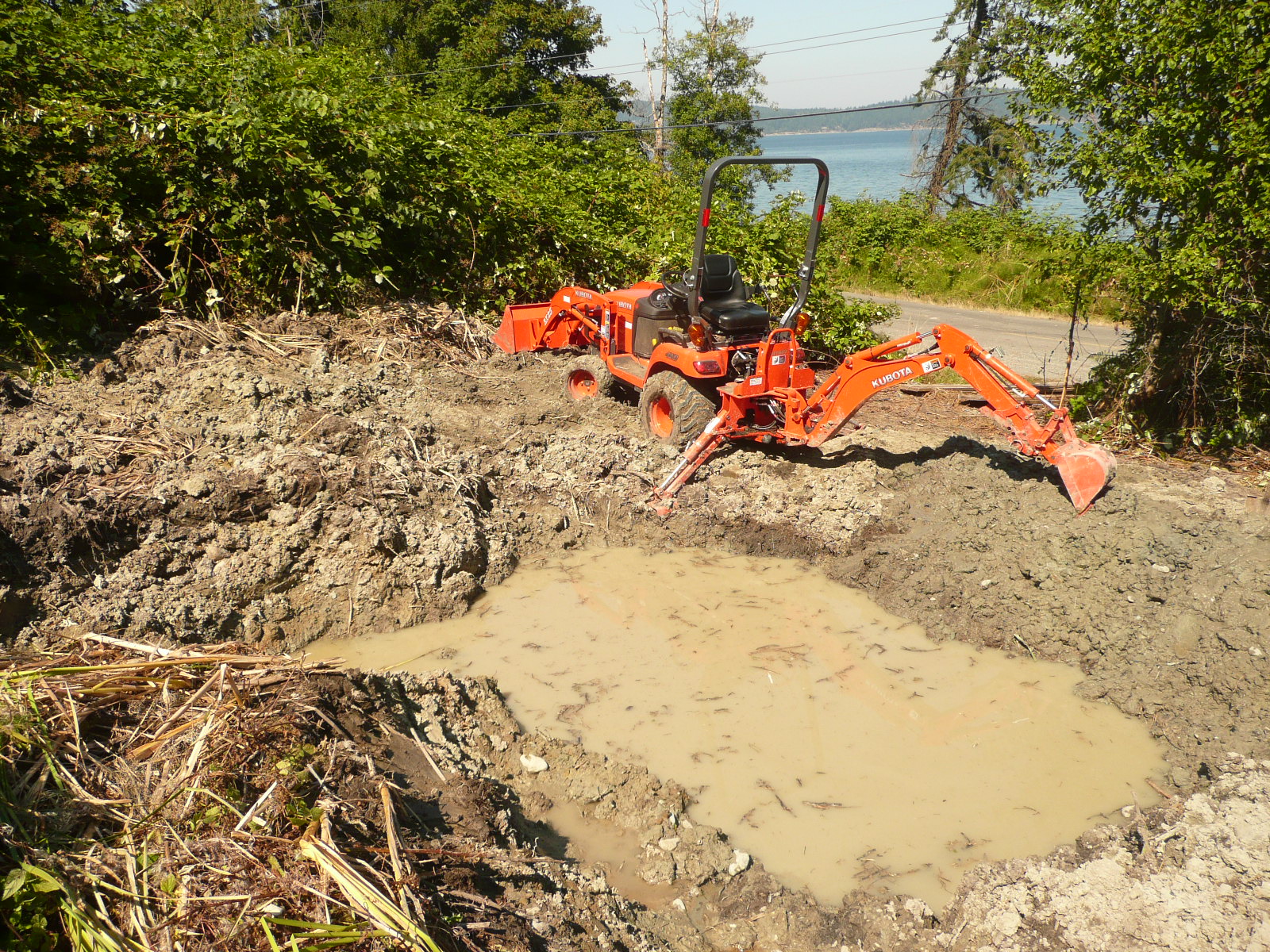

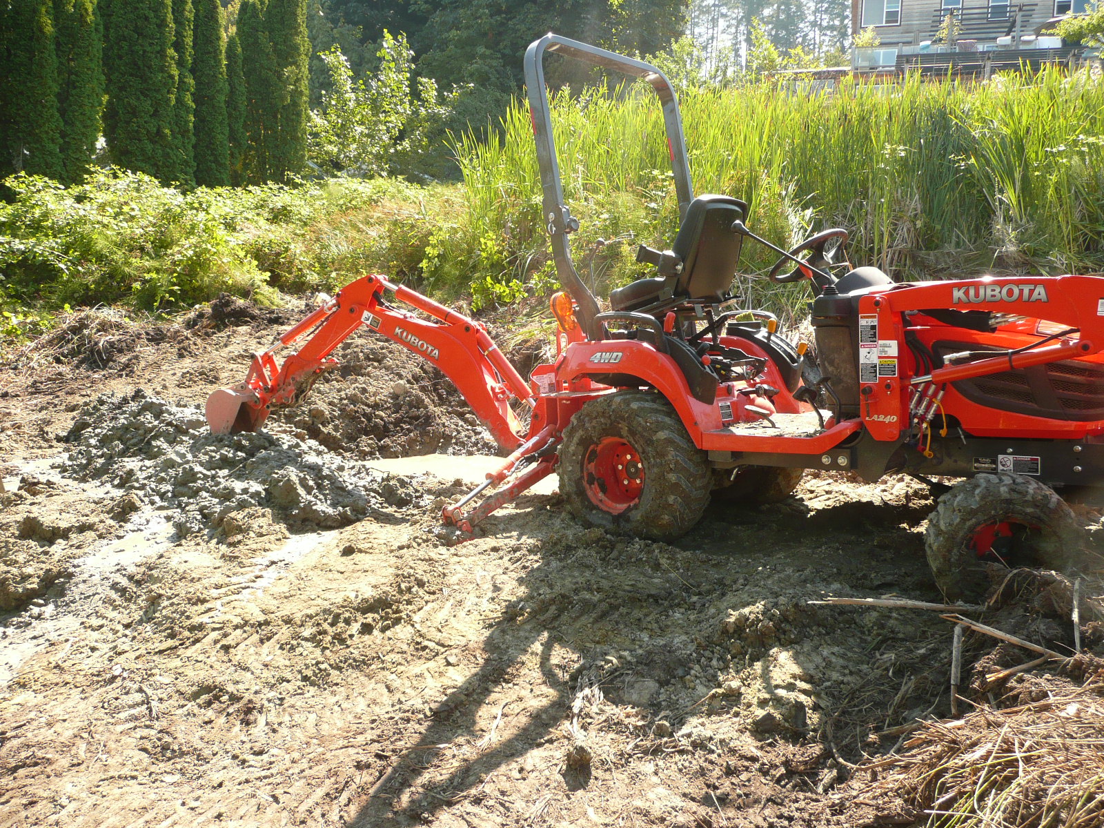

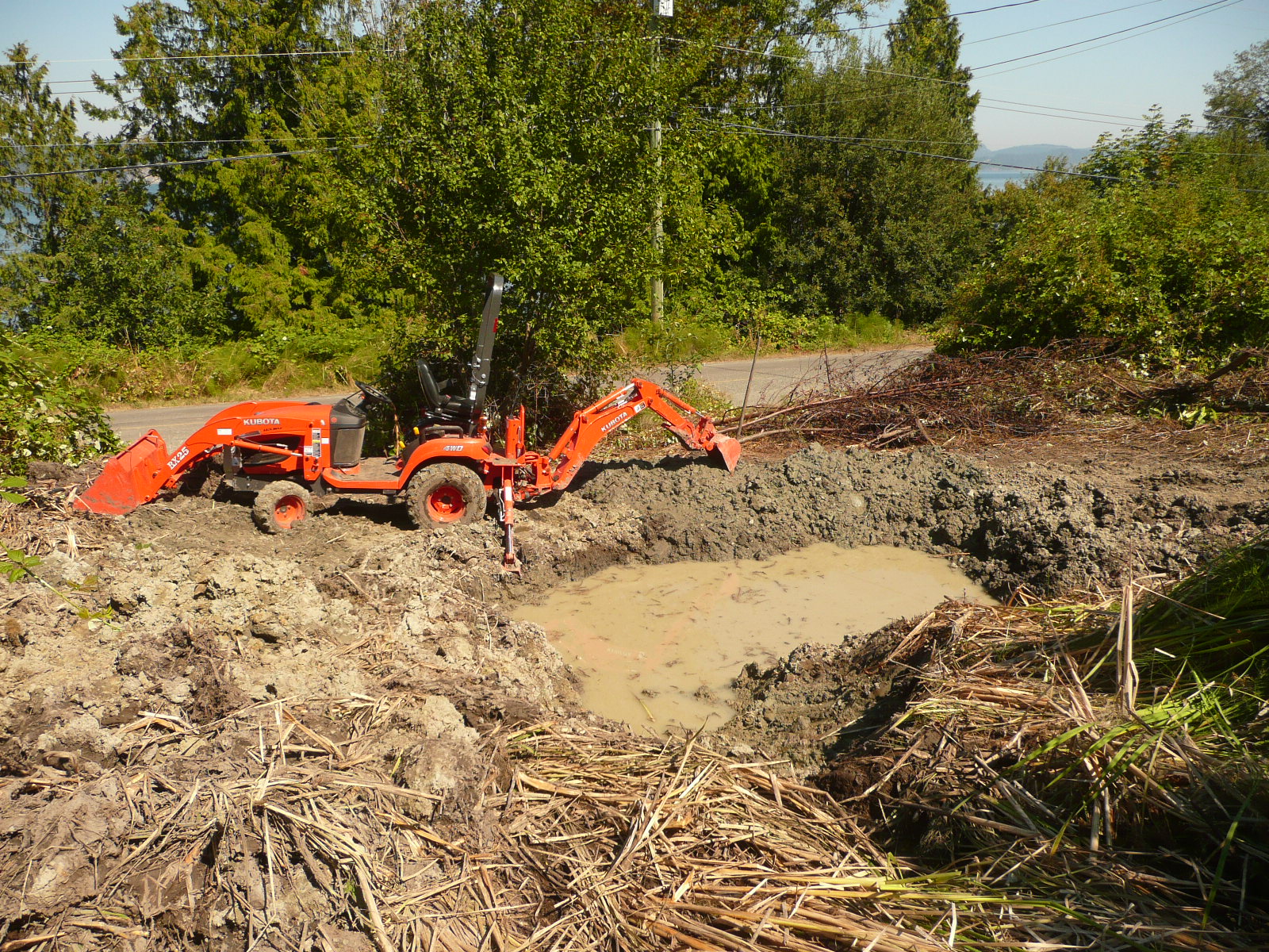

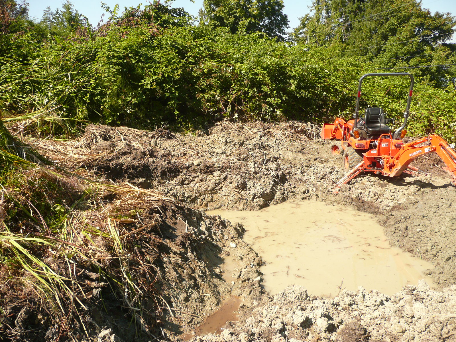

Just thought I would post some pics of my new pond. Second big project (first was a drainage ditch) and 1st pond with new Bx 25. It has not been easy due to the wet sandy clay that filled the bucket with gumbo. It does not look like much but it has been a big learning curve. Lots of time was spent moving material away from the hole. It may not look like it but it's about 2 ft - 3 ft deep. I will be putting a jet pump in with a pressure tank next to the pond. Need one spot that will be deep enough to have the foot valve in a plastic tank wrapped in landscape fabric. Had to quit this afternoon due to a loose hydraulic line on the backhoe. The machine has worked very well. Very fuel efficient. Still trying to get used to feeling like it's going over. I'm sure it's fairly stable but every once in a while the real wheel will go into some soft wet dirt and it wake one up. Question of the day; is better to try and jump off or ride it over if it does roll. I have not been wearing the seat belt and have been betting on going over the top side. It's probably better to buckle up and ride it over. Not that I'm a dare devil and pushing it to the limit but it's all part of the learning curve.

Rolling over into a pond full of water belted in you could drown.. unbelted you could get pinned under the ROPS at the bottom of your starter pond, and drown.. best to make sure it doesn't happen.
I think I'd be renting a big ole excavator to finish up the digging of your pond. Think of the fun you can have in a week with a 20k ex. ;)

Looks like somebody made a really big pond across the street, maybe the guy who dug that will help you. I admire your grit, looks like a pretty tough slog. I'm with the other poster who suggested renting a big machine for a day.

Looks like that stabilizer pad is sinking awfully deep into the bank there. Might I suggest some sheets of 3/4 plywood to spread the weight out and reduce the tendency to collapse the edge?

I wonder if you could just back down the slope into the pond to keep the BX level side to side. You'd wind up doing a lot of repositioning, but at least it would be safer. Another thought would be to get a trash pump that could pump most of the water away until the pond is done. That would make it a lot easier to scoop out a productive scoop of dirt rather than a sloshing backhoe bucket of mud and pond water.

I personally will not wear a seatbelt when operating a backhoe. Its too dangerous in IMHO. I'd rather be able to jump off or be able to move in better position as it rolls over so I can shut off the engine. Shutting down the engine is the number 2 priority after being safe.
When digging that close in water, you might want to be 60-80 degrees to the bank so you can dump the dirt but still be able to slam down the BH if you start tipping in to the water. You'd be able to crab your way out with FEL and BH if you ever slid in. When you are pararell to the bank, its just an open invitation to a rollover. :( Then you would have hard time crabbing out.
Just like the other poster said, use a trash pump if you can get it to your island to make digging easier.

Thanks for the tips. Going to put in a pump system this week and drive the water up to a dry area.

How deep is it? Is there going to be a lot of run off going into it? If so you'll want to stop the dirt from filling it back in, untill you can get some grass or whatever around it. Is it deep enough to keep water weeds from taking over{cattails etc}? Are there any springs feeding into it?

20 20, I betcha its anywhere from 4-6 1/2 ft deep with average depth of 5ft. That is pretty much the limits of BX BH reach.
islander, what are you planning on doing with the pond ? have fish? place for fresh water to go? You said you plan to put in a jet pump next to pond. I assuming maybe a water fountain?

If this is as big as it's going to be, then I'd say you're right.
For a larger pond, assuming he had a way to keep the water out, it would've made more sense to dig his way into & out of it with the FEL and a TB.
