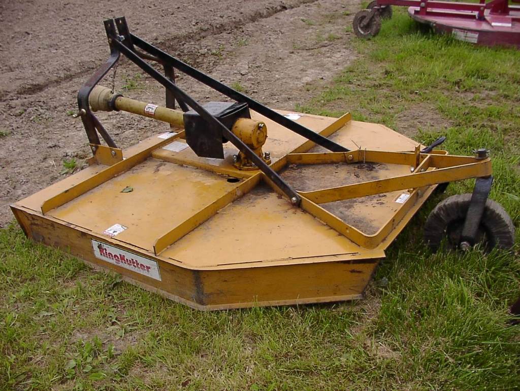

I finally got a chance to take a picture of my King Kutter. This is the second year I've been using it. I clear about 50 acres with it, and when I first cleared them, they were pretty rough, lots of samplings, bramble, briar, etc. My KK has held up very well, and I'm real happy with it.

Hey Rich:
Do you have any problems with the toplink pin hitting either of the lift arms that run from the toplink down to the deck of the cutter? I have decided that I am going to keep my Kingkutter, and have made the necessary mods to make it work properly with my 2710. Boy does that cutter make a mean menacing hum when the PTO is engaged. It is kind of scary. I am going to use it for the first time this weekend. Do you have any tips of techniques when using it?

Jason, I don't have any trouble with the top link. If you look at my picture, youll see I attached the toplink hooker upper thingie to the bottom hole. That works well for me, and I've had no problems with it. I hope that helps.
As far as tips for operating your KK, just the usual safety concerns for operating any rotary cutter. I've NEVER had any problems with it, and I give it VERY heavy use. Good luck, I think you'll really enjoy it, it's a great unit!!!

/ First Choice Vs Kingkutter #59
Rich, I see you are using the check chains from the deck to the tractors upper 3-pt connection area. How is this working for you? I have done this on both my Woods' RFM and brush hob and find it the only way to go to get a level cut.
/ First Choice Vs Kingkutter #60
Duane, I use the check chains all the time with my brush hog. It keeps it nice and level, and I never have to worry about it.
My finishing mower has four wheels, so I never use the check chain on it, the wheels set the height. I don't raise the finishing mower at all with the 3ph.
