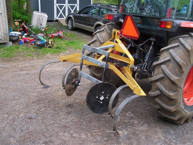

Spring tooth harrow/cultivator.I added a couple of bolt on disc for the garden rows ;easy removal.

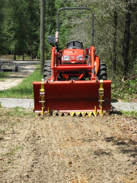

/ First attachments #11

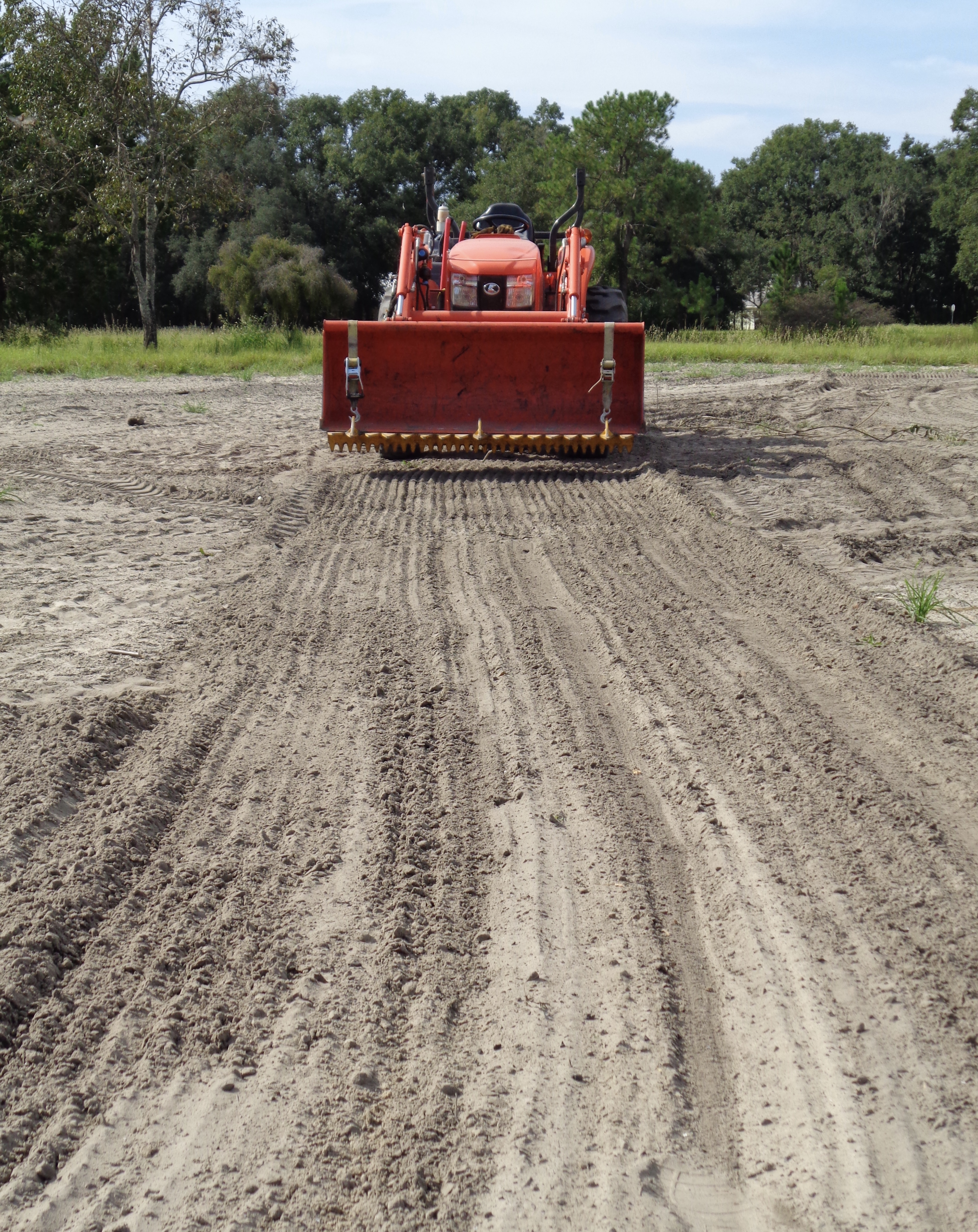

Box blade. A box blade angled and dropped so you're just using the scarifiers can do a fair impression of a chisel plow. Just pay attention, as there's no shear bolt, trip spring, or other damage prevention device besides the one between your ears. In areas where you know there's a lot of debris to turn up, lifting all but one or two shanks may be prudent.
Not as cheap as a middle buster, but is hands down one of the best jack-of-all-trades attachments.
Depending on seeds, you can then either tractorpack, backdrag with the bucket, or a ratchet rake.
