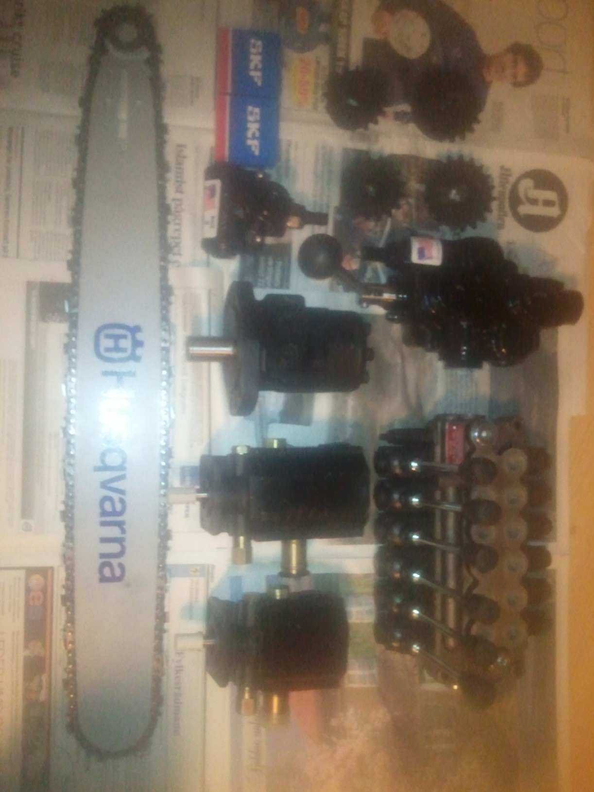

Hello everyone. I'm pretty new to the forum, will apologize if anything I say makes no sense since I was not born English speaking. well I have quite a long time played with the idea of building a firewood processor.
Really liked the splitting wedge to this machine. But would rather go for a chainsaw bar and chain instead of blades, what do you think?:) Sending a picture of the parts I have gathered. Since I do not have a work place other than mother nature, Eeverything depends on Temperature if I get something done soon. I am planning what I need, ordering parts and scratching my head for now.

welcome to tbn. you english was fine. looks like you have a start on some parts, hydrolic valves and motors, saw bar/chain. sounds like a very interesting project. i wouldn't mind having a firewood processor myself as i have a small firewood business over in the united states. compared to a firewood processor i do everything the hard way. good luck with your build and keep us updated and pictures are nice.

Did you check the commericial manufactures sites? I see you have chosen a Husky chain bar. Is it the strongest grade that can be bought as the bar is going to be running for many hours. There is a grade of chain called ( Harvester ) that is used in forestery machines.

Bar is 24 "bar and chain is the toughest quality I could find. Here in Norway the saws ar just called husqarna, and those who truly love them mostly call them with the woman name Erna. Had planned to make a clutch system, so chain only runs when necessary

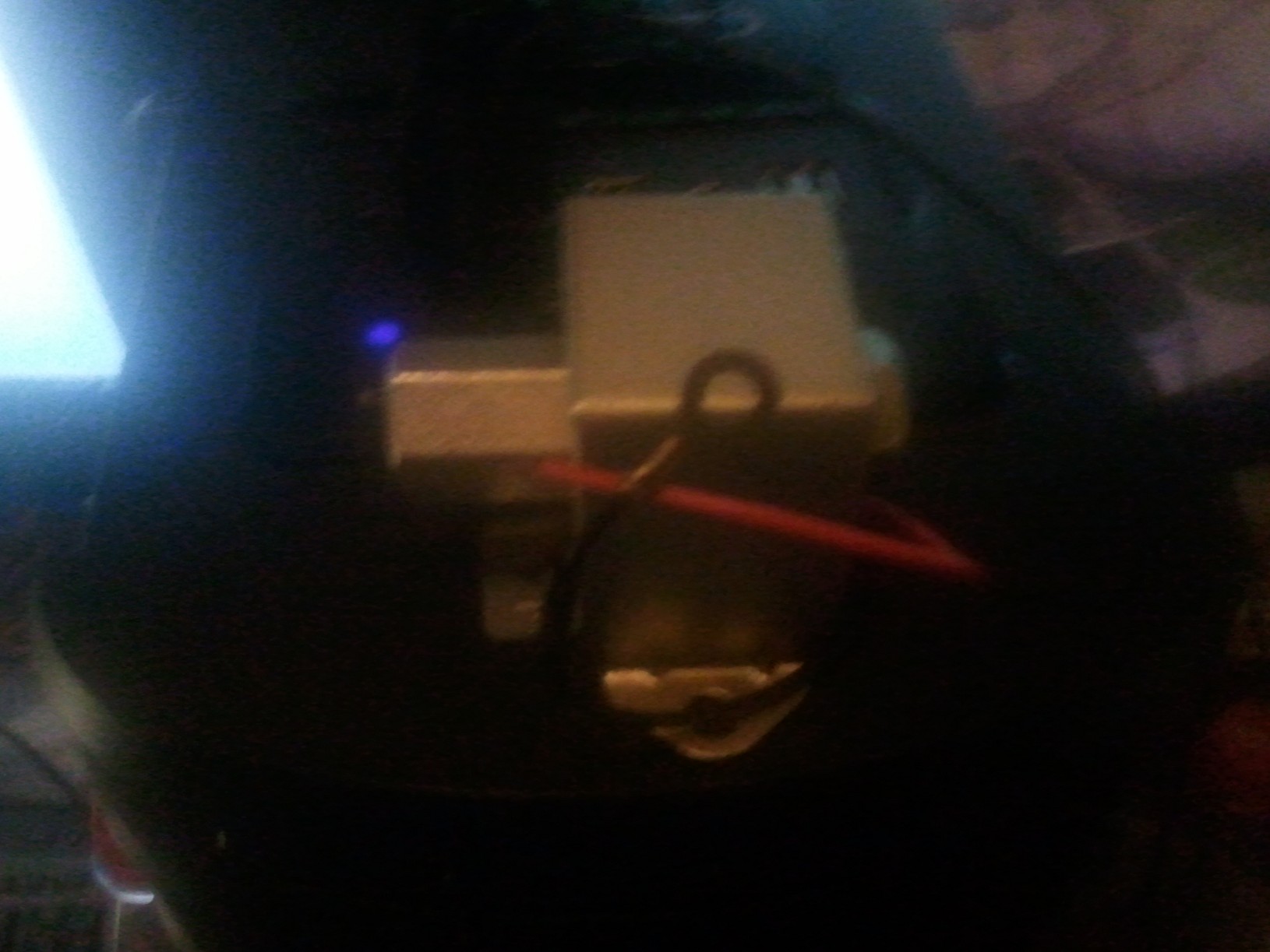

build some type of chain oiler as well,
Yes I have a small 12v fuel pump and a needle valve which is scheduled for the purpose

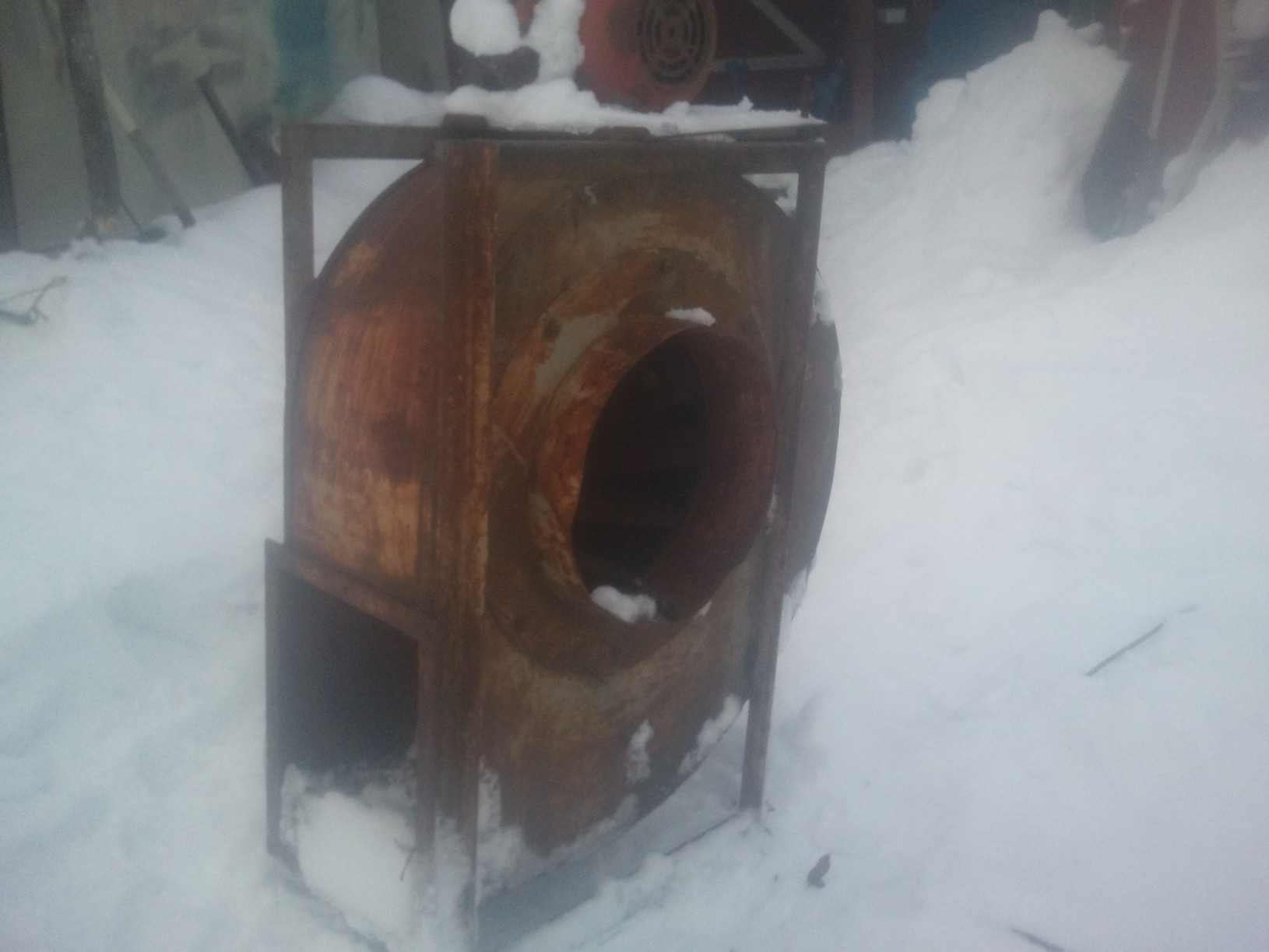

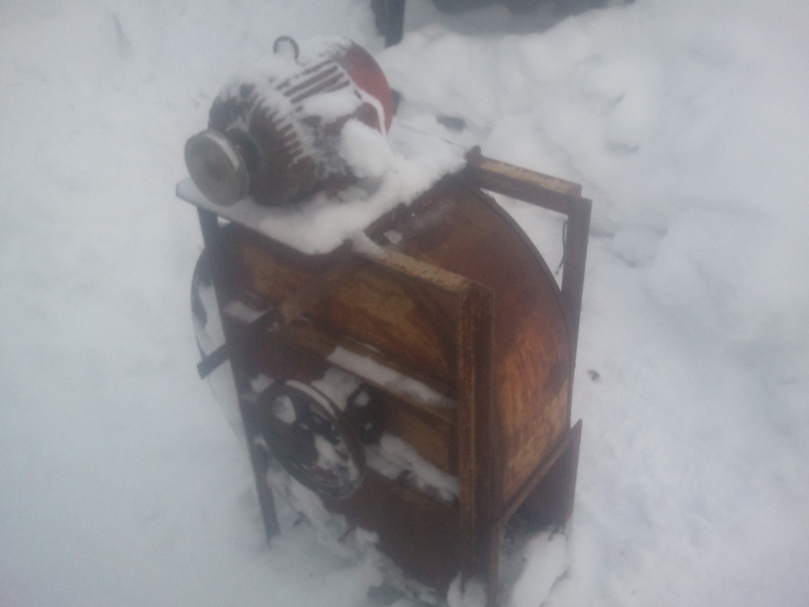

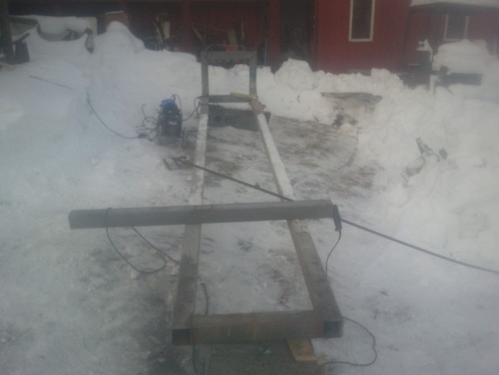

Has been started on the frame and found most of the steel I need after standing 3-4 hours shoveling snow, has about 15 "of the white c#@% lying on the ground. I have also found a chip blower for the project. More pictures coming soon
/ Firewood prosessor
#20

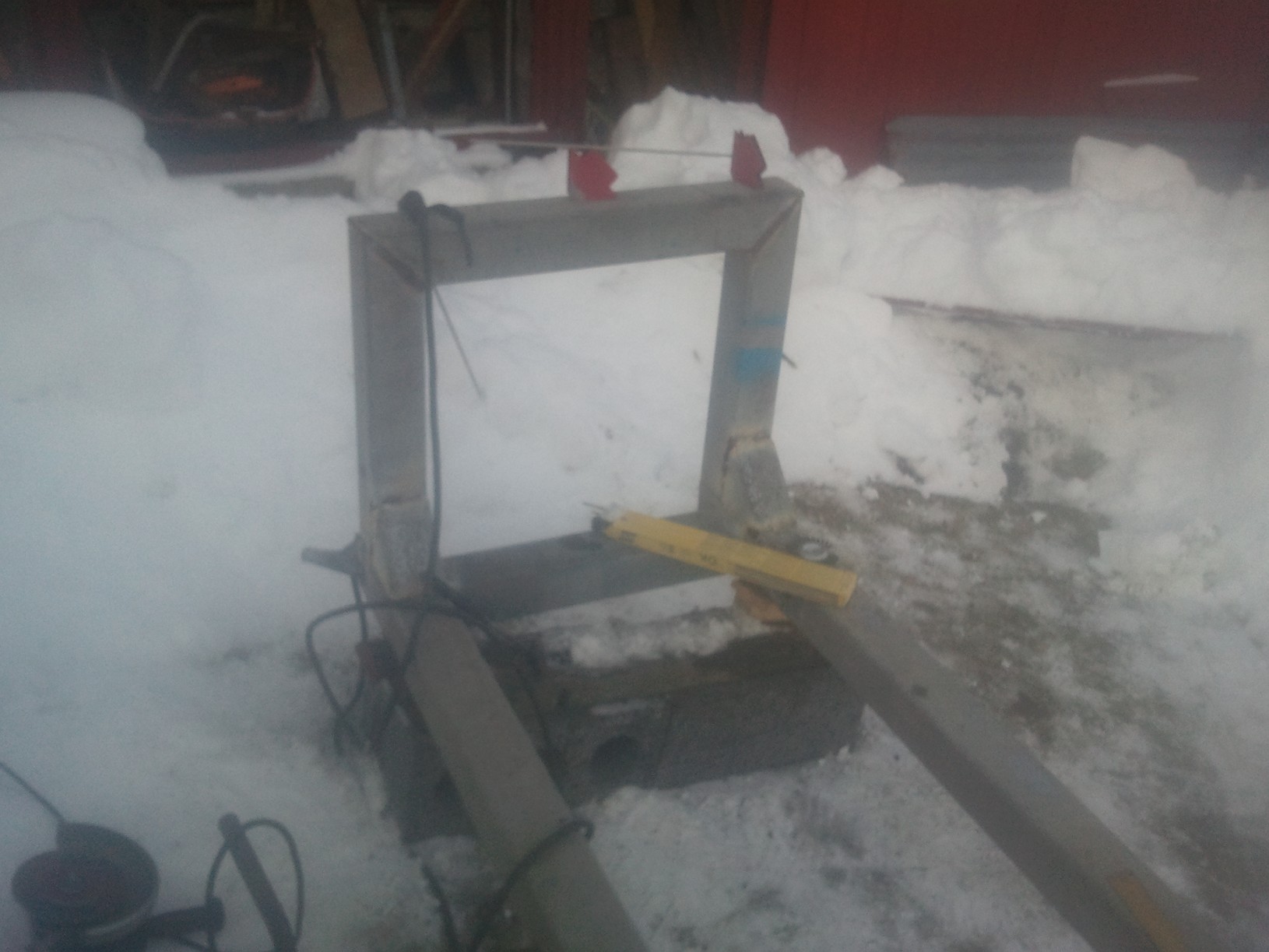

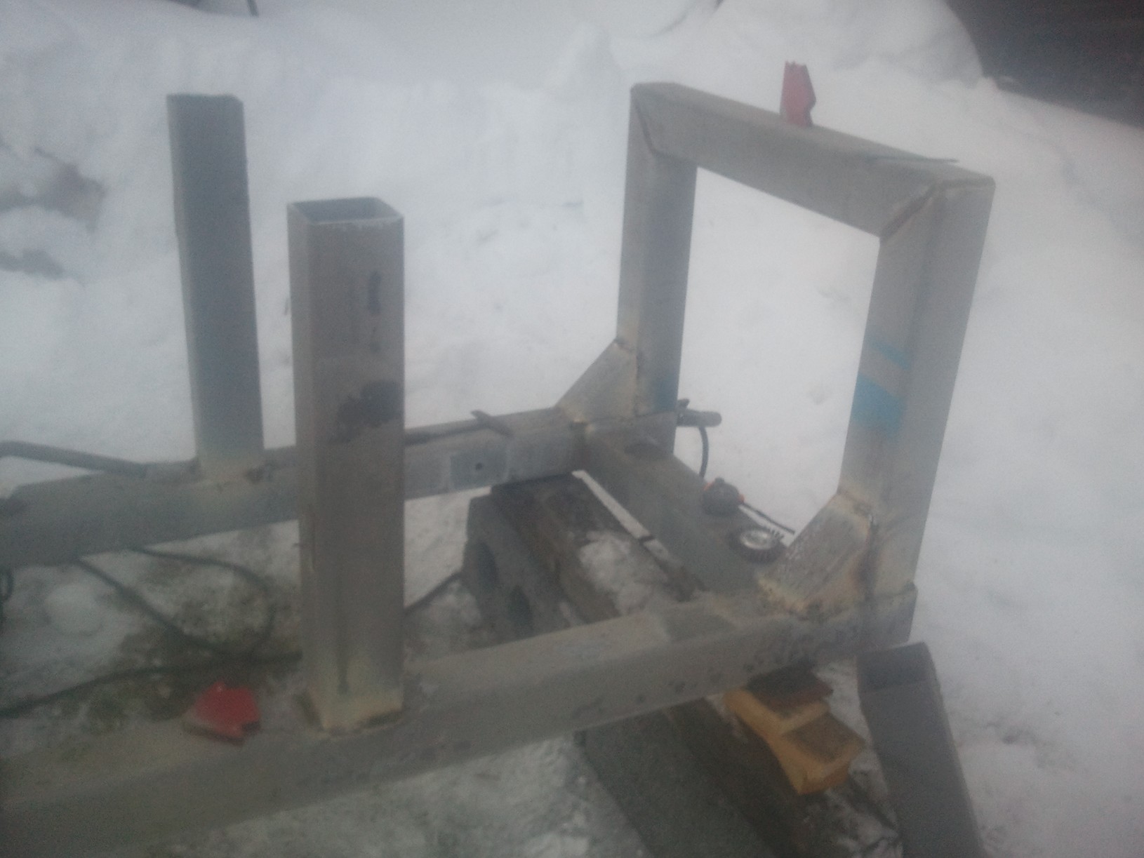

Ok, have begun welding the frame but it's been slow progress since I had to get my dad to the hospital in a hurry.
He began to cough up blood and get a few shades bluer.:( Fortunately, it looks like he is out of danger now.:thumbsup: But back to the firewood processor, here are some pictures of the frame. Also sends a picture of the old firewood processor I replacing
