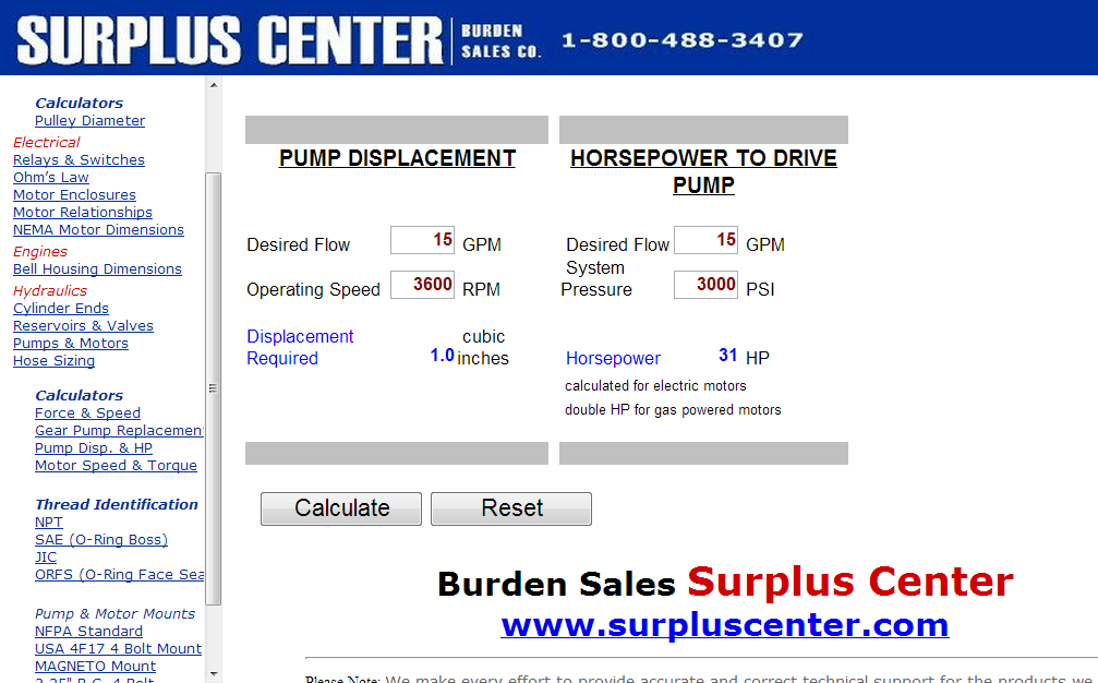

/ Firewood Processor #8
I got 16.5 GPM at 2000 psi using the 23 HP.
To get 15 GPM from a 3600 rpm engine, you have to have a 1 cu in displacement pump.
So to pump those GPM's, 15 , at 3000, you need
You select a pump based on the GPM/cu in displacement, at a certain rpm.
Any pressure developed from the pump is based on the load which will produce pressure, and with a potential to go as high as pump pressure at say 3000 psi.
You can limit the pressure by adjusting the relief valve to say 2000 psi.
At that pressure, you will not be using the 23 HP, maybe 21 HP
The volume and pressure potential will be based on the pump you have.
Do you have the pump now, and if so, I can tell you the HP required to turn the pump at a certain pressure ..
This pump is .98 cu in, and can develop pressure up to 2900 continious, and a 3000 rpm limit

This formulas might assist:-
H.P. to drive a pump:- H.P.= (flow, Gallons per min x pressure, psi) divided by1714
You can see that the power consumed is a product of both the FLOW and the PRESSURE. Use this formula to establish if a given flow and pressure is ok with your motor, or use it to establish what pressure you can achieve with your motor at a given flow. The flow is always a result of the pumps flow per revolution x the revolutions, ie a 1 cu inch/ rev pump will pump 3500 cu inches @ 3500 RPM
Your motor will probably drop revs a little under load so I would work on about 3500 RPM at full throttle or less. These revs are getting up there (for a pump) but should be Ok with a small pump(check the maximum revs for your intended pump). If you motor exceeds the recommended RPM, or you wish to use a larger displacement pump at slower revs, you might have to use a vee belt drive, and drive the pump slower.
Keep us posted on your progress, and good luck!
P.S we use metrics in New Zealand so I use a metric formula.... H.P. = (litres/min x bar) divided by 600 = Kw (1 H.P. = 3/4 Kw) (PSI divided by14.5 = BAR)
