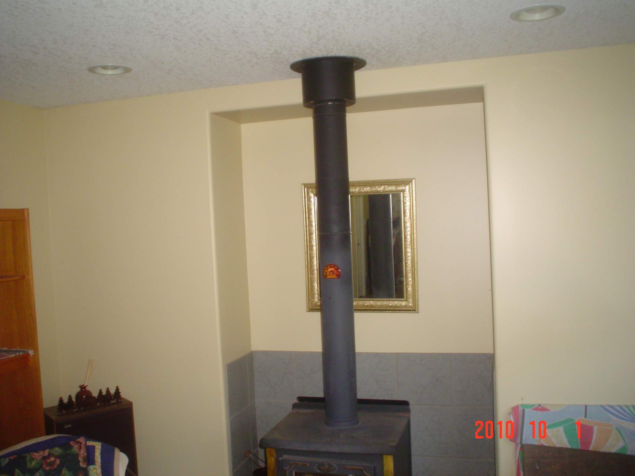

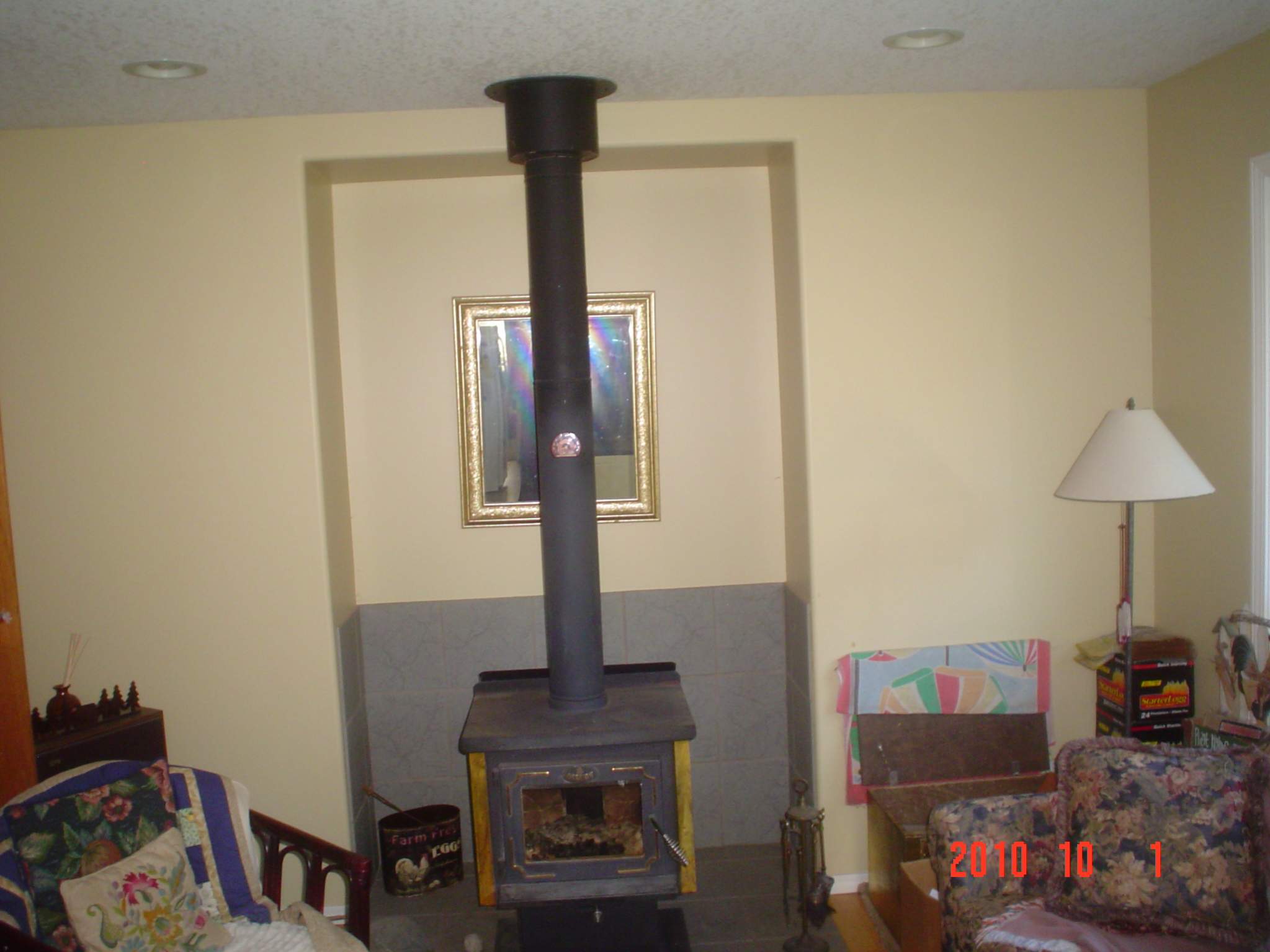

Here's a picture of my firewood stack. It is about 5-6 cords and only takes up 10' in diameter area. :thumbsup:

Moss - that's a pretty neat looking stack. How tall is it? Do you cover it or let the rain filter down thru it?
What's in the middle.....a donut hole??!

8'. Top covered with tarp. Sides open for air circulation. Solid wood all the way through. Ground sprayed with bug spray. First few courses sprayed with bug spray. Once a month spray around the edge with bug spray. Did I mention bug spray? :laughing:
Carpenter ants are the biggest problem around here. Industrious little critters, for sure.
