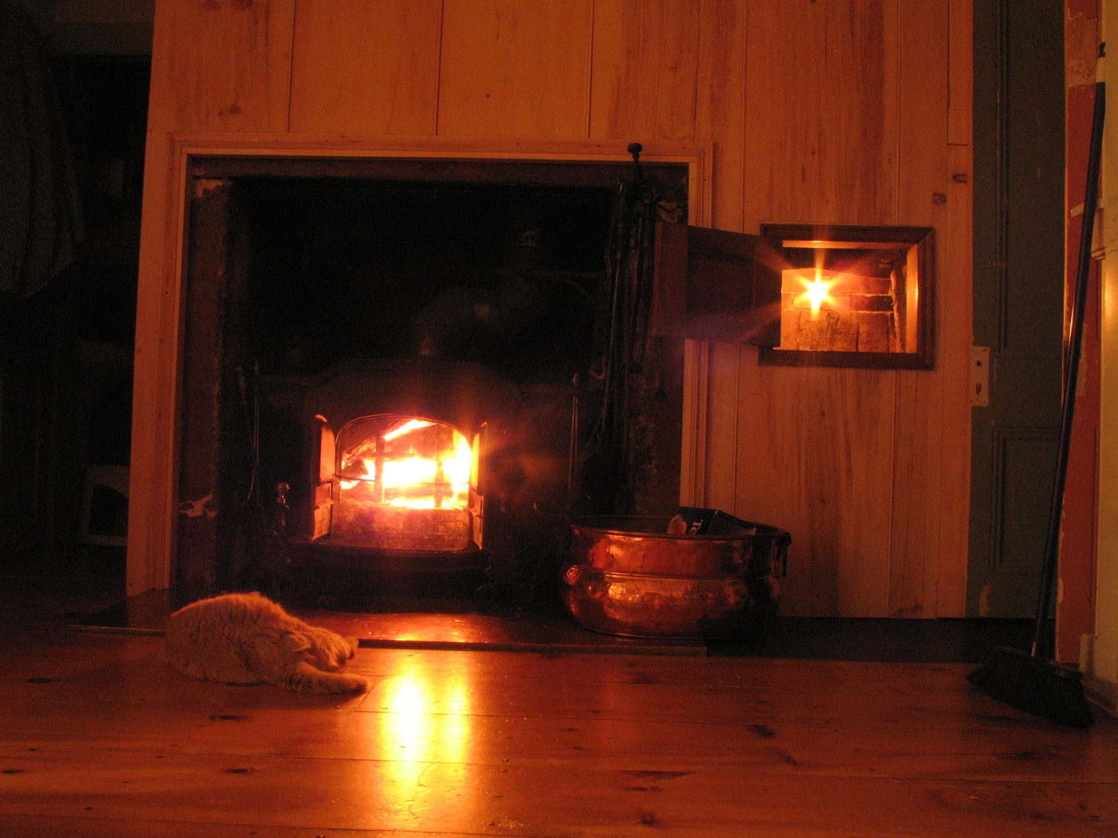

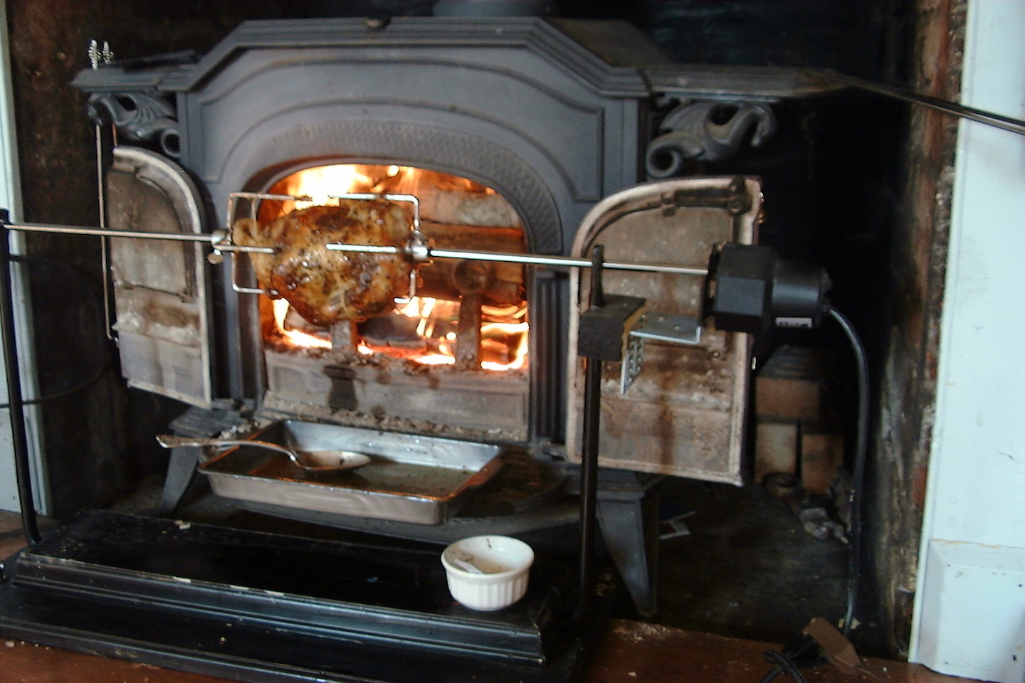

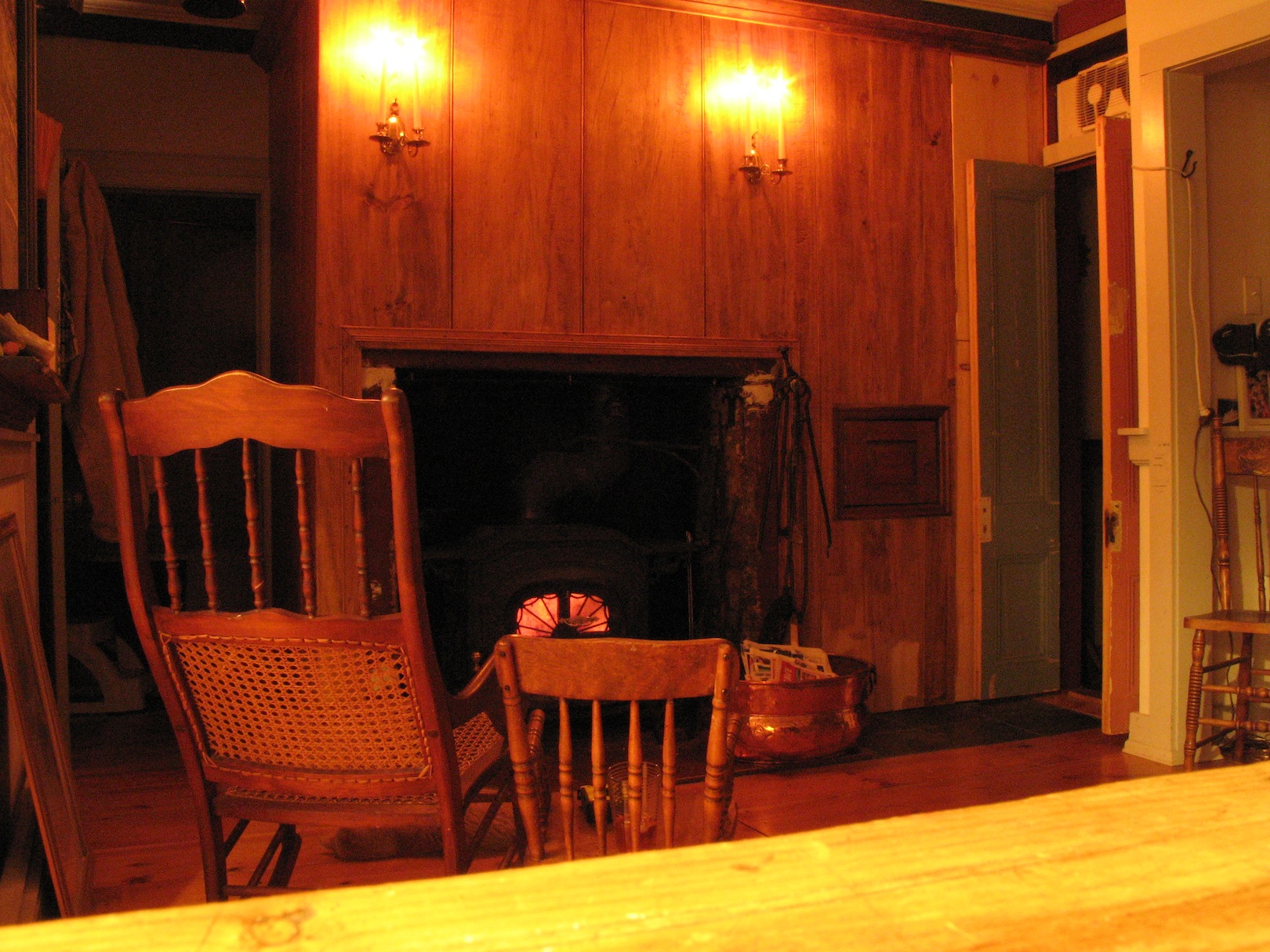

I have a wood stove in my shop and one in our house. A few things that you should watch for, other may have already suggested this.
Size the stove to the house. If possible try to have the chimney go straight out of the roof. If you can it will probably have a better draught, less chance to creosote up the chimney and the chimney will be easier (usually) to clean. Make sure you have enough clearance from the walls and you may have to put something under the stove like brick or tile. Check with the building inspector as what the requirements are. Improperly installed it may void you house insurance if you should have a fire due to the wood stove. Always burn dry wood, ours it at least 3 years old, I have a 5 year supply cut,split and stacked under cover. :)
/ Fireplace advice, Part 2 #5
Can't go wrong with Vermont Casting, Jotul or Pacific Energy.
Ditto Egon. Look at BTU's and sq ft per stove. If the stove is too small for overall house size you will burn it out quickly. If it is too large you may create a possible house fire scenario
by under burning and creating a creosote build up.
Look at attachable shelves, possible cooking area etc. Take advantage of the heat source. Nothing like coming in after a long day of felling trees, bucking wood and splitting, to settled down to a stew cooked in a cast iron pot over a wood stove or a big 'ol pot of beans!
Make sure you wood is at least 2 years old and buy a stove pipe thermometer. Also a metal ash can with top and always empty it far away from your house. Keep a fire extinguisher close at hand as well.
I 'sweep' my own chimney twice a year. Once before fall start up and once during the winter.
I usually get less than a pint of ash and that amount of the ash comes from the top 3-6 feet of the pipe.
Keep us posted and have fun... nothing like a wood fire!
