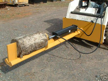

I looked at those units at NH. I don't care much for the design. They had the Powerhorse splitters on display alongside this machine, which made them look like toys. As to their functions, there is no auto return valve, so you have to place logs from both ends of the machine, or run the wedge back manually. They only handle 19" logs, which may be all you need, but the majority of splitters seemed to be designed for something a little bigger.
You would hook the unit up to the PTO QDs. You probably would not have to run the PT at full throttle.

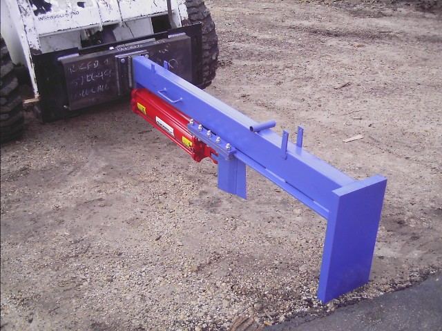

Here are a few.
I saw one like these bolted on to the rear wheel of a truck about 60 years ago.
My dad and I had one of these - exactly like the "STICKLER" in the picture - and used it a lot. I still have it in the back of one of the barns - I don't (and wouldn't) use it today, but it's great to show people and see the look on their face when I tell them what it does. We were always a little impatient - the idea was to let the truck idle and let the screw work its way through the log. Dad had me sit in the truck and goose the throttle a little to make the thing split faster. Picked the truck up one day and almost set it off the jack stand when we hit an extra tough log. Ahhhh, those were the days...

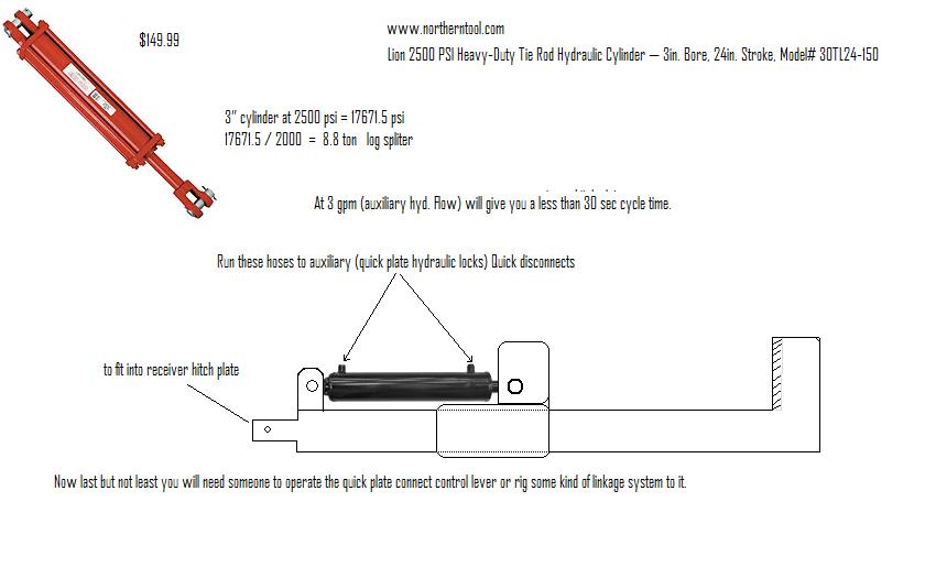

Just an idea for a cheap log splitter that might do for lighter splitting. It would have more power than the screw types that I have seen.
Using those figures. That makes that shaft size 1 in, and that is not a good thing. Bare minimums at best.

Well there JJ. Explain that so these good people will know what you mean. It might be they can fugure it out but i can't.
/ fire wood splitter #29
I think he's saying you need a larger cylinder as one with a 1" shaft is kind of tiny and could bend under that kind of load. And, if you increase the shaft size, your cycle time will slow down.
/ fire wood splitter #30
Now this is starting to get plum silly. Bigger shaft= stronger cylinder yes but, shorter cycle time. Cause less area to fill on the return stroke. I can fill this going on and on so I will just say that my post was much more for an example than it was a blue print. I should have written a disclaimer.
No, I was not trying to embarrass anyone, but to show that the cylinder chosen is not a good choice. A 2 in shaft has much better advantage if you have any potential bending forces. I had to calculate back-wards to find the shaft size, because it was not stated. I used trial and error. You could even use the same cylinder bore and change out the shaft and still have the same push force. The difference would show up in the return stroke. You might get by with that same cylinder for a while, but one day it will come into that big knot, and bend the shaft.
As an illustration your diagram is fine. It looks similar to this commercial model.

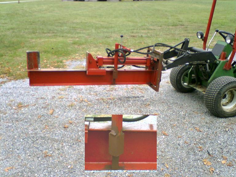

/ fire wood splitter #34

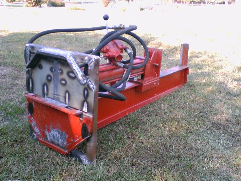

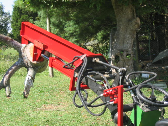

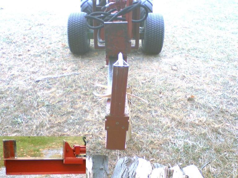

Yes when I first built the upside down splitter it didn稚 take long to see that it was only handy on splitting and moving the large cuts. That痴 when the upright feature was added. Still haven稚 fixed the frame where I bent it but by not treating it so rough it hasn稚 gotten any worse. It is on my to do list though.
I can't turn mine side ways. Never thought about that when building it. But so far we have been able to make do without that feature.
