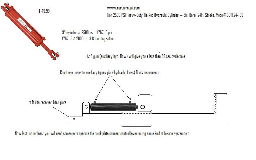

Yes, that's true regarding the log-splitter. But, with the PT-425 I'm putting hours on a $2,000 25HP engine when essentially the same job could be done by a 5-8 HP $400-500 engine. The PT-425 only outputs about 8 hydraulic HP, perhaps 10 HP max (with no load on anything else, sitting stationary), while running a 25HP engine at full-throttle...
WIth a long-splitter you likely wouldn't need full throttle, but stil...
You are also putting hours on those pumps, too, including the tram pump, even if the machine is stationary. I need a log splitter and have been thinking about a 3PH version, but the more I think about it, the more I think that stand-alone is the way to go.

I'll agree that you guys make some good points. I just don't want yet another engine to maintain, filter to change, tires to inflate or hitch to have to hook up (splitter typically have the ball hitch, don't they?). With a splitter as a PT attachment, I wouldn't have as much maintenance to do, I think. And it would be easier to move around with a quick attach. Of course, we could cut off the ball hitch and put on the PT quick attach. Or use the ball hitch attachment that many of us have made for out PTs, I suppose.

Snowridge, you make a very good point but individual needs differ on what to do with the life of their machines. If I use my splitter say 10 hrs a year then no problem. If I were to use it 100 hours then I would want a separate engine and would add a pump and engine to mine. Or if I already had a self powered splitter I would never have built the PT one.
