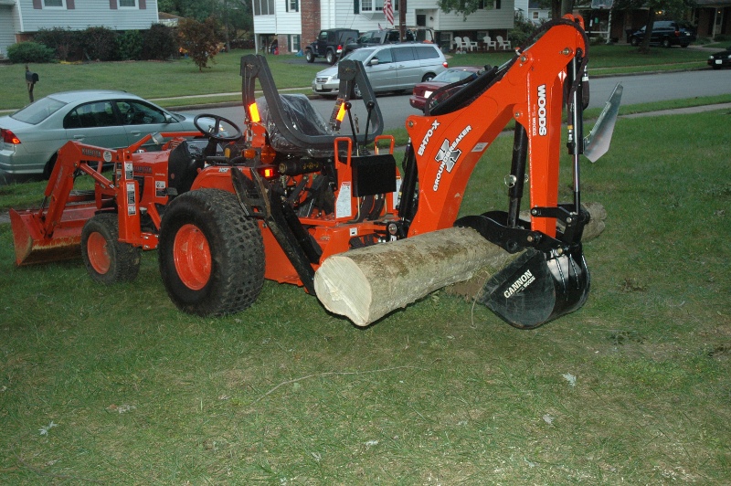

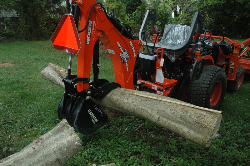

I don't burn much wood, but my favorite method of moving it is just pick it up.
