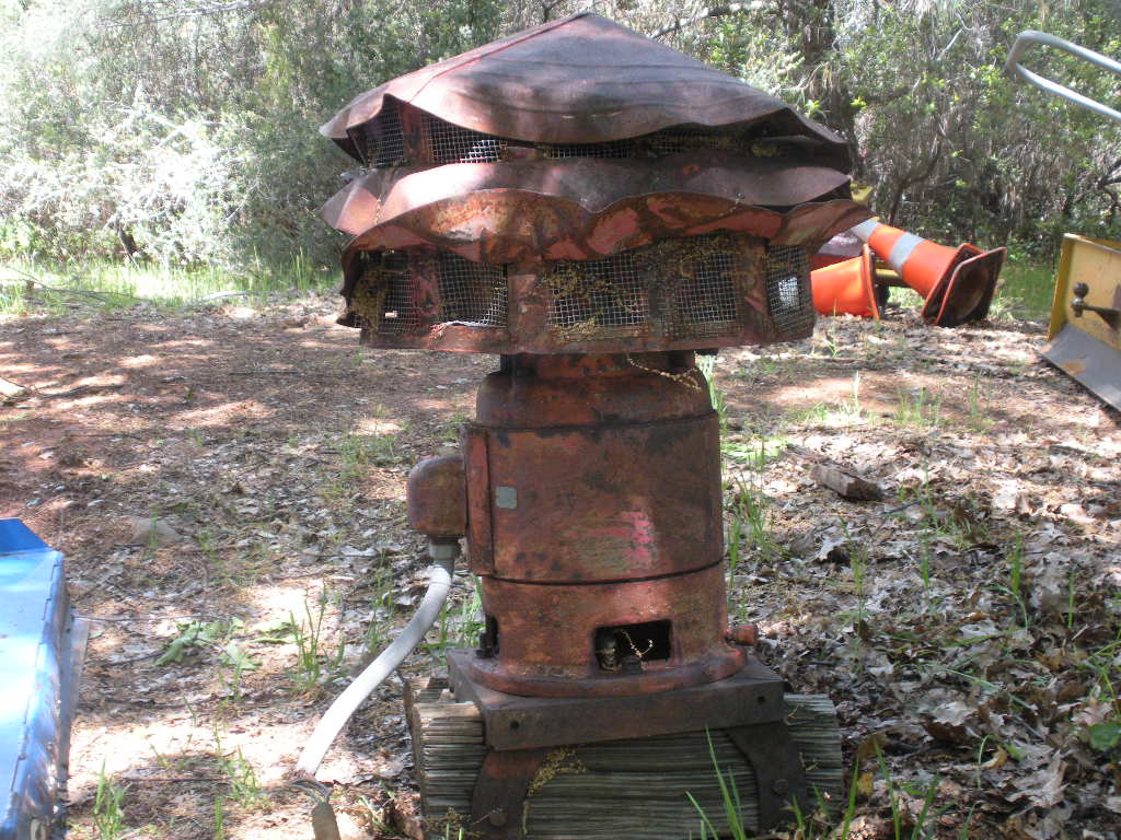

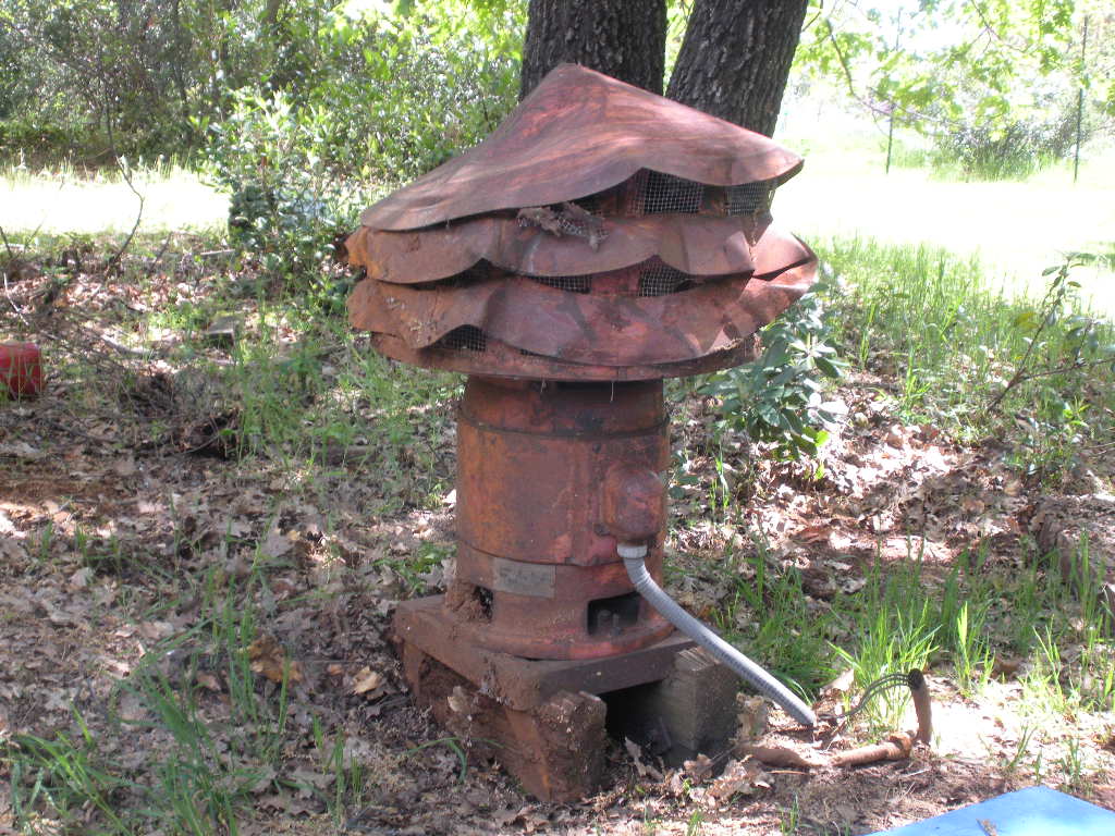

I am looking for information on an old siren. Our firehouse was just torn down to make way for the new one. Behind the station was an old Federal siren, from back when our station was an all volunteer outfit; Our district is a mixed paid/volunteer now.
This thing has sat for years; I have been there 11, and it was sitting out behind the station before I started volunteering.

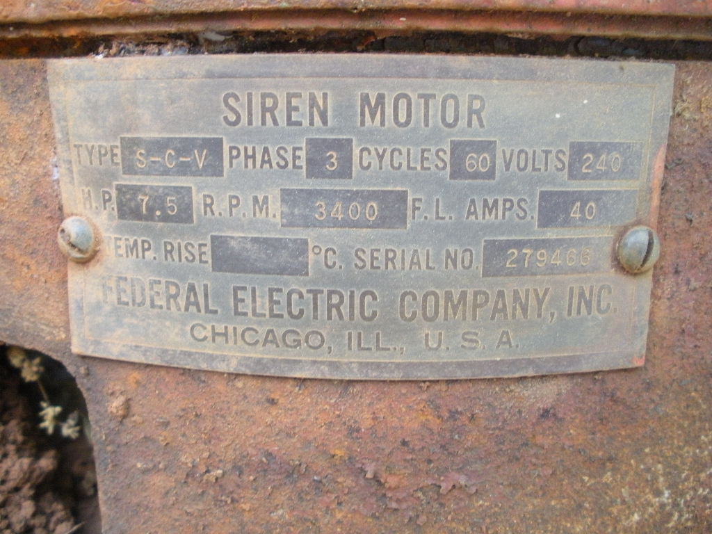

A "Google" search turns up only a little info. Looks like it may be a Federal "5" or "7".
The siren has a tag on it, Federal Electric Company, Model S-C-V. 7.5 amp 240V. It is marked as 3-phase, but to my knowledge our station never had 3-phase power.
The top cover is beat up. I have not tried to remove any covers or see if the motor turns yet.
I'd like to clean it up and try to see if it will spin up. Not sure what I would do with it after that; our district has no interest in putting it up after the station is rebuilt. And, I do not know if there would be an issue firing it up. None of the districts around here use a siren any more. Everyone has been on pagers for years.

Sounds like the sire we used to use in my town. No pun inteneded. See if you can get in touch withe a local electrician, and he should be able to figure out the actual phases.
If I remember corretly, you can run a three phase appliance with just two legs, but you won't get the full "power" of the appliance.

This brings back memories before we got pagers. Our old fire house had a siren like you describe on a tower behind the building. It was a 3 phase/ 240Volt. The three phase power only went from the service to a contactor box on the wall then up to the siren. No other 3 phase equipment in the place. The lights in the building and the street lights in front of the fire house would dim when you started it up.

You can't start a 3 phase motor off of two phases unless you use a phase converter.

Here are three pictures. The sheet metal took a beating. It had just been laying kinda on its side behind the station for ages.

They might have a phase converter to power it or picked up from some were else going to use it and found it was 3 phase.
Straighten sheet metal out put a pipe through the middle paint her red and it would make a unique mail box post.
