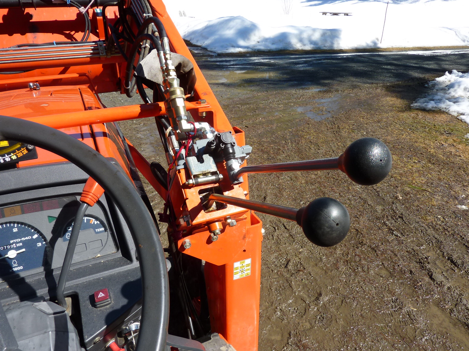

Finished My 3rd Function Valve Install

It seems the prevailing wisdom is that a "true" 3rd function is better solution than some others, such as running off your rear remotes, because you can can perform three functions simultaneously with your right hand on the loader lever (e.g., raise/lower, curl, and close a grapple).
I ended up taking that advice and just installed the Kubota 3rd function kit on my 5240. I saved a ton of money installing it myself, but it was not an insignificant undertaking.

It seems the prevailing wisdom is that a "true" 3rd function is better solution than some others, such as running off your rear remotes, because you can can perform three functions simultaneously with your right hand on the loader lever (e.g., raise/lower, curl, and close a grapple).I ended up taking that advice and just installed the Kubota 3rd function kit on my 5240. I saved a ton of money installing it myself, but it was not an insignificant undertaking.
Even after one weekend, I can see the grapple will result in a quantum leap in productivity, given that I have lots of rocks, trees, stumps, and brush.

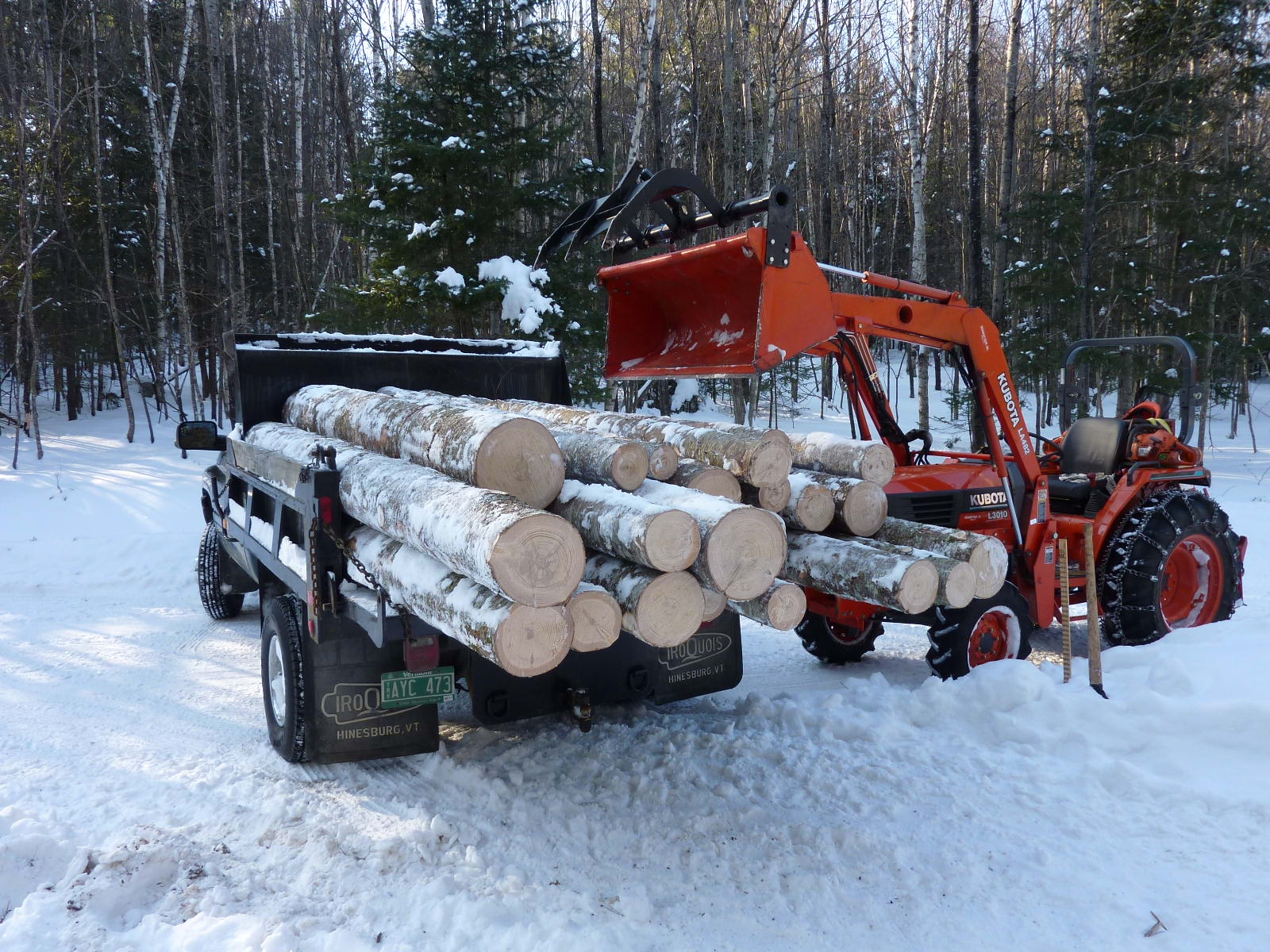

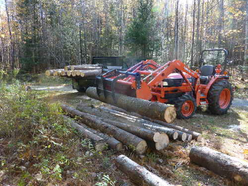

I'm not sure what you mean by this but I guess it is a compliment so thanks. I agree that using the rear remote lever down by my thigh was awkward at times. Now I can operate both levers simultainiously with one hand which is much better for me. And I can run the grapple at the same time as any of the bucket motions. I find this almost necessary when trying to pick one particular log out of a pile. The grapple valve has full feathering control too which I like. No switch to choose between functions to confuse me. I am not sure if you would call it a "true" third function or not but I guess I would because I have all three all the time.
