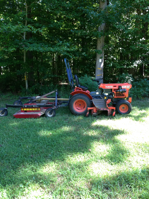

I have a Howse finish mower that was new, but had set on a dealers lot for a few years. I paid $750 for it. It's a good heavy duty mower with a 7 gauge deck. On level ground it will provide the best cut of any mower I have. You have plenty of power for a wider mower, but since you said it had plenty of humps and low places I would stick with a 72". My L3240 has enough power to smoke the belts when you try to use it as a bush hog. In normal grass it hardly knows it's back there. My B7100 will run it but not very good.
