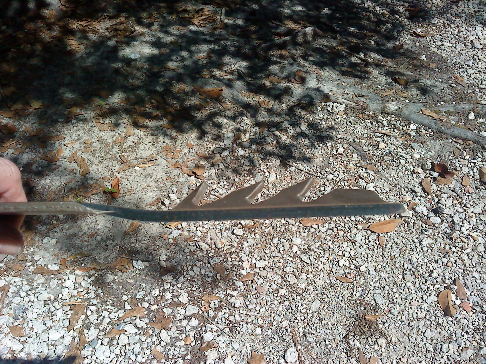

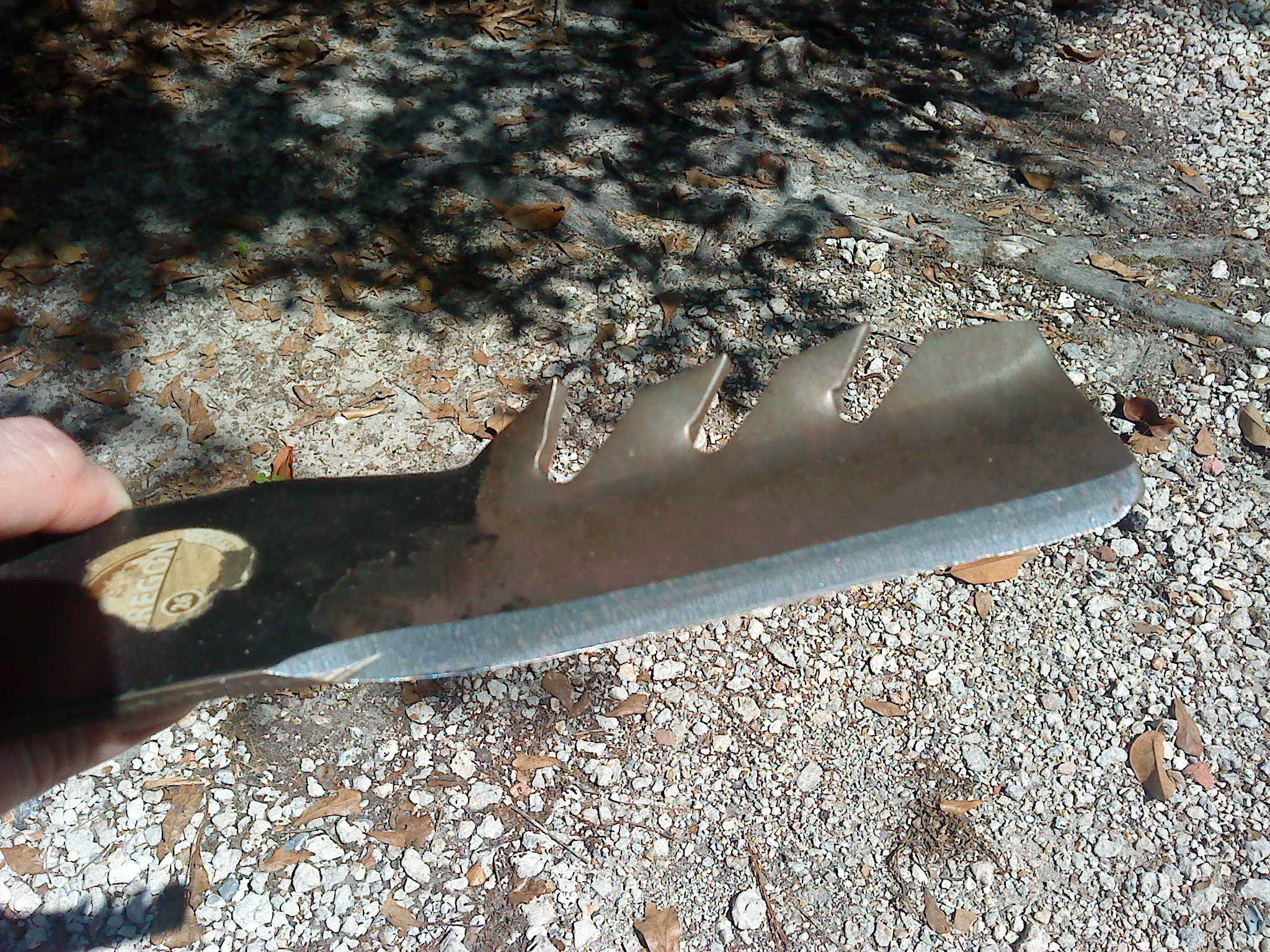

Also wanted to note those gator blades are very thick. 1/4" steel. You could try those some time and just cut off half the height of the teeth. Keep us posted.

Here is a couple pics of gator blades.

I flattened three blades and installed them on my exmark walk behind. The difference was very noticeable....lower noise and very very little dust. However, I noticed it was missing a lot of grass blades. I am thinking because they were flat there ws no lift and the cut of the lawn suffered. I immediately went back to my gator blades.
