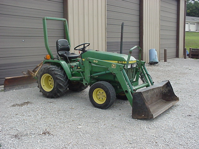

So I ended up with a JD 670, 4x4, 900 hours, no leaks, Loader, blade, belly mower, Tiller for $7000. An Older case 235 I looked at was $5500 with loader and nothing else. Grey market Yanmar w/ loader was $6500. So for what my choices were, I think my safest bet was the 670. Even if I don't like it, I don't believe it will be hard to sell. But I felt very comfortable behind the controls.

Thats kinda what I was figuring. Don't loose much buying "Green" Grill has a little ding in it and headlight lens broke. Other than that, visually in nice shape and seems to run better that the 2 cyl. 650 I looked at for same price.

Its hard to find much in the way of a 4WD tractor and loader for less than what you paid....IMO. Probably will work out real good for you.
One area of concern tho is your tires. I see turfs on the front and R1's on the back. Make CERTAIN that the circumference of the turfs is the SAME as that of the ag tires that used to be on front. I'd operate in 2WD until you know that you are not putting stress due to tire size differences - a big "no-no" for 4WD.
I have turfs and R1's for the front of my 790 too. The circumference matches.....but still.......I use the R1's for all 4WD work and save the R1's if I don't want to tear up the lawn (and for spares).
