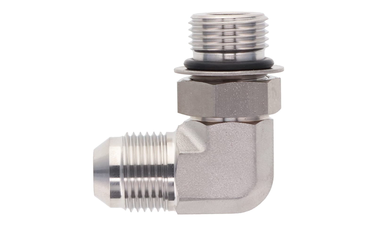

If you’ve cycled the cylinder(s) 6, 10, 12 times (w/e , pick a number) air is being introduced somewhere. Check tightness on all the hydraulic fittings and every o-ring seal (orfs, orb, q/d) becomes suspect. As an example,

thank you as i will check into the fittings and hoses for issues
Being a bit of a Debbie downer now. I’d start with the suspected cylinders and valves. Unfortunately, it could be on any part of the tractor. Last one I had, it was under the seat on the 3 point fittings
