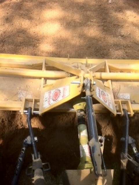

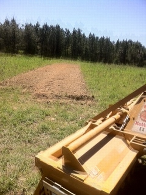

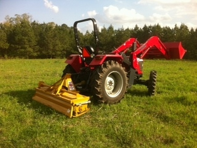

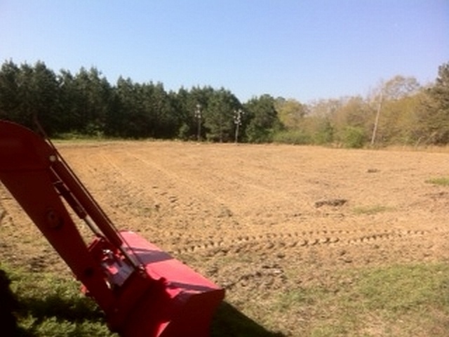

Here ya go. Doubled the pic size and halved the file size for ya.

thanks haywire that looks dang good

Thanks for posting your tiller purchase Lucky. I have been looking at that same tiller. It sure looks like it does a good job. What HP tractor are you running it with?

i have a 55 horse 4x4 it says it has 45 at the pto which is more than enough to turn that tiller it never bogged down one of the guys gardens i tilled was really hard packed clay it took a couple passes to bust it up right another thing that was a problem in that patch was there were small terraces that the shoes were riding on and the center of the tiller couldnt reach the dirt so i had to slow my speed and eat away at the terrace so the tiller would drop into the dip worked out pretty good i was running it in 1 low at 540 and it never skipped a beat even when i snatched up a 8 foot ground rod lol oh yeah it says it takes 100 ounces of 85 w 140 oil for the gear boxes so i bought 4 quarts so i would have some left over make sure you buy 6 quarts i had to make 2 30 minute trips to the store

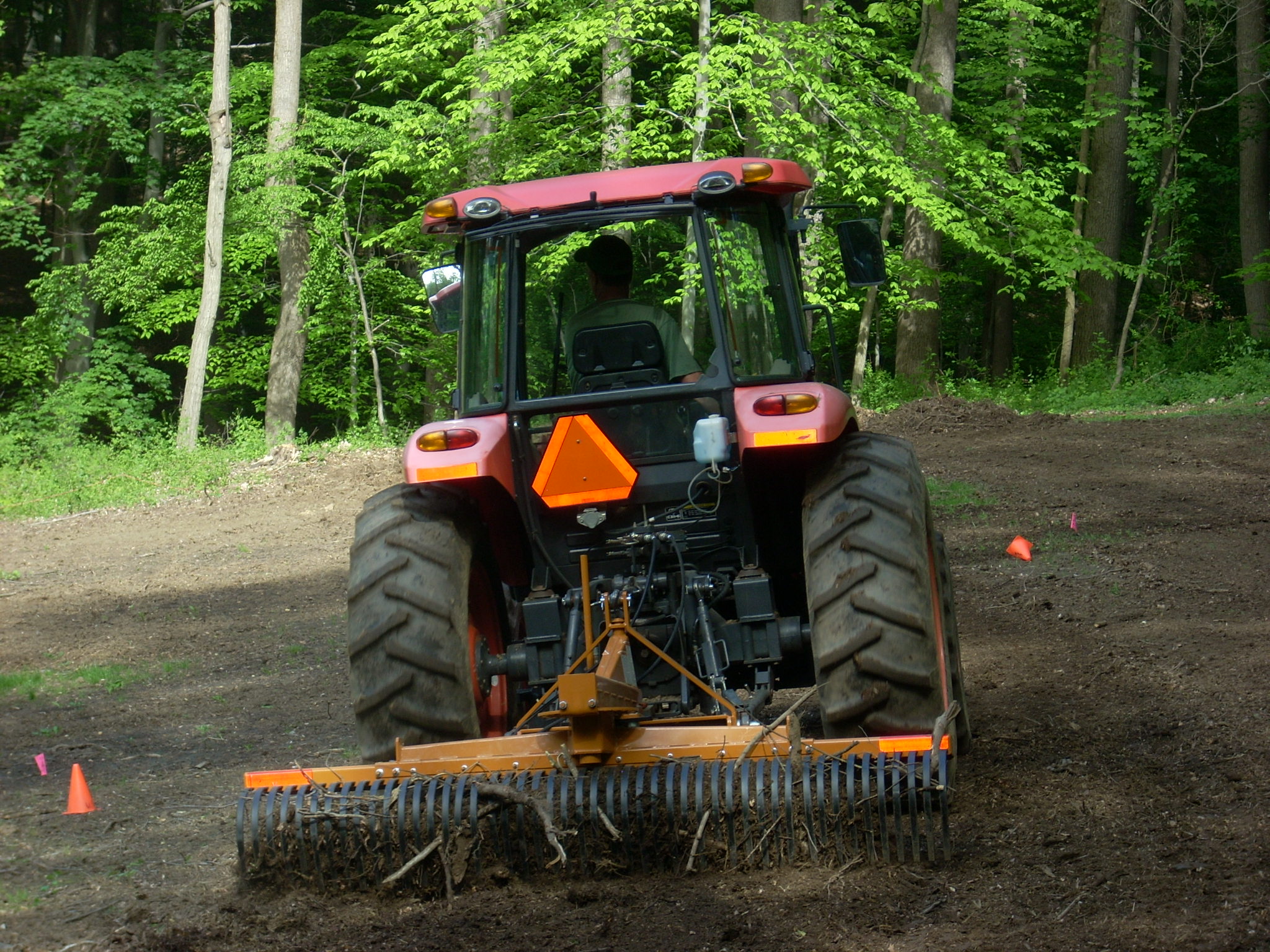

I just did one of those jobs for a customer. Here's the York Rake phase. Prior to that, I used a Harley rake to break up soil and get the rocks out.
