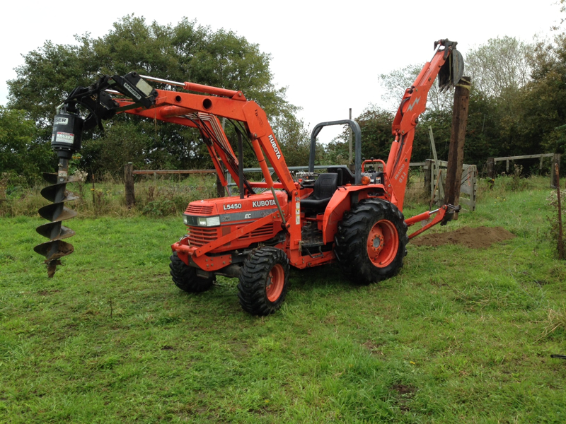

My L5450 is used more than I would have imaged when I bought it 3 years ago with 200 something hours. Very solid tractor. Replacing fence posts in the attached picture.
Tom looking at your tractor I was wondering what your hydraulic setup is. If you have any photos that would be great. I have a base line 5450 with the 1150 loader and I like the idea of the front hydraulics to run stuff out front.
/ Finally bought an L5450 #24
I set up a 3 spool valve above the right fender. I tapped in between the power beyond port of the FEL and where the line was that would go to either the 3 point or the backhoe. Then ran a line to the tank. I painted the spool body before it got moisture on it to prevent rust. Make sure you get a spool with a power beyond ability. A lot of people use a 3rd function setup but I like things simple and versatile.
