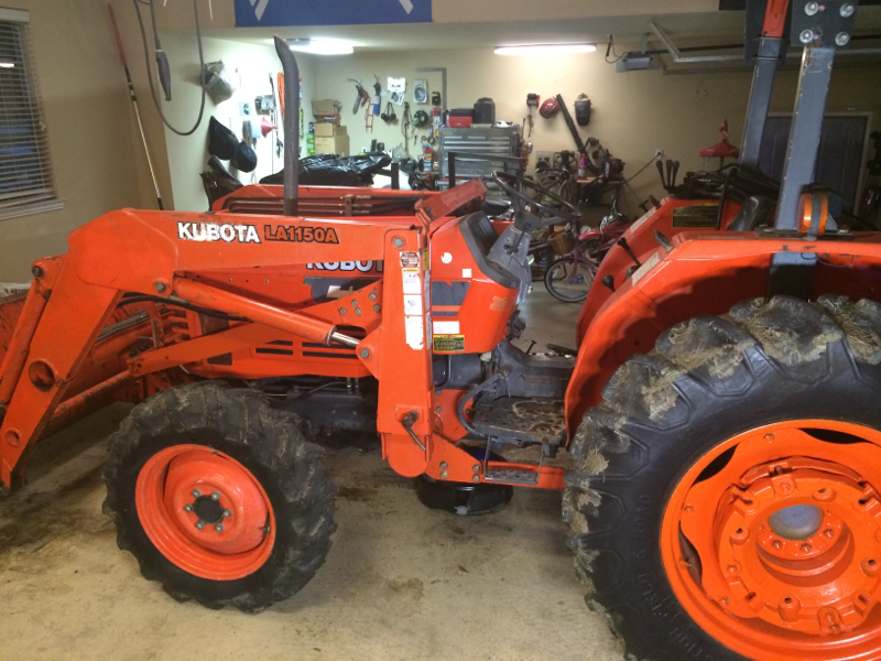

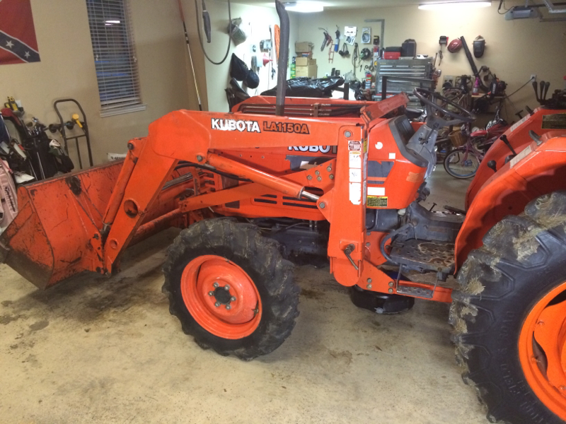

Here are a few pictures. I've got her in my garage changing oil, filter, and fuel filter. These are big machines!

/ Finally bought an L5450
My only true issue I'm having at this point is a minor fuel leak at the return line fitting, which I will tackle this weekend, and the 3pt hitch is not working properly. When holding a load elevated with the engine running, the hitch will hunt, or pulse up and down. This happens anytime the hitch has any load lifted off the ground. Also, the hitch drops or settles as soon as I turn the tractor off. It actually settles fairly quick, which is not a confidence inspiring situation. Any ideas as to what may be going on? I hope there's an adjustment somewhere that is not right that will fix these issues.
Thanks everyone!
Corey
/ Finally bought an L5450 #11
I would say that the o-ring on the 3-pt piston is worn out. Not that big of a deal to replace.
Brian
#12
Thanks for the reply Brian. I would like to tackle this myself, and have ordered a kubota wsm manual off of eBay for this tractor. I am noticing a few leaks in and around the left side linkage on the rear of the machine. Where do I find the actual piston and o-ring?
/ Finally bought an L5450 #13
Under the seat. There is a roundish cover with 6 bolts holding it on. The piston is under the cover. You'll want to take any implement off the 3-pt beforehand. After the cover is off I usually lift and lower the arms by hand several times and the rod on the rockshaft will push the piston out far enough to grab it by hand and pull it the rest of the way out. From there it's pretty obvious on replacing the o-ring.
