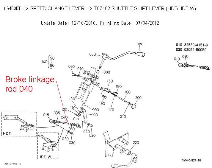

I finally broke a shift linkage rod by using too much force and am now in the process of figuring out why the Shift Lever on top of the Shuttle & Clutch valve requires so much force to move.

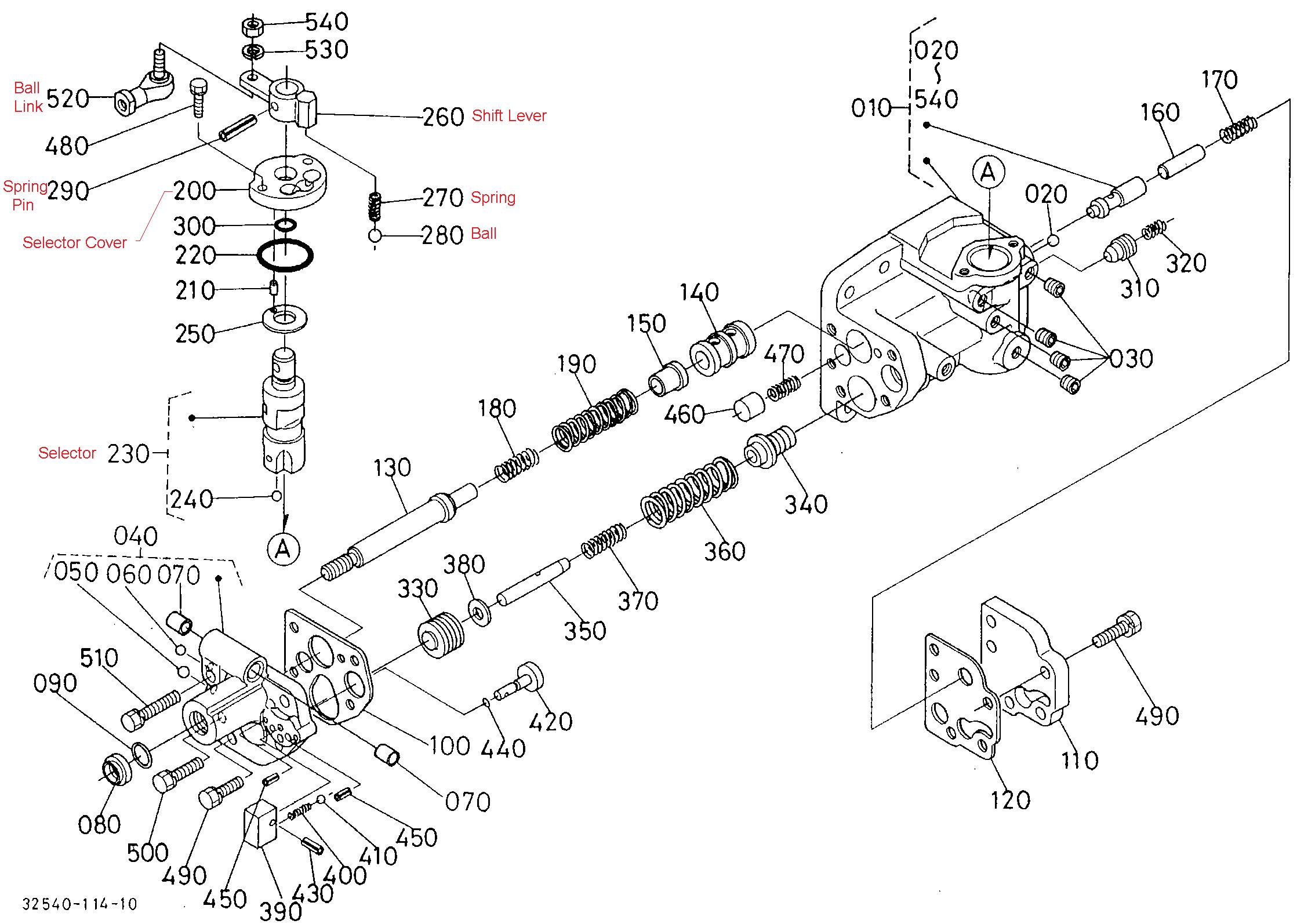

I removed the left fender and left step to expose the top of the Shuttle and Clutch Valve because I suspected that the spring loaded ball in the shift lever on top of the valve wasn't moving freely over the three detents in the Selector Cover. I haven't removed the Shift Lever because I wanted to check to see if I might be creating more problems by doing so. The WSM shows the procedure to remove the entire Shuttle & Clutch Valve but doesn't really indicate whether I can just remove the Shift Lever on top without removing the front and back covers on the Valve.
Has anyone else had this problem? Does anyone have any suggestions on what the real problem may be and how to approach fixing it?
I've attached a photo I took of the top of the Shuttle and Clutch Valve showing the Shift Lever and detents in the top of the Selector Cover. I also see that the linkage rod connecting to the link ball on the Shift Lever is slightly bent as shown in the picture.

I have two thoughts:
1) Maybe the ball has worn to an odd shape, and when it is randomly oriented a certain way makes it difficult to shift.
2) Crud has gotten past the ball and up into the spring area, making it difficult to compress the spring (but I don't think that would be an intermittent problem).
Try unscrewing that hex plug and examining the spring and ball.

I have had similar problem on other kubota's that have the exposed ball and spring. Lube it up and replace the rod it will be fine.

It looks like I ought to be able to tap the spring pin (Part 290) out which holds the Shift lever (Part 260) to the Selector (Part 230) and lift off the Shift Lever to expose the ball and spring. Can I without screwing some setting, alignment or tolerance up?
   / L5450 HDT-W Broke Shuttle Shift Linkage Rod #7
Drive out the "roll pin". That should allow you to remove the whole affair and see the spring and ball. I don't have experience with your machine, but I'm quite certain you won't screw up any setting or alignment by doing this. Go for it. I still think you'll find that the ball has been worn to a non-spherical shape.
If you do indeed need to replace the ball, measure the original diameter as best you can and then search online. "Bearings Incorporated" has a local outlet here and has saved me a lot of money several times with various bearings.
   / L5450 HDT-W Broke Shuttle Shift Linkage Rod #8
I think you're on the right track - take out the roll pin and lift off the detent. The pin may be a little stuck with paint but you won't hurt anything by tapping it with a hammer and a drift that's slightly smaller than the pin.
With the detent removed check that the valve turns smoothly. It's unlikely there's anything wrong in there but it should be checked.
Smooth up any ridges on the detent ball, clean the sockets and spring, put back togeter loaded up with water-resistant grease. Check & lube all the other linkage pivots too - they can get dry and stiff. The whole shuttle/EC valve linkage should have light touch.
Good luck - and let us know how it turns out. Take care, Dick B

Bumping this old thread. I ran into this problem with my L5450 and all it turned out to be was lubrication needed on the valve shown in the picture of the original post. The three detents on the right side of the picture (two you see and one under the lever arm) have a ball and spring arrangement that holds the position that gets dry. I could not get my floorboard off so I puffed some graphite dust into it by reaching in there. The shifting is like new now, very smooth. For the last few years I had been getting a little worried that the old girl was having larger issues as the sticking became worse, but not the case. Good to go.
On the floorboard, there were three 12 mm bolts to the rear left fender, one larger bolt with a square nut holder up front to the left of the clutch, one stud and one bolt with rubber washer, collar and wire holder, two springs on the clutch and one strap down to the valving that I removed. But something else was holding it on. Could not figure it out so I lubed it by reaching in there. I really wanted to get in and go over all the linkage.
